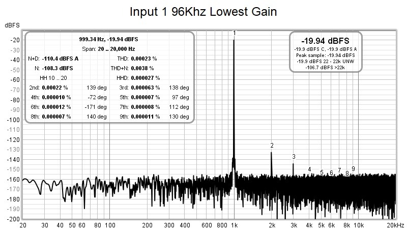

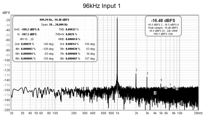

With a Focusrite Scarlett 4i4 Gen 3, REW, and a few oscillators, I found that the displayed phase of the harmonic distortion varies with the physical input used on the Focusrite. In my observations, inputs 1 and 2 display similarly. Inputs 3 and 4 display similarly. Group 1&2 vs group 3&4 display differently. When using input 1, the gain was adjusted to minimum and also set to match the level of input 3. This was done to check if the amplifier/attenuation in the Focusrite was altering the phase. It doesn't seem to have an effect. I haven't the foggiest, which is correct/accurate. I do know if I blindly trusted the numbers displayed that I'd draw incorrect conclusions in one or both situations. Until I find a way to run a known control... I won't know.
YMMV... As clearly demonstrated, I am new to all of this, but if you happen to be using a Focusrite with both front and rear inputs, you may want to check your measurements.
Two examples from the ShibaSoku oscillator at 1kHz 1Vrms output. Gain of input 1 adjusted and unadjusted. Input 3. All "line" inputs. All TRS input.
As I learn more about timing / sampling of a continuously varying analog signal... I assume that the phase is calculated by the relative voltage at the same "instant", but again... I haven't a clue. I changed sampling frequency to see if that had an effect. It did not as far as I could tell.
Note - just to be absolutely certain, I ran a calibration for both input 1 and input 3. Measurements were taken with Input 1 calibrated and Input 3 calibrated. No meaningful difference. Pics attached were from Input 1 calibrated.
I still may have done something totally incorrectly. My goal is to be able to produce repeatable and hopefully accurate measurements. Repeatability has improved significantly to the point where n=2 is likely okay for many measurements for my purposes. Accuracy is nowhere near verified. I couldn't say with any confidence what the phase of the distortion relative to the fundamental is.

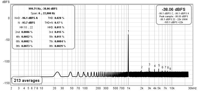

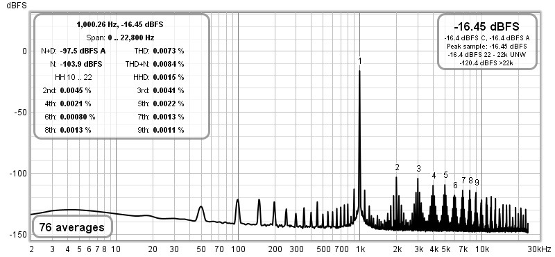

Hi All,
When using REW to test my DIY Class A mono block power amps I have noticed some anomolies.
I tested both amps in last few days and at 1.5 watts only 2nd & 3rd Harmonics were present. All other harmonics were below the noise floor in the -125 to -130db region.
However, when testing the same amps, unchanged, today with similar settings I am seeing various harmonics like 7th of 9th ( most undesirable ) at around -100db
I tried many different settings to no effect until I accidently changed the frequency to 1001hz. At this frequency all higher harmonics fell back down into the noise floor.
After trying various frequencies like 500 1k 2k 3k 4k 5k these harmonics like 7 & 9 are once again at a higher level . . .
BUT when I tried changing the frequencies by one digit either up or down i.e. 1999hz or 2001hz, the higher harmonics consistantly fell back into the noise floor.
Logic would suggest that this is some kind of a digit anomaly. I cannot imagine my amp's HD signatures are changing so much with a 1hz difference.
So my question is this: Are the rounded frequencies, 1k 2k etc somehow engineered to be more accurate or . . . .
Could there be some kind of digital anomaly being created with these exact frequencies which is not present with the slightly offset frequencies ?
I would really like to know which measurements are most accurate
BTW I did try 5001 5002 5003 5004 5005Hz and at all these values the higher harmonics were consistantly within in the noise floor.

There are many ways to generate any tone at any frequency, samplerate, bit width, channel count, sox being one of the most flexible ones. For USB I would try to avoid the exactly 1kHz as many USB devices experience 1kHz artefacts due to the USB transport.
Sure . . . . After establishing that I was not applying differ on the generator, this was John's advice:
"Digital signals need to be dithered to prevent quantisation causing artefacts in the spectrum. The dither should be set to the bit depth of the signal, so a 16-bit output should use 16-bit dither.
The worst signals for generating artefacts are those with a small number of repeating samples. A 1 kHz signal at 48 kHz sample rate has only 48 unique sample values, a small change in frequency produces a signal with many more different sample values which introduces a degree of self-dithering, but dither is the best solution.
With the Java drivers on Windows choose device names that start with EXCL, that will use a WASAPI Exclusive driver and provide the full bit depth the interface supports."
Following this has fixed the problem
