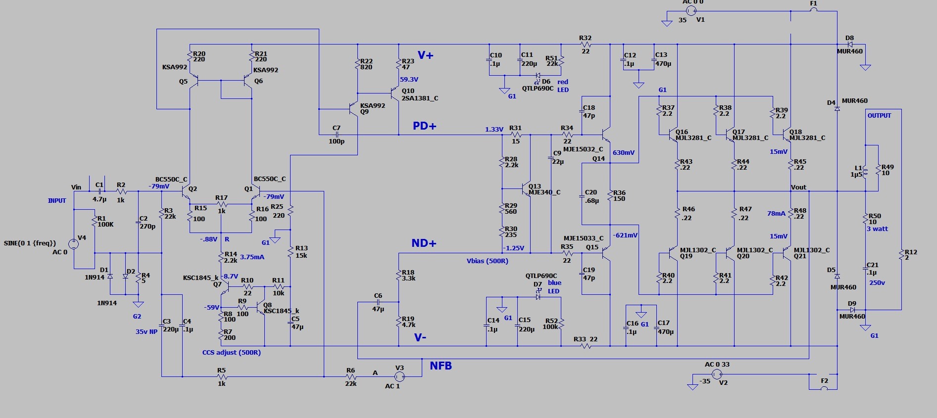

So much interest in bass amps ??? Want me to design the best for you all ?
I can keep it simple. The best is actually what I posted as the "Behringer" . But it's circuit running a wolverine EF3 would be
quite ideal. Nothing like it in "OEM land". You want the bootstrap ? (below) .... I did not EF3 it yet ... but .01% 2R at 200w is good.

I'm running my behringer at 120w ... over 200w peaks - not even coming close to Xmax. Easy 106db at 25hz. gut wrenching bass. the Polk amp
could not do this ... I fixed it before I replaced it - it sucked !
"Want me to design the best for you all ?"
I'm interested! I can help with a little monetary support!
