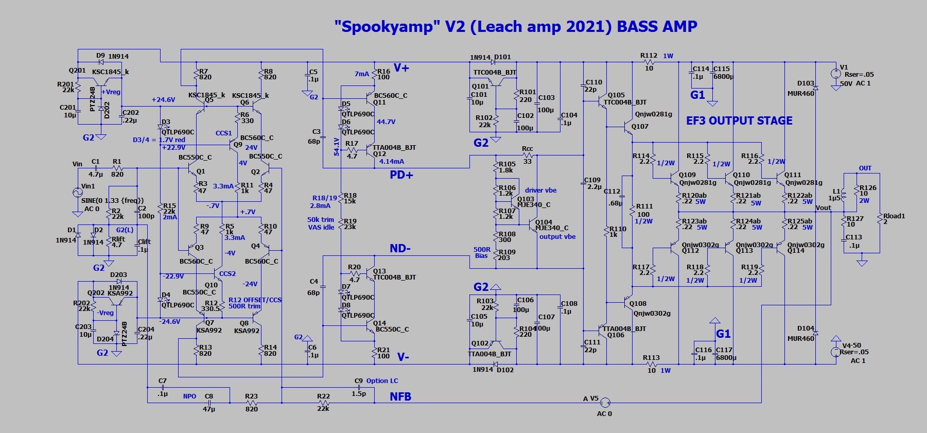

How to design and build a dedicated Bass Power Amplifier. Is it different?

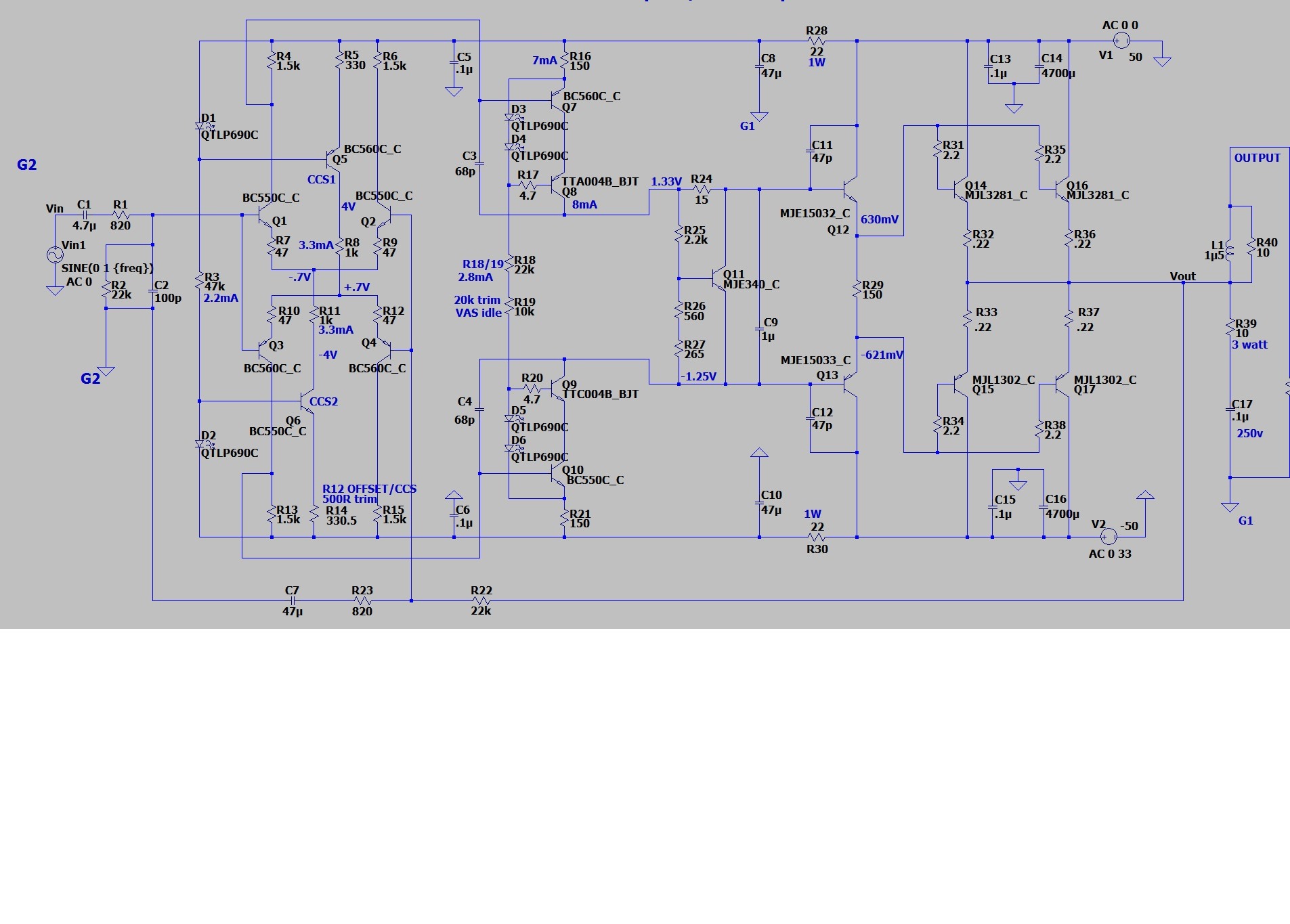

Built this for a friend in 2014 , it still works today with a dayton 12" sub.
Another friend uses a similar circuit to run VERY power hungry 15-18" subs. 2014 - present. - he uses 7 pair sanken MT-200's !! Yikes !
It has very good PSRR and the hawksford VAS can clip without many upper harmonics. A nice "rounded"
symmetrical overload waveform. VAS red led's light up in overload.
go ahead and feed 2V at the input .... tubelike. Output devices never saturate. Bombproof ultima !
PS - for sub/bass use , one could leave out the cap multipliers and just use a simple zener 24V regulator without the series pass devices.
Symmetrical designs natively cancel rail ripple , hence why this circuit is ideal for a dedicated bass amp. Smaller 4700-6800uF filter caps
will be plenty for even 300W usage. Also, mine ran cool with 30ma/ device (6mV) bias. Xover distortion components are nowhere near a
woofers audible range.

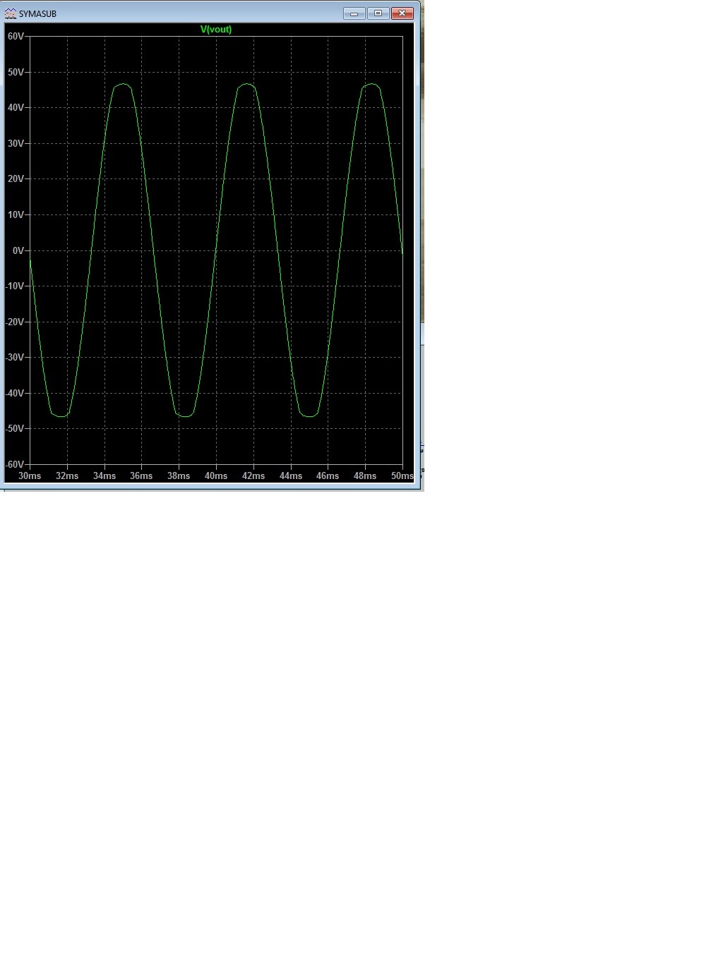

Here is an even easier one. Most likely it will be this ....
-simple EF2 (Badger output stage)
-50V rails. Most OEM's are similar.
-Just 4700uF rail caps , symmetrical designs are native "ripple eaters".
-Hawksford red led VAS can clip all day (below 2). .... at 92V p-p.
- .01% is fine for a sub amp. 2 pair TO-3P at <50V can drive 200W/4R.
I will also make a combined Filter with phase and a remote start board to go with it.
It will replace any of the parts express junk ( or the absolute OEM junk). Just
add a 200VA 35-0-35 toroid.
