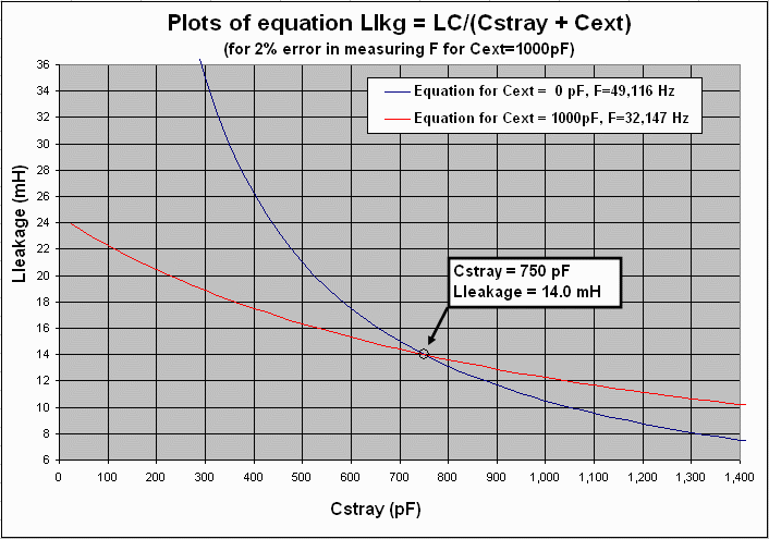

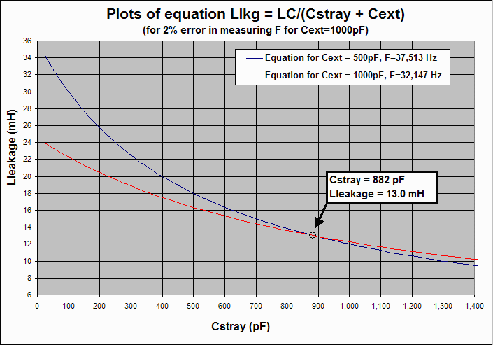

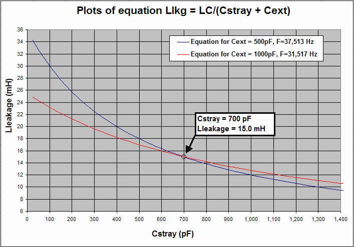

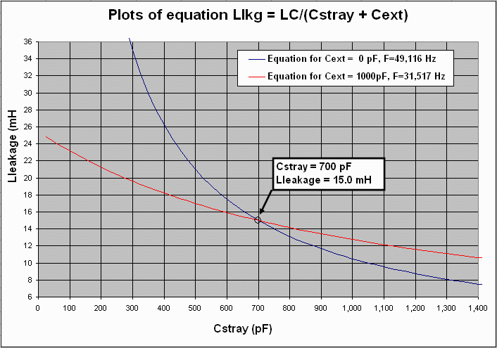

Transformer Measurements
The major parameters that are needed for tuning the Q of the high frequency resonance are:
Stray Capacitance, Leakage Inductance and Winding Resistance.
The measurement system I use is not conventional, but is more useful in determining these values in the frequency range and loading in which we are interested.
The resonance is determined by the value of leakage reactance and total capacitance. The total capacitance is the value of internal stray capacitance plus the external capacitance which will ultimately be the ESL load.
The frequency of resonance is:
F=1/(2pi(LC)^.5) where C= Cstray+Cext
We will make 2 frequency measurements. Each measurement is made with a different value of external capacitance. From this we can determine the product LC. It is then possible to determine Cstray by substitution. L is then determined by having a known frequency, Cstray and Cext.
Cext should be values near what will be used as the ESL load.
The test setup has a 4 ohm resistor in series with the primary of the transformer. This limits the impedance as seen from the amplifier. The amplifier is driven by a signal generator. Set the gain so that the amplifier has an output of about 1 volt. The probe is then connected at the primary of the transformer as shown in the test circuit. We will find the frequency which has the minimum voltage by sweeping the generator. The frequency of minimum voltage indicates resonance.
Resistance can be determined by direct DC resistance measurements of the primary and secondary windings. Remember that the effective resistance of the RLC secondary circuit is Rsec + Rprimary(Voltage Ratio)^2. One could also determine total effective resistance by measuring the magnitude of the voltage at the minimum and calculating the secondary value. The 4 ohm resistor and the resistance at resonance make up a voltage divider. Another way is to measure amplitude at key frequencies around the resonance to calculate the Q.
I use a spreadsheet to do the LC calculations.
Be sure to protect the transformer by either using a low power (1watt) 4 ohm resistor or series fusing in case the amplifier breaks into oscillation. Always be aware that the secondary voltages can be quite high. Take care not to make contact!
Jim

Graphically what you are doing when you solve for two unknowns with two unique equations, you are solving for the point where the plotted curves of the two equations cross.
Plot #1
Plotting up the two unique equations for all possible values of Llkg and Cstray that fit the equations, and you get plot#1 below.
Notice the curves cross at the calculated solution for Cstray & Lleakage.
Notice also that the slopes of the two curves are very similar.
Plot #2
With such similar slopes to the curves, if there is just 2% error in the measured value for F2(32,147 instead of 31,517), the calculated value for Cstray = 882pF is now off by 26%.
It helps to understand the possible error band when using this technique
Obviously, this technique can't be used to determine what portion of Cstray is due to secondary winding capacitance, primary winding-to-secondary winding capacitance, and other stray capacitance, like to the core. This breakdown may be important if you are trying to optimize a transformer design.
Plot #2
Was tired last night and forgot to mention that in the past I had always gotten better results using Cext = 0 pF (no added load capacitance) for one of the equations.
Here are Plot #1 and Plot #2 replotted with Cext = 0pF for the 1st case instead of 500pF.
Note that the slopes of the curves show a bit more separation than in the last post.
The result is that 2% error in the determination of F for the 2nd case results in only 7% error in the calculated value of Cstray; a nice improvement over 26% from the previous example.

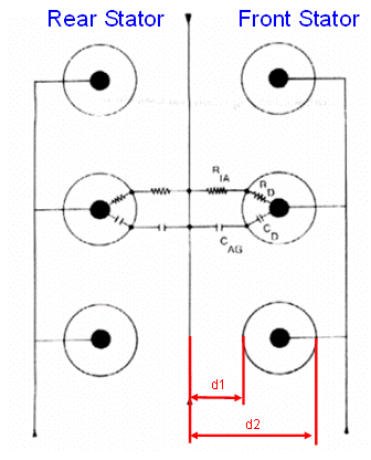

Time to back up with a simple question.
The spacer used will yield a d/s less than the thickness of the spacer because of the height of the wire.
When someone is claiming a separation of say 2mm. are you using a spacer thicker than 2mm. by the amont of the thickness of the wire?
Is there a common convention on what everyone is sayin?
Paul
Paul
Paul
Hi Paul,
For comparison between ESLs, the d/s spacing is the distance between diaphragm and outer surface of stator insulation.
With perforated sheet metal stators this is usually just equal to the thickness of the spacer plus any adhesive used.
As you correctly pointed out, for most wire ESLs the spacers used are thicker than the desired d/s spacing by OD of the wire.
In attached pic from the Acoustat white paper d1 = d/s spacing, and d2 = spacer thickness.
