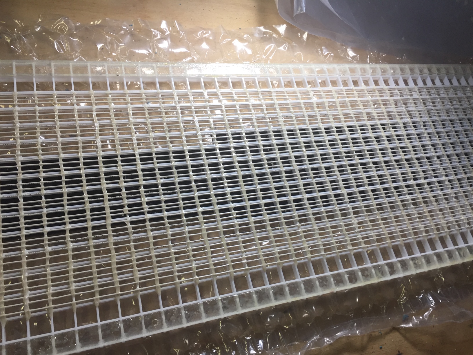

Seems I've exhausted all the internet sights selling polyester sheet.
The thinnest I've found is .oo1'' most places .002''
I'm wanting to redo my 2+2 at 20 wires/ inch and decreasing the d/s slightly as I'm using subwoofers for the deep bass probably crossed over at 100 Hz.
Not sure where to get the spacers as well.
Should I glue four pieces of plastic around the edge of the louver panel,
or do I need to buy sheets of plastic and cut a rectangular hole in the center?
Am going to use the cheep styrene louver as in 10 or 15 years I'll be deaf anyway, so longer life than that isn't quite necessary.
Anyway, where can I get thin "mylar" and the spacers?

Plastc Strips
McMaster Carr has plastic strips. I was buying ones that were 4ft long as I recall.
I don't know about polyester film. I got mine by asking for samples.

The last time I checked .5 mill or .0005" Mylar is the thinnest in suitable widths that is produced here in the US.
Thinner stuff can be found from some online model supply services, ebay or overseas suppliers
I have been able to get some really thin stuff from some elcetron microscopy suppliers such as chemplex.
But it is only produced in 3" widths that I know of maybe 4" if you are lucky.

I had gotten a large 4' sheet of some .020" Mylar that I cut into strips and glue along the edges to support the diagphram frames for the next 4 foot panels.
As I will use the same construction methods that I used for my smaller panels.
You can also get acetate or mylar from from hobby supplies or drafting supply houses in various thicknesses so that you can taylor the D/S to exacting specifications as needed.
As long as you use a good amount of adhesive you won't have any problems.
I used super glue and I only had to do a few repairs since they where built 10 years ago.
Only because I didn't use enough of it.
Epoxy may have been a better choice but it is very messy to work with.

McMaster Carr has .0005 polyester

Glue for stator wires
I saved the waste pieces of the plastic grid that I was cutting. I then cut them into small pieces and dissolved them in solvent. Not too thick and not too thin.
You want it just liquid enough to be able to come out of squeeze bottle without running. I use miniature squeeze bottles with conical tips.
Acoustat had a machine named Mabelline that laid the lines of glue over the wires. Maybe someone here can send you a link to the Acoustat factory tour.
I do recommend starting slightly concave and anchor top and bottom first.
Then when the panel is flattened it holds the wires to the plastic grid firmly for glueing.
I hope this helps,
Jim
Here is a picture
Hi Jelanier.
I am going to create a cell with the stator type Acoustat.
I would be interested to know exactly what you glued the threads with and if I can reproduce this substance.
Here is a picture
Thx!!!
Thank you jelanier.
Your information is important.
I will be able to create the liquid to glue.
On Mabelline I try ...
Great things.
Thank you jelanier.
Great things.
