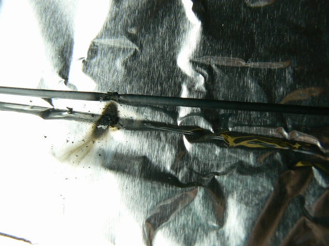

Starting with 1kHz @ 2kV. With lights out, could just see some corona glow around the wire.
Stepping up to 5kV, more corona and starting to smell a bit of ozone.
With 2kHz @ 5kV the corona was visible with the lights on. Very cool blue-purple glow.
So I had to call the wife in to have a look see. She was oohing and aahing at the pretty blue glow so I cranked up the frequency..3kHz..4kHz..5kHz...more and more intense corona, and then....
CRACK!!! and little wisps of smoke.

Told you!!!
Welcome to barrier discharge world. Sometimes the distance (low capacitance) is more important than type of dielectric.

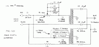

With Acoustats, the more panels you have, the easier the load on the amp. The 2-panel 1+1 being more brutal than the 4-panel 2+2, for example.
So if I redid my acoutat 2+2 panels with little panel like geraldfryjr did but used a lot of them to give the same total panel size of my 2+2's, it would be easier for my amp to drive, and easier to make to!?
Paul

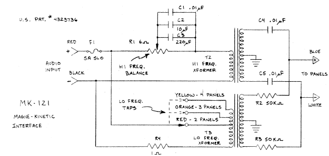

Assuming you have the same panel area as your 2+2s built up from smaller panels with the same D/S, and have the Acoustat interface hooked up the same way, the load on the amplifier would be pretty much the same.
I think pforeman's comment about 2+2s being easier to drive than 1+1s comes from the way the Acoustat LF transformer is configured for each case. Take a look at the attatched pic.
For a 1+1s the RED LF tap is used.
For 2+2s, the YELLOW tap.
So, the 1+1s use a higher step-up ratio for the LF transformer than the 2+2s.
This equates to a more difficult load in the bass and midrange.
With twice the area and twice the capacitive load, one would think that the 2+2s would be a more difficult load at high frequencies. But, the minimum HF impedance is mainly be defined by the setting of R1, the HF balance control. So, there may be little difference in the load the amp sees at HF.
I am not an Acoustat expert though...just my 2 cents after looking at the circuit diagram.
