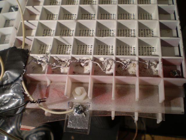

Also I was wondering about the termination of the wires on the egg crate.
Do you cut the wires (top and bottom) at the edge of the egg crate, solder them up and then cover all of this solder work with the spacer such that looking at the top and bottom edge of the completed panel, you don't see any of this solder work?
Thanks,
Paul
Do you mean something like this?
although this is a poor and sloppy example this technique could be used to easily create segmented panel connections and once satisfied tucked in and capped off so that it can't be seen.
