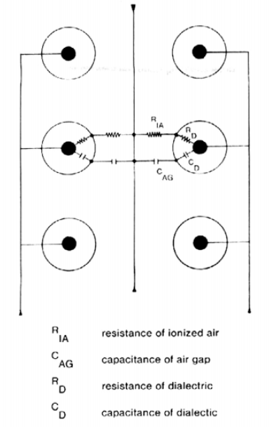

Referring to the attached figure taken from the Acoustat White Paper:
DC voltage
Ria & Rd form a resistive voltage divider for the applied bias voltage.
For a given bias voltage, you will maximize the voltage across the airgap if Rd is much smaller than Ria.
So you don't want a really good insulator for your insulation like teflon, otherwise most of the applied bias voltage will appear across the insulation rather than in the airgap.
PVC or Kynar are pretty conductive as far as insulation materials go.
AC voltage
Cag & Cd form a capacitive voltage divider for the AC voltage(music) applied to the stators.
For a given AC voltage, you will maximize the voltage across the airgap if Cd is much larger than Cag.
To make Cd large you want an insulation with a large dielectric constant like PVC or Kynar. Again, teflon would be a poor choice.
Voltage rating for wire insulation
If you choose a wire insulation that is somewhat conductive and has a high dielectric constant, the working voltage the insulation has to withstand (in a constant charge ESL) may be much less than you might think.
With Rd & Cd fixed by the insulation properties, the percentage of the applied voltage that appears across the insulation is a function of the airgap size. For ESLs with airgraps of roughly 1/16"(1.5mm) most PVC forumlations will have only 10%-15% of the applied DC & AC voltages appear across the insulation. So voltage ratings of 600V should be more than adequate for most PVC wire ESLs.

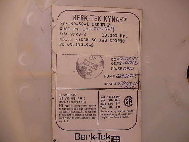

Kynar appears to be even better than PVC with both lower resistance and higher dielectric constant. But, it costs more and is not as readily available.

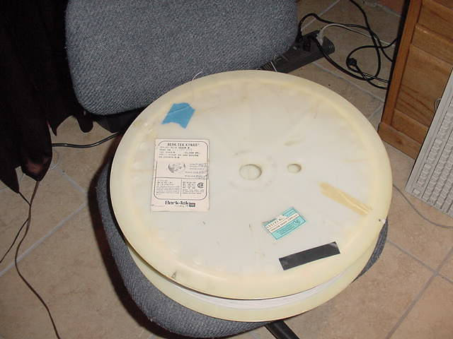

DaveG, Before I had choose to use p.c. alum. screen I was going to use kynar coated w.w. wire ,as it was the smallest gauge wire that I could find that could withstand over 10kv to 15kv without one arc thru.
I'm thinking of building a panel like my small one just to compare it to.
It would still be my wire of choice if i were to go that route today.
If you have 6000' of it by all means use it.
I feel that you would probably much more happier with the end product than you would with a breadboard rats nested with that stuff.
Trust me I have done many and it is nearly imposible to repair a mistake or make a change once it gets full.
So,I can't think of a better use for it either.
Back in 1986 that stuff was cheap compared to todays prices! jer
