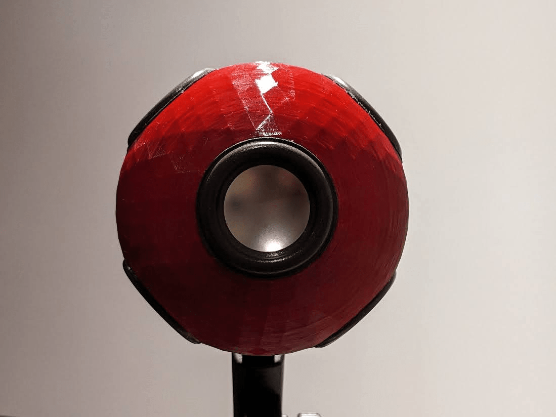

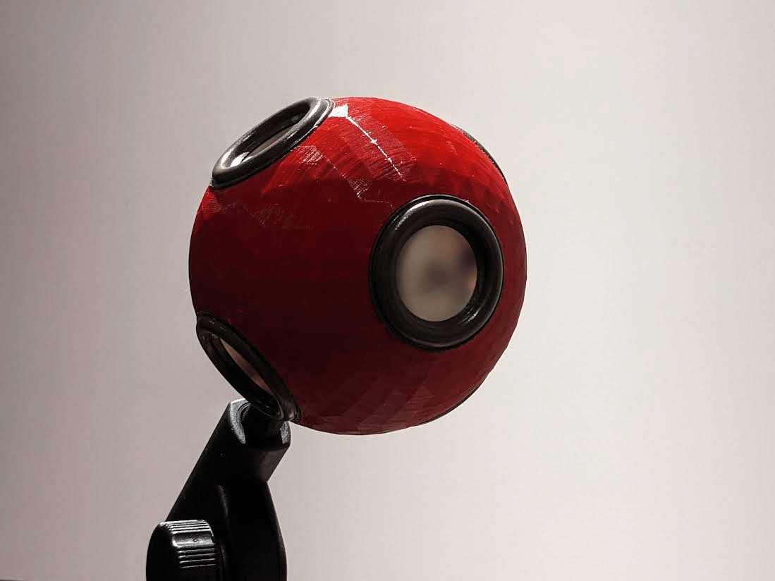

The small red spheres sold and left the house a few weeks ago. A friend dropped by and had a listen to them. After two minutes he said "My speakers will never sound this good. I'm buying these". So it is time to start on another pair. I have a few 2" Whisper drivers, so I made a print to see how that works. The Prusa slicer makes these tree shaped supports that save filament but look weird. The first print in black looks OK. I think the red looked better. I messed up the driver mount cutout depth a bit as these protrude from the sphere by a few millimeters. I think it will pair well with two 10" Vifa woofers. The black does match the woofer box nicely. These rare earth magnet woofers are great as the woofer and the box combine only weigh 24 lbs.
Very cool approach. Question though how much of the midrange comes from the woofer in the cube? Mid frequencies (vocals esp.) benefit from spheres, and cubes are generally not the best shape for these.
The small red spheres (post #450) with 1" Aurasound Cougar drivers crossed over at 300Hz with 24dB/oct to a single 12" woofer. That actually worked better than I expected. Moving up to twenty of the 2" Aurasound Whisper drivers I hope to get the crossover down to maybe 250 or 200 Hz without sacrificing too much dynamic range. I plan to use three 10" woofers in three stacked boxes pointed in different directions with each sphere. The box I bought is not idea, as I wanted the half cube shape, but these will probably work after I add bracing and stuff them with fiberglass to move all the resonances above 600Hz and damp them. With the woofer box panel and acoustic resonances well above the crossover frequency there will be no audible "box sound" in the midrange. Without bracing or stuffing I knocked on the woofer box wall and this was spectrum measured with a microphone. Two nice panel resonances right about 300Hz and 400Hz. So bracing the panels should move those higher. Unchanged these boxes would sound like crap. A pure 250 Hz sinewave is difficult to locate. If the woofer produces harmonic distortion, the 500, 750Hz harmonics give away the location. So with a low distortion woofer the voices in that range locate to the sphere that is reproducing the recorded harmonics in the voice.

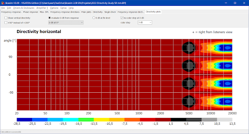

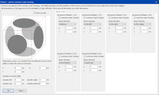

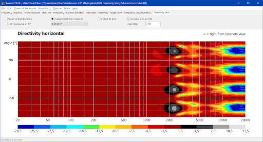

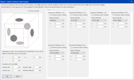

I found that there is sort of a upper cutoff frequency for an omni directional speaker dependent on its size. Using the Boxsim speaker design software I modeled different size cubes with six of the same 2" drivers (4 cm cones) centered on each face. As boxsim can't make a sphere this is a pretty good approximation. The radiation pattern repeats every 90 degrees and it's makes for some interesting plots. The first image is the setup for the smallest cube about 6 cm (about 3"), close to the size of the drivers. The second is the setup for the 15 cm cube. I generated larger cubes that were 15 cm ( 6 inch ) and 20" on a side. These are all omni directional at low frequency (uniform color in the plot top to bottom) and then transition based on the size of the cube. The same 2" driver was used in all examples. It is interesting to note that the first deviation in the response is a boost in output at 45 degrees followed by dips in output going up in frequency. The conclusion is that a very small cube or sphere is required to get an even omni-directivity pattern at the highest frequencies. If you don't have a tube amp, use that computer running speaker simulations to stay warm out there.
Above: 3" omni directional cube speaker directivity pattern. A uniform omni-directional pattern up to about 4,000 Hz.
Above: 6" omni directional cube speaker directivity pattern. A uniform omni-directional pattern up to about 1,600 Hz.

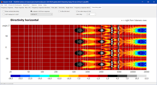

Above: 20" omni directional cube speaker directivity pattern. A uniform omni-directional pattern up to 500 Hz.

The irregular polar response is likely due to the distance between the drivers causing constructive and destructive interference.
As the centre-to-centre of the drivers rises above a quarter wavelength one starts to get lobing caused by comb filtering. Given the non-panar mounting driver dispersion will play a greater role.
8 sided, vrs 12 sided, vrs 20 sided will get more and more complex in twrms of the lobing.
For reference, combing on a plane (5 driver line array).

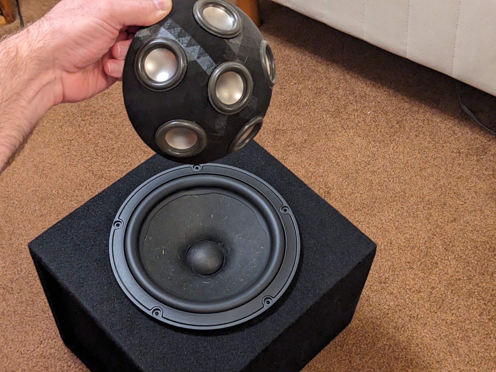

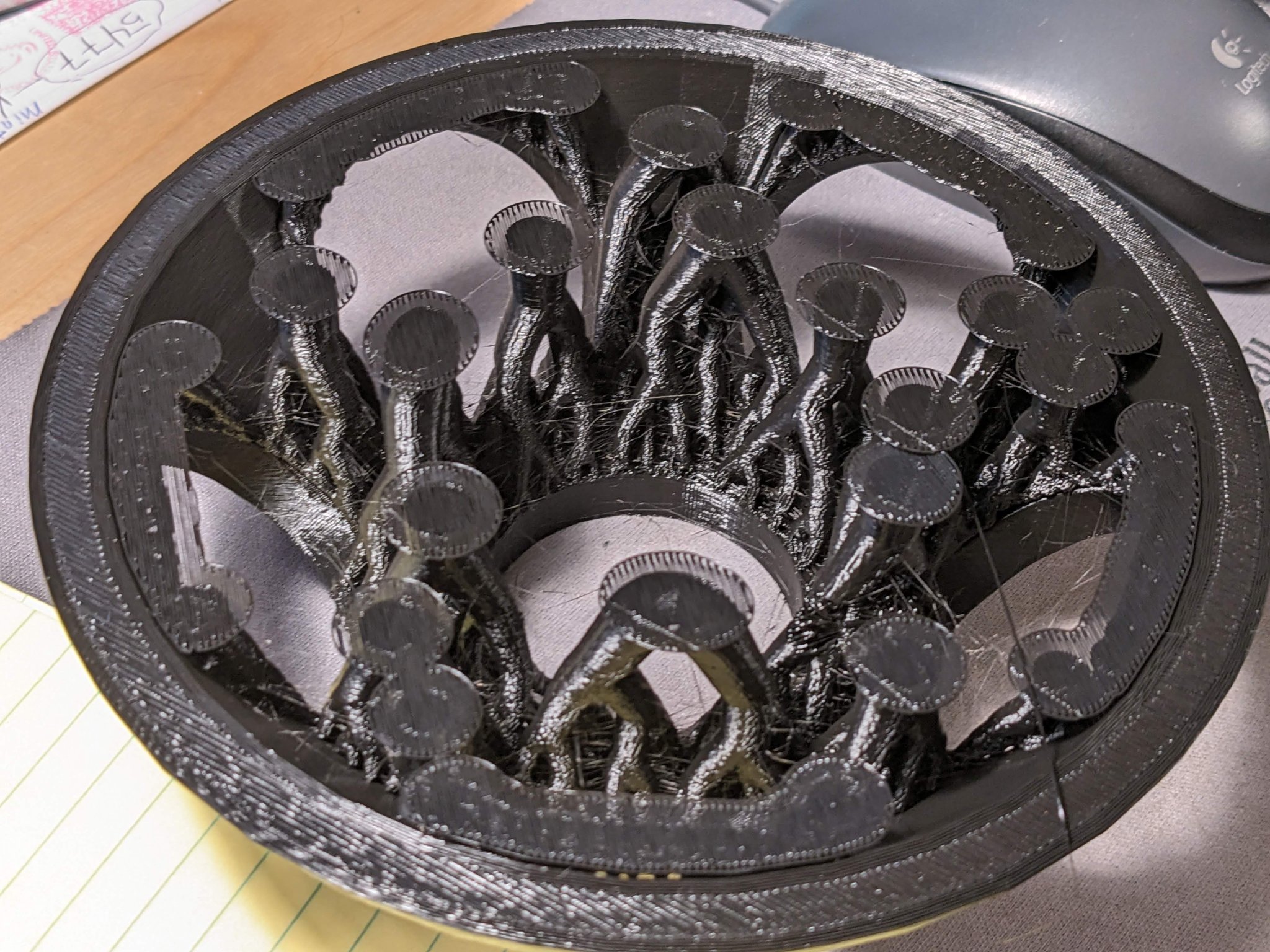

I completed a third version of spheres. I was able to cram six two inch drivers into a 4" diameter sphere and the results are very good. The smaller sphere extends the high end dispersion pattern cleanly to about 4 kHz. Above that some equalization works well to smooth the magnitude response variation due to the directivity lobes and produce a good response to above 10 kHz. I demonstrated them at the Pacific NW Audio Society meeting yesterday (www.audiosociety.org) for about 50 people. The speakers were very well received with everyone complementing the sound. I set them up "in the round" with two sets of 20 chairs one in front of the speakers and one behind the speakers, as they are fully symmetrical. With such a large group and large room they didn't benefit from the reflections off side and back walls so the effect was very good, but not as good as it is in my listening room. This time with six of the 2" drivers. I calculated that these will produce an SPL max of 109 dB at 300 Hz limited by the drivers at Xmax. To produce the same 109 dB SPL at 36 Hz requires three 10" woofers with Xmax of 9mm in sealed boxes. I am currently using just one woofer per side and it works pretty well.

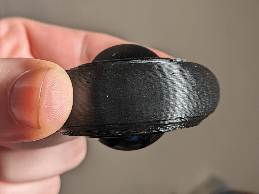

I just competed a small two tweeter flying saucer to orbit the small red planet. It looks promising, I have yet to get a crossover put together to test it with the sphere.

These are very interesting and look great too. Can I ask what drivers are these and overall how low bass do you get? I have built two-sphere speakers with added sub for low bass, and four-sphere design with the subs built in each. Would you look to add say a 1" dome tweeter to this above the sphere?

Seriously, though, the flying saucers would make excellent surround and rear speakers!

Six Aurasound Whisper 2" full range drivers. There is no bass from the sphere. A 10" woofer in a separate box handles that. The Whisper has an fs of around 150 Hz. I have the crossover at 300 Hz where the distortion starts to rise. The black UFO has 1" tweeters to cover above 4.5 kHz where the 4" sphere starts to roll off.These are very interesting and look great too. Can I ask what drivers are these and overall how low bass do you get? I have built two-sphere speakers with added sub for low bass, and four-sphere design with the subs built in each. Would you look to add say a 1" dome tweeter to this above the sphere?

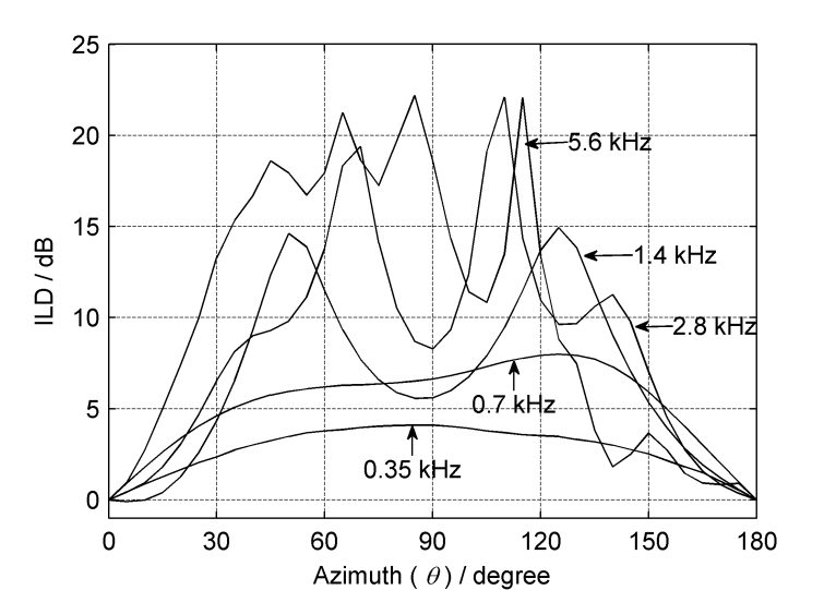

I got curious and reviewed Toole, Sound Reproduction Loudspeakers and Rooms, 2nd Edition.Floyd has said that combing looks way worse than it sounds, but it will eat DDR.
dave
Chapter 5, Timbre Changes / Comb filtering , repetition pitch:
Toole: "The effect is audibly obvious if it occurs in an electronic signal path or if there is a single, strong reflection ... "
My interpretation: the delayed sound and original sound come from the same direction is audible.
Toole: "For reflections that arrive from large horizontal angles .... the effect ceases to be a problem"
My interpretation: With two ears listening sounds from different directions that would produce a comb filter
response at a single microphone are not an audible problem for a listener with two ears. I see no reason that
large horizontal or large vertical angles would not be the same.
Chapter 9 Section 9.1.1 Very Audible Differences From Similar Looking Combs drives the point home with an example
describing three cases a), b) and c) where the single speaker case c) producing a comb filtered output "greatly degrading effect".
Toole's example speaks to producing the comb filter effect electronically but the same effect could be produced acoustically with a single
speaker having several drivers at different distances from the observer.
As usual it is possible for people to draw different conclusions from the same source depending on what they are focused on.
