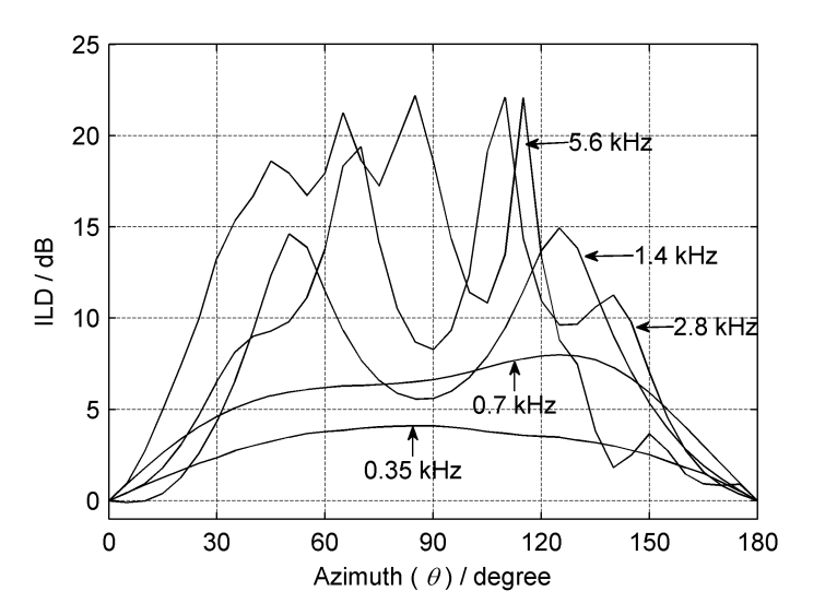

So much of what is sensitive is defined by our ear shape and head shape.
The 2 mics don't account for this. (search HRTF for more)
I'd say the test is perfectly viable. If we listen with one ear or two, HRTF will influence what we hear in both cases.
The difference between one mic and two, the two spaced like an averaged sized head does demonstrate that there is a difference between Stereo perception and measuring with one mic. Specifically for phantom center sounds. It simply demonstrates a comb filter occurrence that is present when listening to a stereo setup. There are many more comb patterns we perceive, the minute we place a speaker in a room.

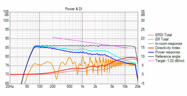

While @olsond3 questioned the use of multiple drivers, a single driver with it's mirror images in ground floor, ceiling and walls has a similar effect.
In fact, his speaker that does have multiple sources will help hide some of that combing because each separate source will have slightly different reflection patterns before it reaches the listener's ear. Together they will average out the stronger single reflections you'd get from a single source speaker. If you look at the in-room results in a simulation from Vituixcad with floor, ceiling and wall reflections active one should be able to see these differences.
An array of drivers can do similar things, though a straight array will only do it in one plane (floor and ceiling).

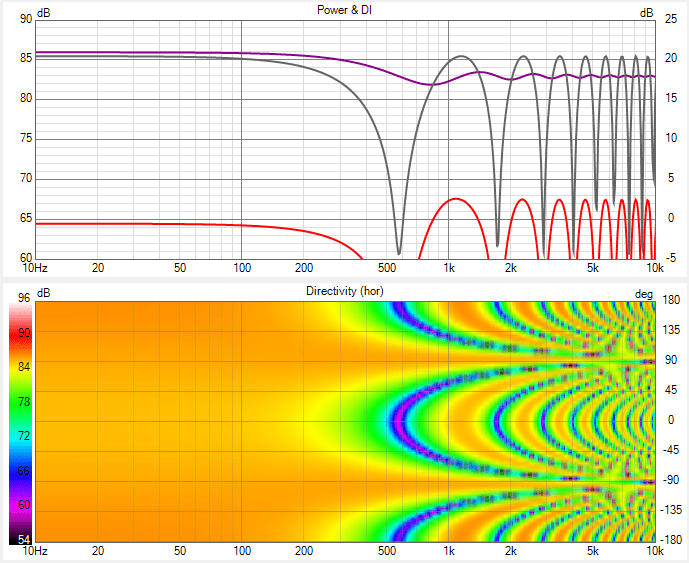

Here's an example of the frequency result of an array vs a single speaker at the listening spot with floor and ceiling reflections active:
The louder result (watch the orange in-room prediction) is the (frequency filtered) Array, which one suffers from more comb filtering?
Sometimes things are not what we would think they are. One would think all those separate sources would perform worse, right?
The single source suffers from more comb filtering because of the in-room floor and ceiling reflections. The floor and ceiling settings are exactly the same, the (reduced) comb pattern from the array due to C to C spacing of the drivers is still visible, but what effect is worse when listening to both?
I'd like to see in-room predictions from the sphere source too, as it will probably be superior to a single driver result. If it is, it would be because of it's multiple sources at slightly differing distances and positions.

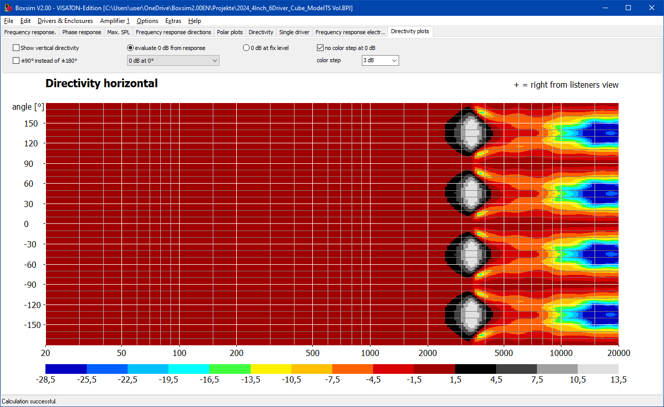

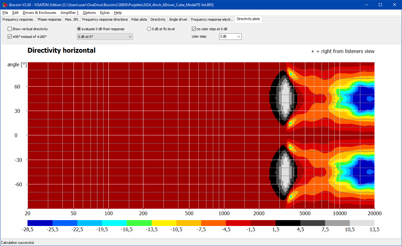

Below are the measured directivity of the sphere as built and the prediction from the attached Boxsim model for a cube of the same size.
Figure 1: Measured Directivity of 4" sphere with six 2" drivers.
Figure 2: Boxsim calculated directivity of 4" cube with a 2" driver on each of six faces.

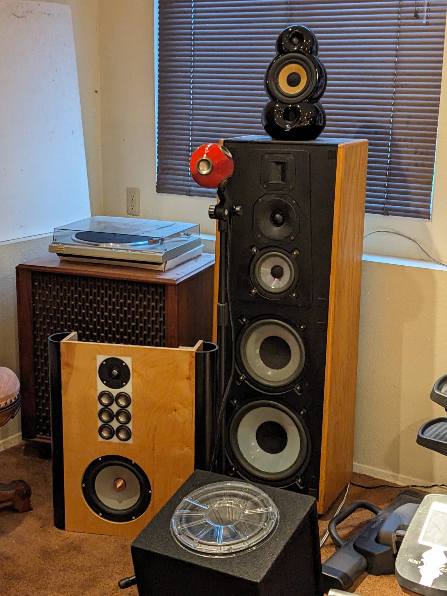

I've heard about the PNW contest that seems very cool. What's the older looking console under the turntable?
Cheers. Perception of a mic, not a head. (mad props for the vcad sim though)The difference between one mic and two, the two spaced like an averaged sized head does demonstrate that there is a difference between Stereo perception and measuring with one mic.
Spaced like a head is not the same as the changes caused by the head shape and the ears. That was my point. The head can make some sounds more forward, some have a head shadow, and some are not effected by the head at all.
That is the Barzilay 762 speaker my father purchase around 1968. He grew up on a farm and was able to build anything he wanted. So when he couldn't find the equipment cabinet shown in the picture below, he just built a copy himself from scratch.
I think Barzilay built several configurations including empty. This pair had the JBL LE 12C installed. I recall that dad thought they had the separate woofer and horn tweeter when he bought them used and was disappointed when he opened them up. The 12C had very muted and rolled off high end, and sort of billowing bass with the tuning in this box. I fitted some drivers from Madisound in the late 1980's to make them a three way. I opened them up last month and plan to retune the port, install a modern midrange and design and a well engineered three way crossover so they can be listened to with out cringe.

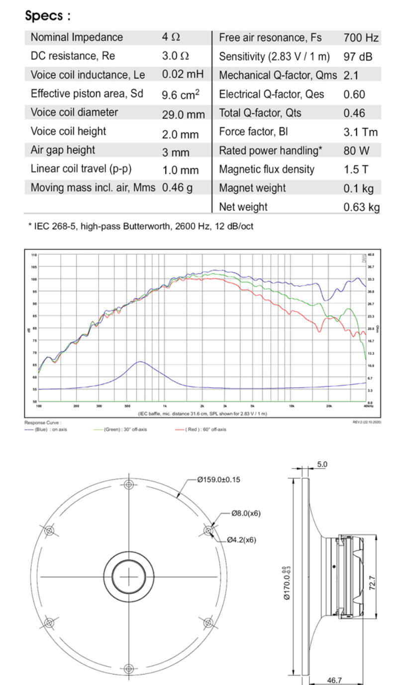

I am choosing drivers for a spherical speaker, dual sphere, tweeter and woofer and I was considering the Satori TW29BNWG-4 Beryllium Dome Tweeter with Waveguide. My only concern is the interaction if the waveguide and the sphere. The sphere will have a radius of 3.5", about 80mm. Is this a good way to go, or another tweeter without a wave guide would be a better option? tks,

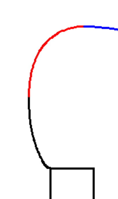

If you put a 6.5" waveguide on to a 7" sphere, it will be like a rear cap. You'll quickly round the edges of the waveguide back around to it. However, it is that edge section that is the most important part of the rollback.

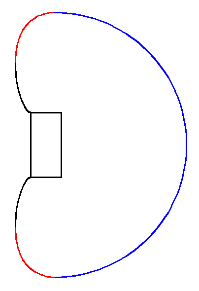

If I were in your situation I'd continue the waveguide design thoughtfully around to 180 degrees (going backward, ie normal to the sides), and then put a hemisphere on to it.

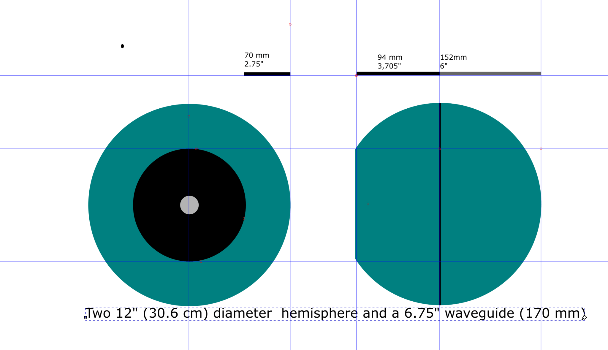

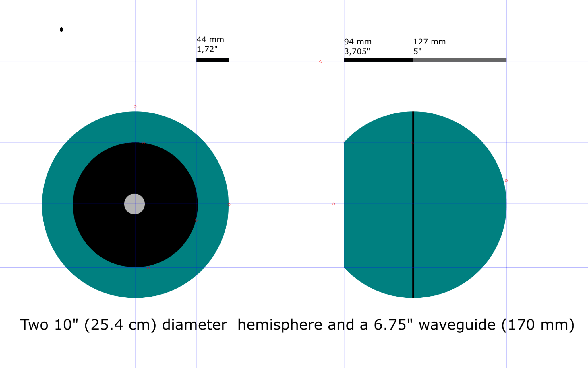

the 7" diameter was an starting idea, it can be made larger. If i understand you correctly, get two 10" hemispheres, (9-12" maybe) and cut one at the level to mount the 6.5" and join the other together, thus having about 1.5 inch "border" around the speaker. Is this what you meant?
That does not look like it is near big enuff. You want the curve of the waveguide to meet the curve of the sphere in a fairly gentle continuous curve.
And then ou would need to sculpt out the bottom so that it nestles as close as possile to the midBass.

Your task will to be to make a functional region between 90 degrees and 180 degrees. I've shown that here in red. Your work will determine the diameter of the hemisphere (blue), not the other way around. I want to make it clear that I've done no calculations to demonstrate the red portion is practically functional, but it does represent an example of a smooth transition.Is this what you meant?
Its called a fair curve and the software that I mentioned uses that principal to create a structural shape
It's not a fair curve per se, there is more to it than that. As I mentioned, it determines the diameter, not the other way around.. unless you're constrained for space 😉Its called a fair curve
This shape cannot came from a hemisphere mold, I would need foam foam or 3d print shaped in a way similar to the image and then make a mold or apply the fiber glass in top of it (that is how we made hemispheres before, by making a mold out of a plexiglass hemisphere). It looks that I may have to forgo those tweeters and look for another option.
