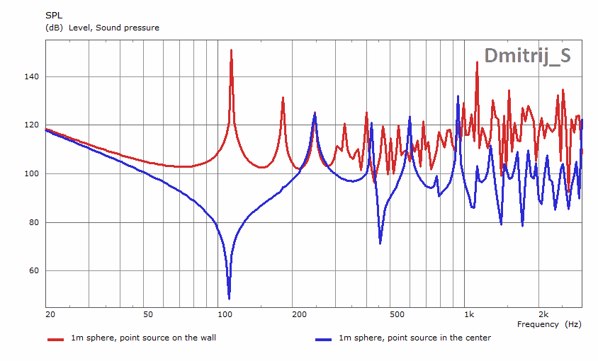

The point source on the wall
The point source in the centre
I'm building a 6" diameter sphere. Can Akabak3 model damping in the enclosure? What density of damping would smooth the response from 300Hz and up in a 6" diameter sphere? Simply packing the sphere tightly with fiberglass would avoid making tapered cylindrical enclosures for the back of each of 20 drivers and packing them with damping. That site isn't secure and Windows throws warnings about installing it. I could go build a virtual machine I guess.I'm not sure what you want to hear 🙂. I think that you will figure out how to build a spherical box without my help, especialy if you understand some theoretical basics. Nevertheless, I don't build spherical boxes because the spherical shape is not very pleasing to the eye (at least for me).
I was not too lazy to spend half an hour yesterday to simulate a spherical box SPL in a fixed microphone point, excited by a point source in different places (in the center and on the wall). As the theory predicts, certain modes are supressed when the point source is placed in the node (this statement is true in general for all boxes, not only for spherical).
For those who want to play with placement of the microphone and the point source in 1m sphere, i prepared Akabak3 project file, you can run the project in Akabak3, which is free to download. Akabak3 automatically draws SPL graphs, you just need to download and install VACS viewer.
Akabak3 allows you to deal with a wall damping, but generally speaking, damping of lowest modes by covering the walls with porous material is not a good idea, because the porous material works most efficiently when it is placed in the node of the standing wave, where the speed of the air particles is greatest (whereas at the wall it is almost equal 0). Usually in acoustics, wool/fiberglass with a density of 15-30 kg /m3 is used to absorb standing waves.

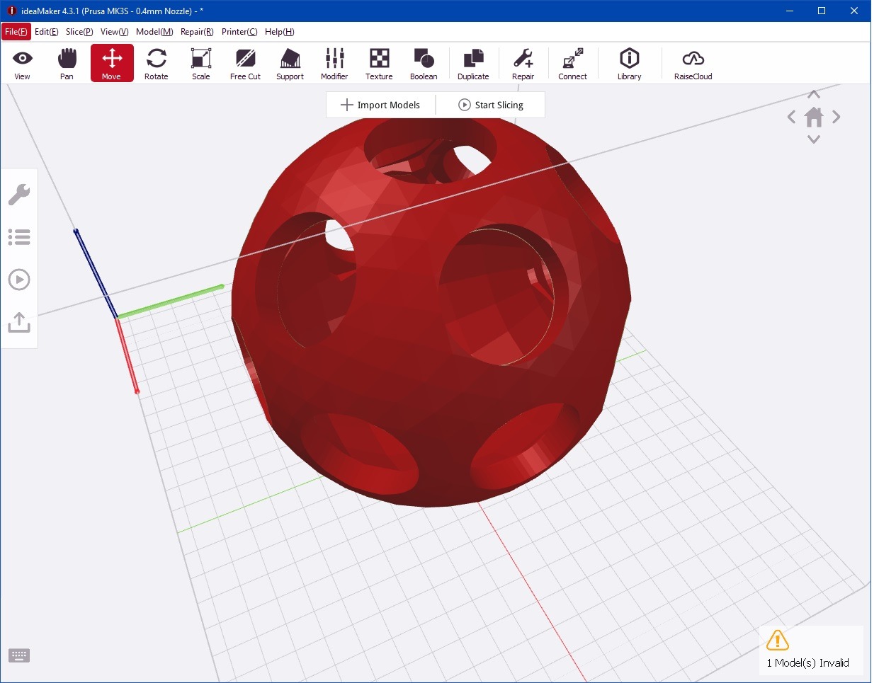

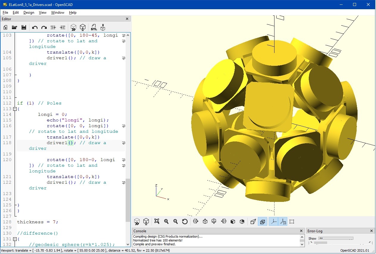

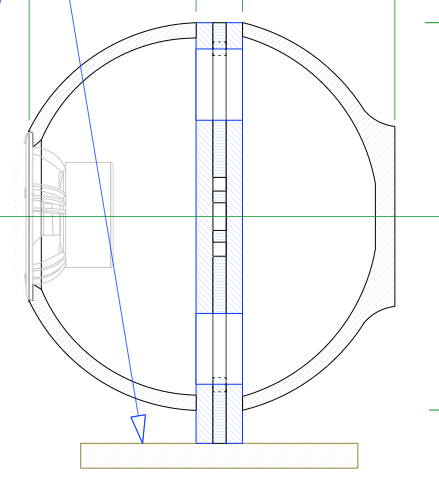

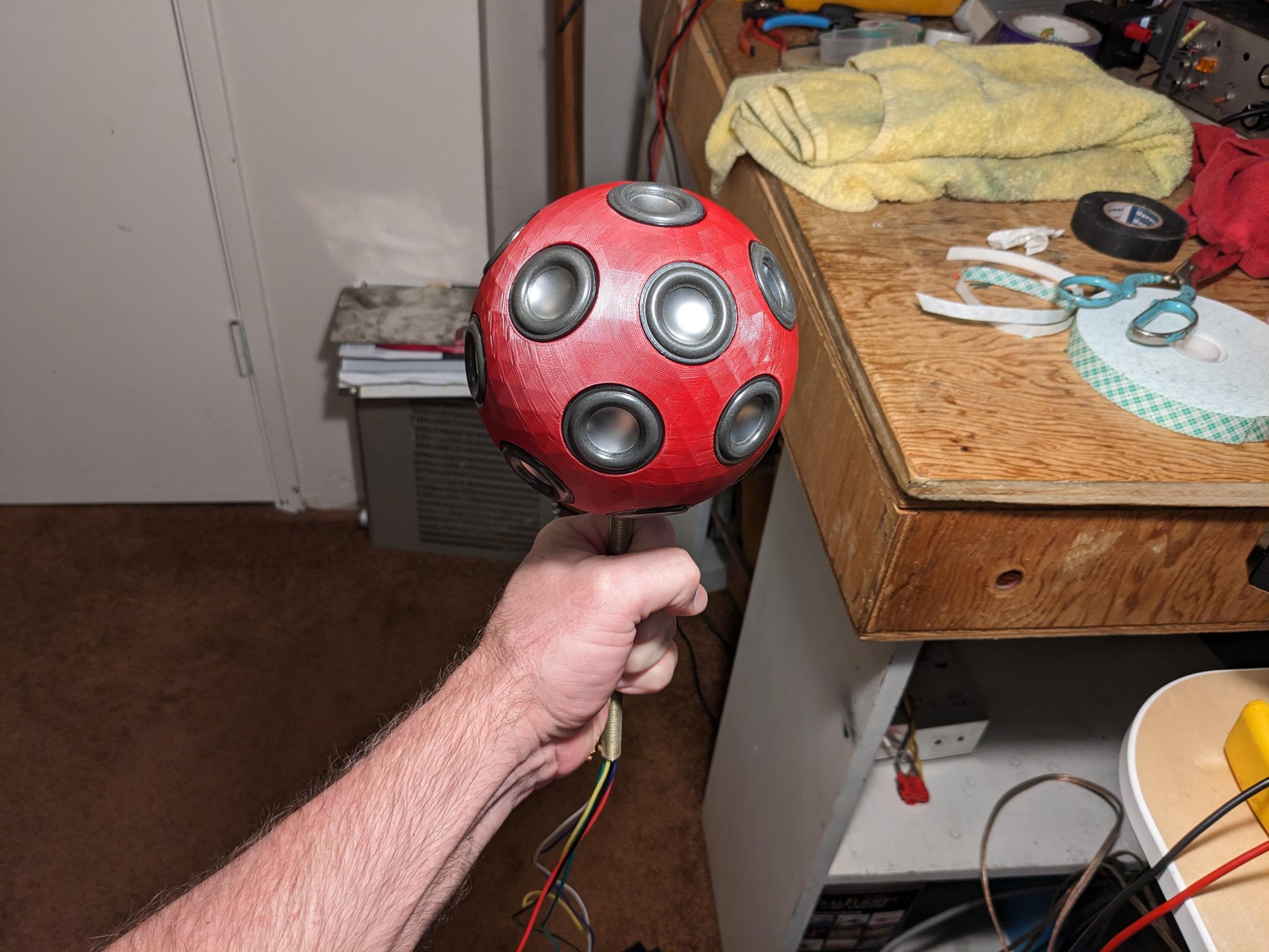

Totally agree with Dave. I thought about how difficult it would be to cleanly glue all those segments together and have nice looking seams. So I went back and made some drawings of the whole sphere. It may be nice to print two pieces, or just a single piece with an access hole at the back or bottom. It looks like a I can fit it on my printer. Here's a drawing with some of the driver mounting holes shown. The laptop won't render with all the drivers holes in place. Looking at it here the driver holes look too big. A bit more work to do.

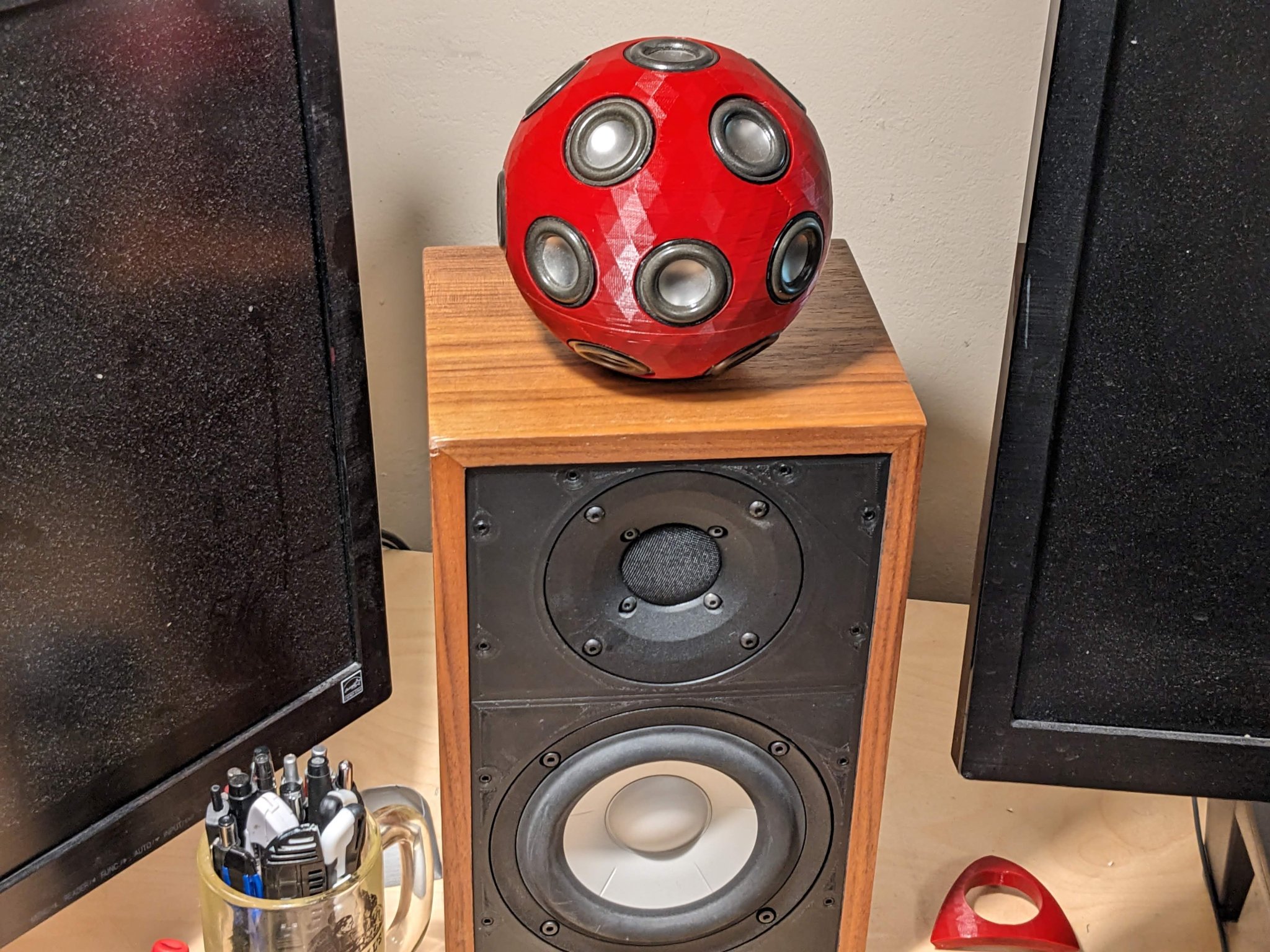

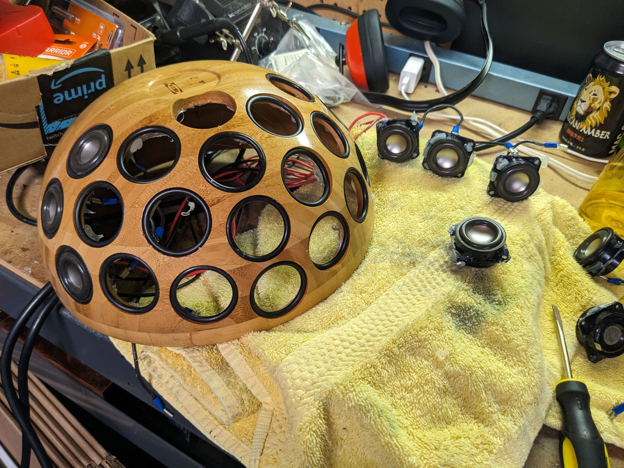

Sacrifices were made. I wasn't able to find a buyer for the Ikea bowls. So the drivers came out of the bowls and went into the newly completed sphere hot off the printer. The trial fit is OK. I will have to file off a few corners on the driver flanges where they overlap. It would be great to get them closer together, but they are colliding on the inside as it is. Now to decide how many channels of DSP and amplifier to use. Maybe four or five for each sphere so I can go between omni, cardioid, dipole or point source settings on the remote control. Lots of work to do before there will be any sound. 20 gaskets to print, 80 screws to mount the drivers and lots of wires.
Impressive.

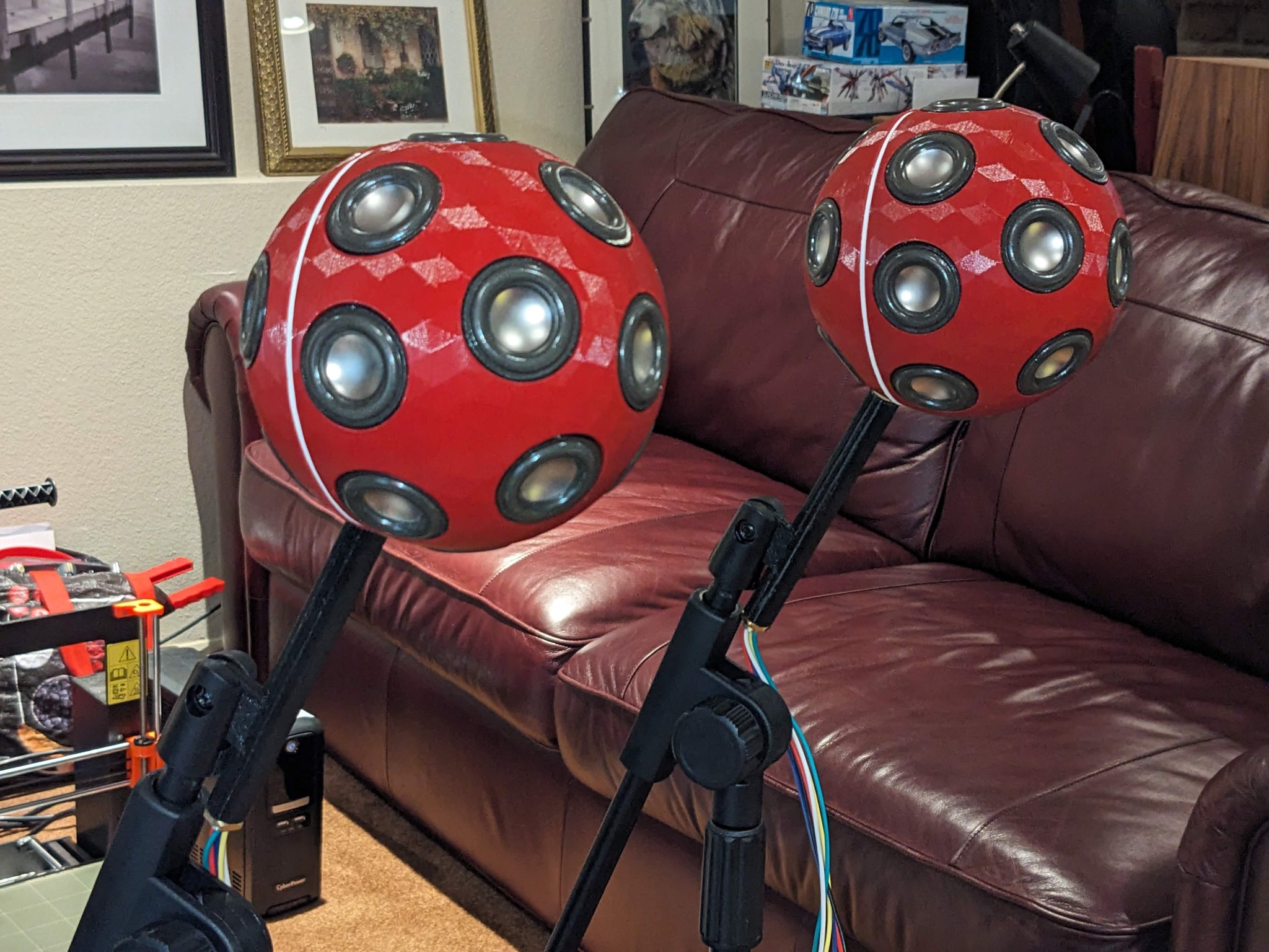

I'm working to get a pair of these done for the Seattle DIY show in Sept. One down, one to go. https://www.diyaudio.com/community/threads/seattle-diy-show-sept-9-2023.402223/
Two spheres in orbit, ready for the DIY show on Saturday Sept 9th, Noon till 4 PM at the Congregational Church on Mercer Island

Time to tune the crossover to the 12" woofer and EQ for the different radiation pattern modes: Point source, Omni, Dipole and Cardioid.
The microphone stands seem to work pretty well.

I was asked to provide a more complete writeup of the sphere speakers at the show, so here it is.

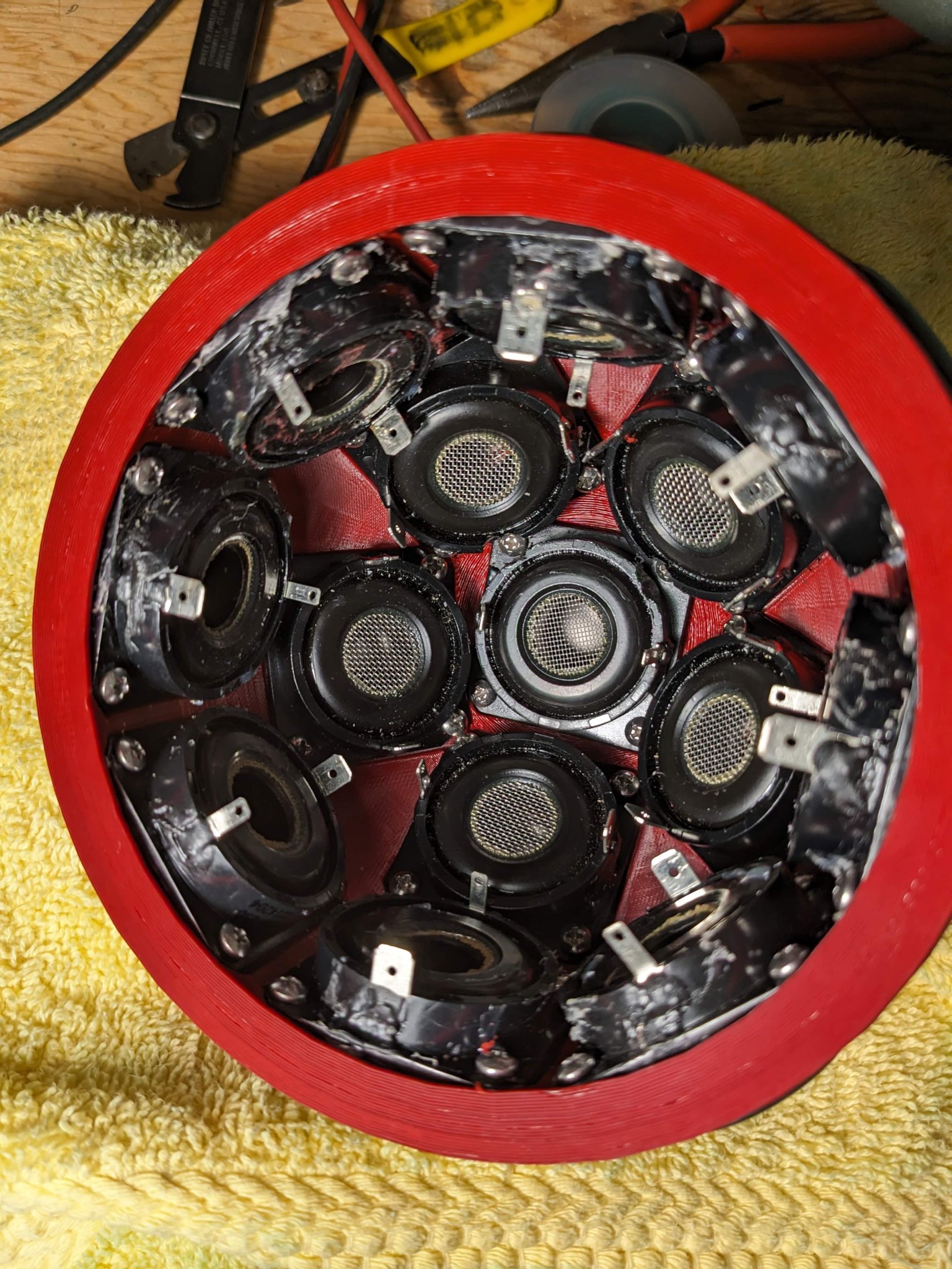

The sphere drivers are wired into three groups. Front cap of six, middle ring of eight, rear cap of six.
This produced a narrow dispersion pattern to the front.
Cardiod was produced by inverting the phase of the rear cap and delaying the signal to the rear so it time aligned with the wave from the front as it came around the sphere. This worked well until I applied equalization to the front cap. With some EQ of the rear cap signal the cancelation to the rear should be nearly perfect.
The 6" size of the sphere results in the predicted high frequency roll off that was compensated using the PEQ filters in the miniDSP. During demonstrations no one commented on the roll off above 15 kHz. A small moon with tiny tweeters could be made to orbit this planet to fill in above 15 kHz.
All the comments were very positive from the 15 or so people that listen to the speaker at the PNWAS DIY show yesterday. \The shaded omni and the omni settings seemed to be the favorite as they produce a huge image at the end of the room. I found that getting the playback volume was critical to producing a realistic effect. If the vocals were at a level that could actually be produced by a human standing in the room it was amazingly realistic. Too loud and it sounded like you were standing too close to the singer and very weird. The balance of the singer to the instrumentation worked better or worse with different recordings. Pure instrumentals were more forgiving of level but is is always tempting to turn it up too much and then get blasted later in a song.
