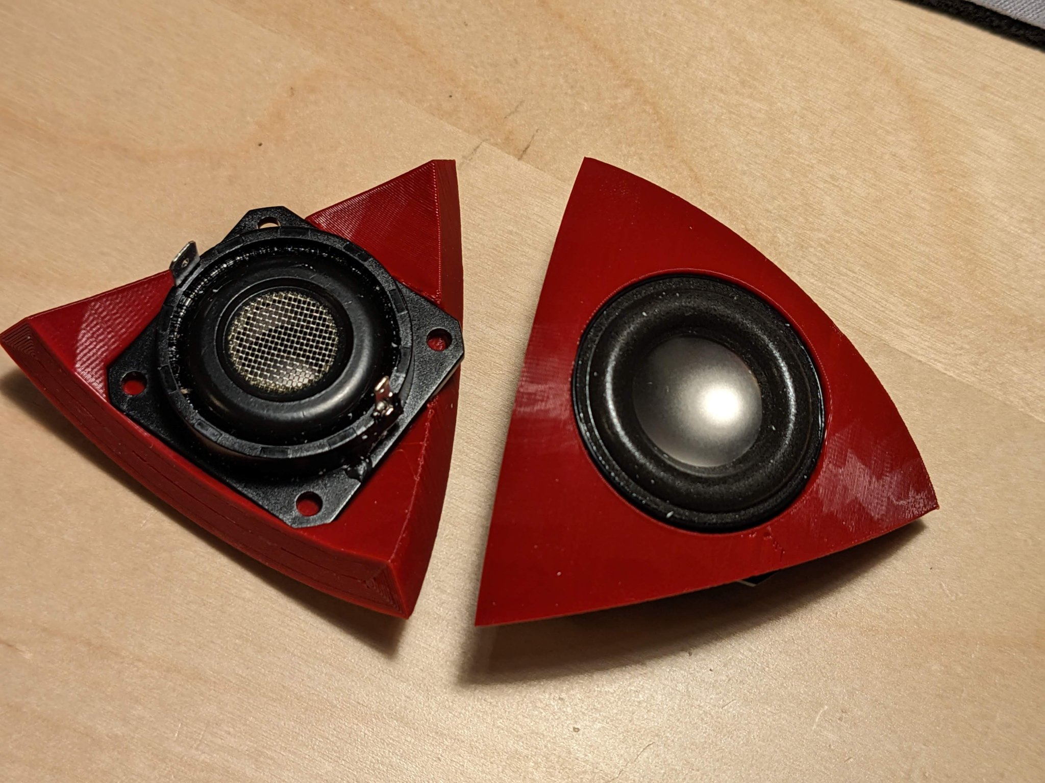

Unfortunately "How to build a spherical speaker?" somehow became a few pages on how to build and 18 pages of arm chair discussion of "what's wrong with spherical speakers". So to spice things up, here's an example of how to build a spherical speaker. I believe that Dave of Planet10 mentioned long ago the icosahedron. How about icosahedron segments of a spherical shell with a driver in each segment. These are nice as the segments are identical equilateral triangles. That makes for twenty drivers to fully populate the sphere. I made a drawing and printed two segments designed to squeeze twenty Aurasound 1" drivers into a small sphere. Please find attached my poorly written openScad code for the drawing. I want to make the sphere as small as possible to raise the high frequency roll off corner frequency associated with mounting a bunch of drivers all over a sphere that depends on it's diameter. There are several unsolved problem with this, like, how do you assemble such a thing or how do you take it apart to change a driver that got poked by a finger. Feel free to modify and share the code again here. Maybe the folks that are not actively designing and building spheres can go start their own thread: "All the things wrong with spherical speakers". 😉

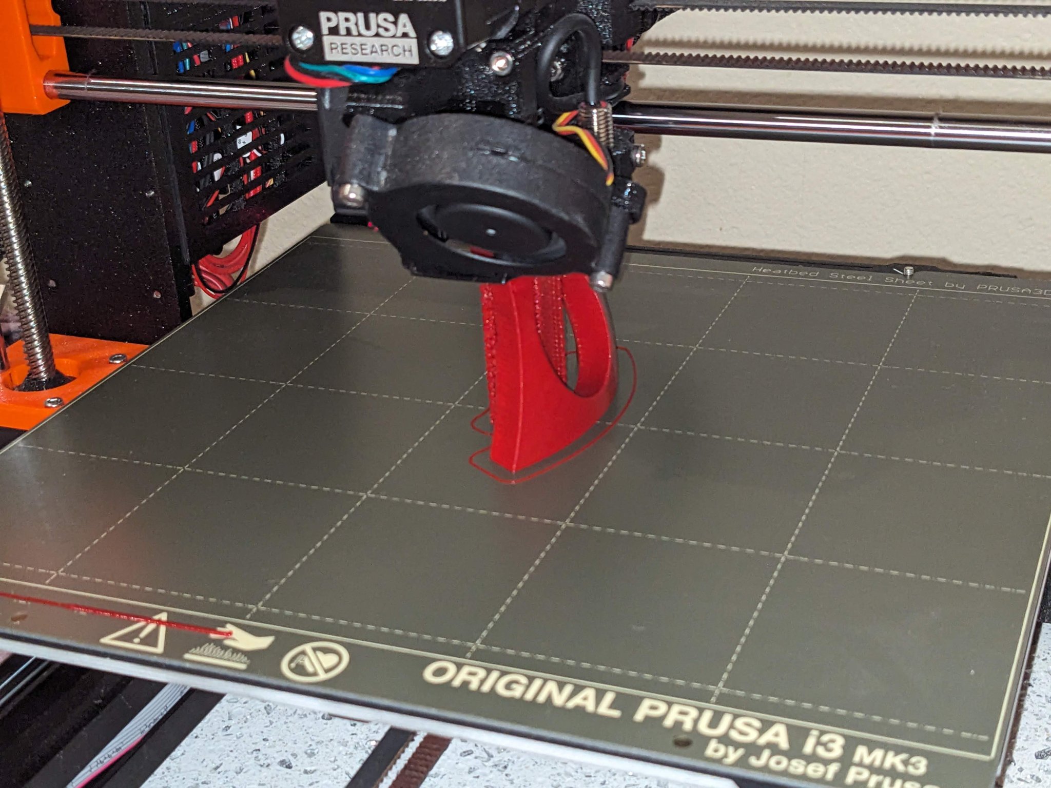

That's 3D printed? Nice.

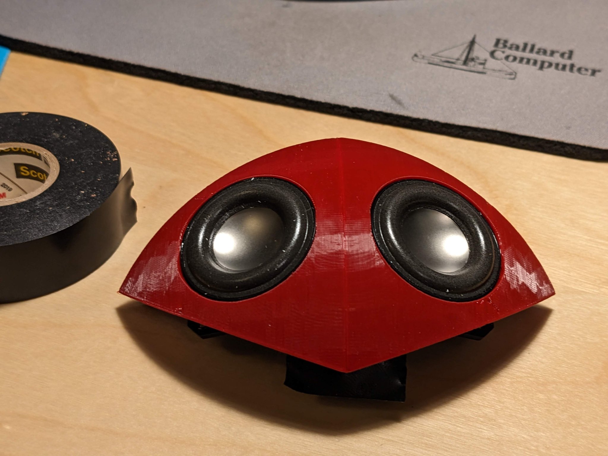

Yes, 3D printed. Print 20 of those triangles and you have the entire sphere. I will attach the .stl file for those that don't want to run OpenSCAD. The sphere might look good with a 3 mm gap between the pieces filled with black silicon holding it together.That's 3D printed? Nice.

How these will sound will largely depend on what signals are sent to each of the 20 drivers. I could go with between four and eight channels of amplification and a DSP to do the filtering and delays, so I can independently drive rings of drivers, and vary the radiation pattern depending on the delays. I should be able to make a cardioid pattern, omni pattern or a dipole at a minimum. It will be fun to swap between them using a remote control for the miniDSP.
Yes there is still the range below 500 Hz or so, below where the Aurasound Cougars can play, that must be dealt with. Maybe some woofers on the faces of a cube. Maybe a single large long throw woofer on the top surface of a half cube enclosure on the floor facing upwards.

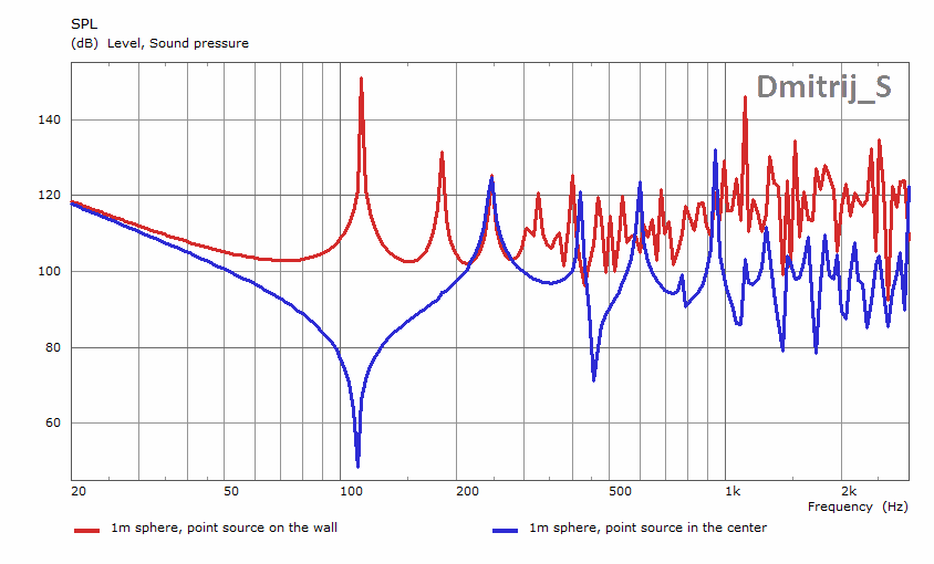

This is incorrect. By placing the excitation source (monopole) in the middle of the sphere, you suppress many of the modes whose nodes are located in the center of the sphere . For effective excitation of spherical modes, it is necessary to place the source on the wall (in antinodes).You need to pump the mode in a spherically symmetric way, an example of that would be from the center.
I made a comparison of source in the middle vs sources spaced around the edge. The results are the same.

AllenB: That is a great observation. It would seem pretty simple to avoid exciting modes like that with any internal reflective baffles or even simple stuffing with fiberglass batting to just absorb the back wave from the drivers. Really exactly the same as in any box speaker design. It would be great if you could share what kind of spherical speaker you are designing or building on this thread titled "How to build a spherical speakers". Unfortunately "How to build a spherical speaker?" somehow became a few pages on how to build and 18 pages of arm chair quarterback discussion of "what's wrong with spherical speakers". Maybe the folks that are not actively designing and building spheres can go start their own thread: "All the things wrong with spherical speakers".

I'm not sure what you want to hear 🙂. I think that you will figure out how to build a spherical box without my help, especialy if you understand some theoretical basics. Nevertheless, I don't build spherical boxes because the spherical shape is not very pleasing to the eye (at least for me).
I was not too lazy to spend half an hour yesterday to simulate a spherical box SPL in a fixed microphone point, excited by a point source in different places (in the center and on the wall). As the theory predicts, certain modes are supressed when the point source is placed in the node (this statement is true in general for all boxes, not only for spherical).
For those who want to play with placement of the microphone and the point source in 1m sphere, i prepared Akabak3 project file, you can run the project in Akabak3, which is free to download. Akabak3 automatically draws SPL graphs, you just need to download and install VACS viewer.
