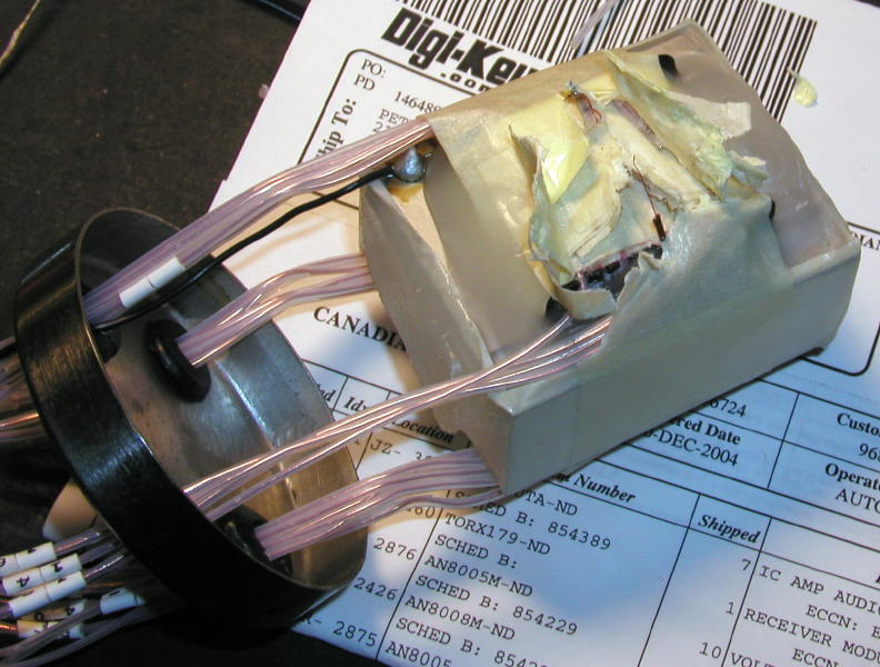

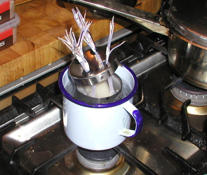

Some of you might be interested what's inside those cans. Well, today I had a chance to find out. After putting preamp together and performing first test, I was quite surprised that one channel didn't perform properly.
Apparently the '+' wire was disconnected inside the can. It's hard to say how it happened, as the transformers are checked after manufacturing, but I also don't recall pulling on any wires too hard.
Since they are potted in wax, this is the first step to do 😉

As you see, black wire is soldered to transformer's core. There is another wire without label, marked as internal screen, but in all excitement I forgot to check where it's connected. It doesn't seem like anything is attached to the cans, but somehow they show connection with the screen.
