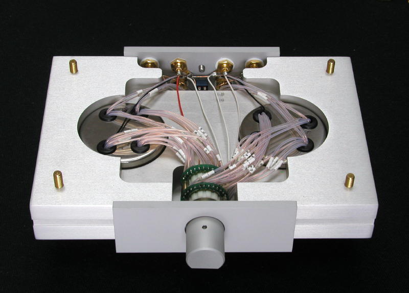

We use 1 3/8" aluminum platform, CNC machined, brushed and anodized. Material here definitely has importance on the sound, and my first impresion, comparing to acrylic, was that aluminum chassis was sort of midbass "heavy", but I have to do more comparisons to come to any conclusion.
I wouldn't dare to try copper, brass or bronze, if not only for high price of those materials, much harder machining and finishing. I also noticed that too much of those materials make for sort of too damped sound, less air, and for that reason we stopped using copper bar in the monoblocks and switched to aluminum.
The transformers are sourced from Bent Audio, and it comes with custom made OCC copper magnet wire and continous cast pure copper lead out wires.
Elma switch was always working well here, and the open deck design simplifies attaching the wires.

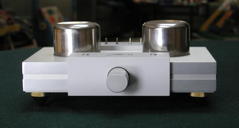

This product was basically developed here, on a forum. I posted first pictures as I was practicaly working on a prototype, later it went through some different revisions and cosmetic changes, and now it's fully finalized, with finish and looks matching the big players in a marketplace. Yet, it's still different than almost anything else out there ;)

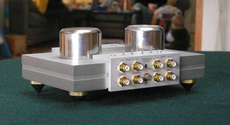

Hello Peter,
looks really nice now; the lesser colors make it easier to look at it for a longer period of time ... I would wish to see some feet (spikes) matching the quality and look of the preamp and the gorgeous knob.
These gold spikes look like $1.00 speaker spikes from my electronics supplier next door ...
Cheers
Christian.
Absolutely...I thought the same thing...with the fewer contrasts...it looks really classy...the only thing letting it down are the spikes IMO.
I noticed that gold spikes are a big no no with Europeans. Here, in Americas, nobody's really complaining ;)
Those are quite nice, definitely not $1 variety, and they match RCA jacks. I was already thinking about powder coating them in some nice color (as making the new ones would be too expensive, considering the original cost of those).
