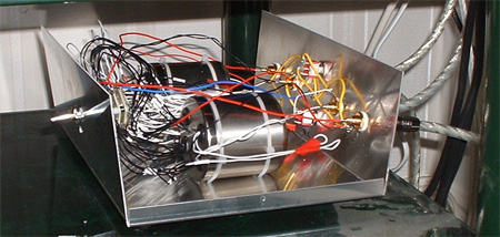

Hi All,
I whiled a few hours away today putting a simple prototype together. Cheap alu case, inexpensive RCAs, but I used the Seiden - a minor adjustment for 23 positions. 0dB gain, standard wiring, nothing special - I did omit the 0 dB tap, so I could implement a mute (to earth) at the other end of the scale.
No hum, worked fine first time . Didn't cut the wires because I was wondering if that would change the length of the secondaries (unless each channel was cut the same length) - perhaps I'm being a bit precious..... .
First impressions after the 5 mins I had to try them as my system is underneath my kid's room - smooooth, detailed and open. I am intending to take a power amp away with me this coming week and run the TVC with a cd source on repeat - all week! Power amp with no speakers connected and the TVC volume on full. IIRC, this has been suggested as a good way to run the 102s in. Any thoughts??
Thoughts turn towards getting the proper chassis designed - glacially slow but I will get there eventually.........
Just to horrify you with my handiwork, here's a photo:
