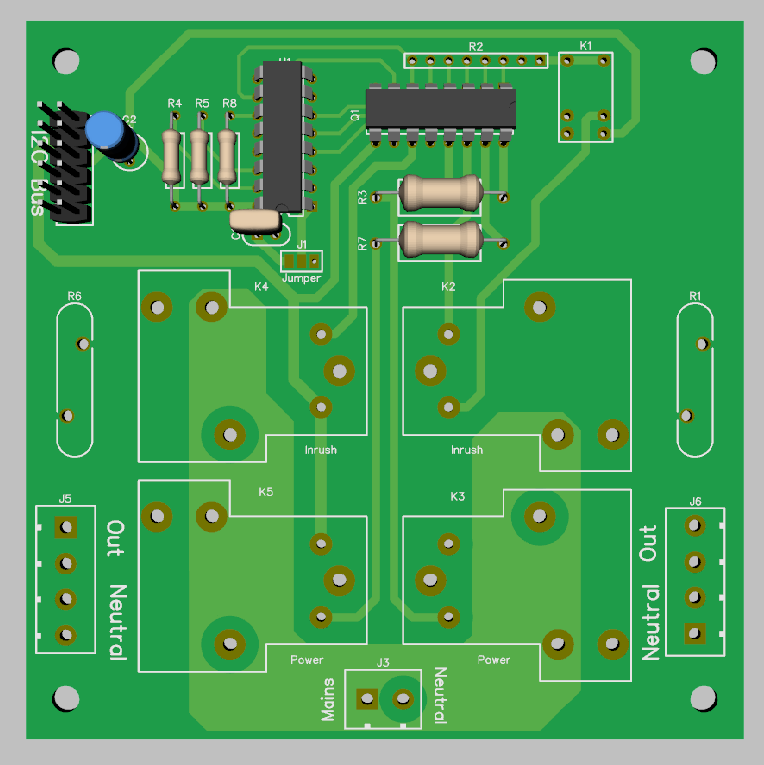

I2C controlled power relays is next. I've designed this one to independently run dual power transformers.
  • DipTrace Schematic - Power Relays 3.1.pdf

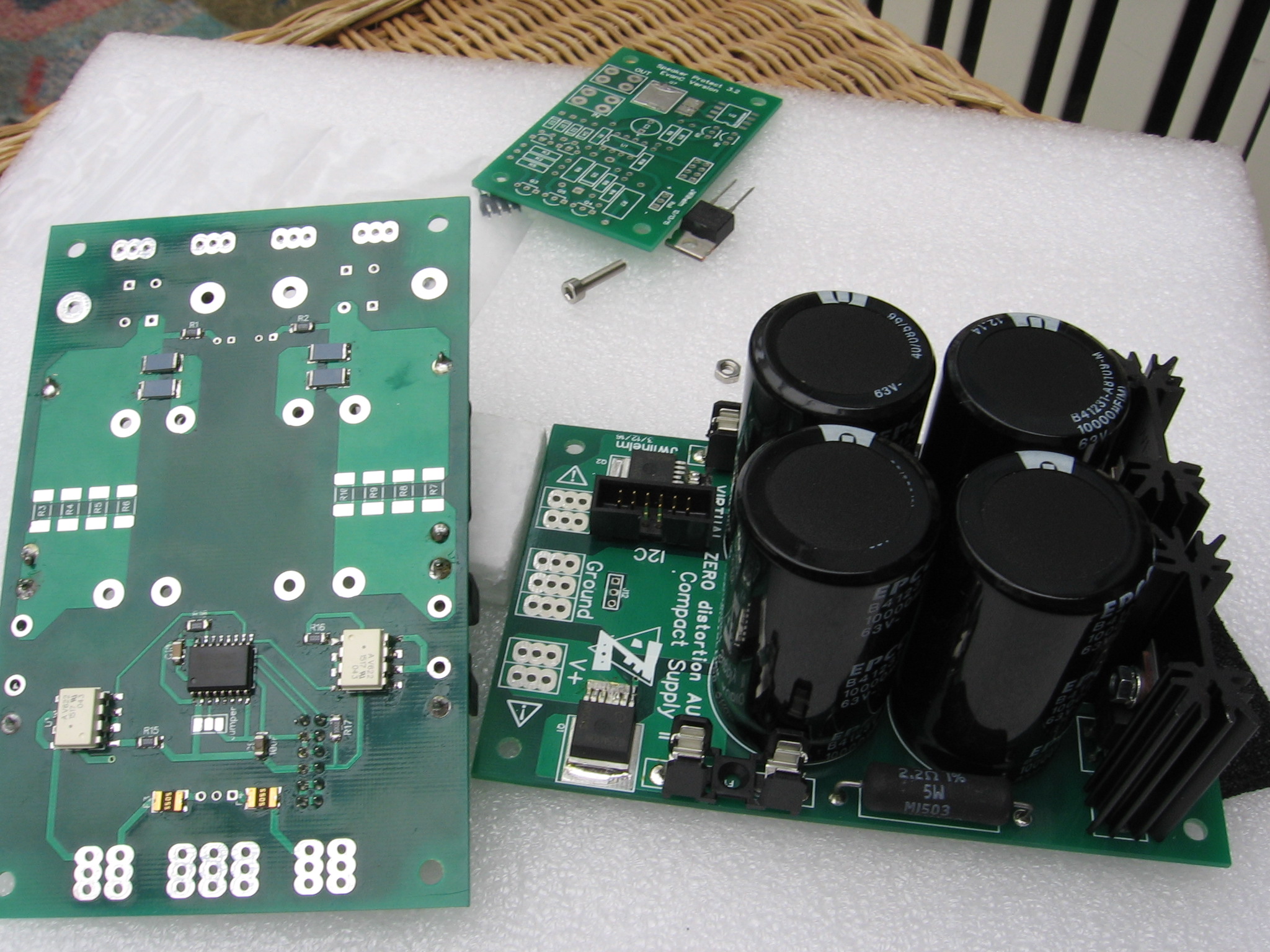

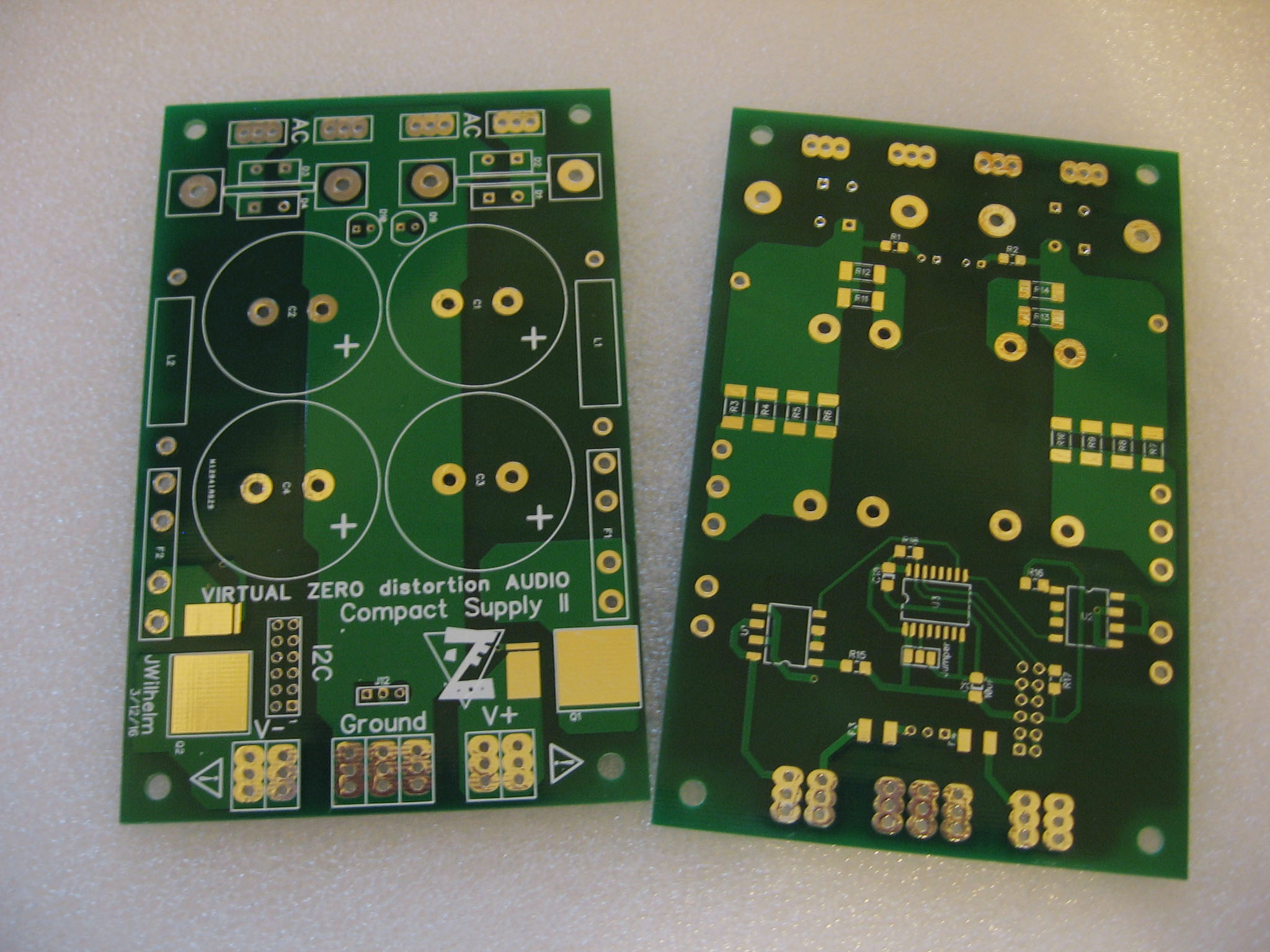

VZDA Compact supply Mk2 boards have arrived from PCBWay. Thanks Jeff! Going to have to hit you up for the firmware for these - you mentioned the device address will need to be changed along with the selection jumper pads to allow for a dual supply?
Next generation power supply will be in effect when Mouser delivers.
Actually initial tests with the Tubsumo will be with a standard cap filter supply then eventually Jeff's protection system will be incorporated when prototyping the enclosure layout.

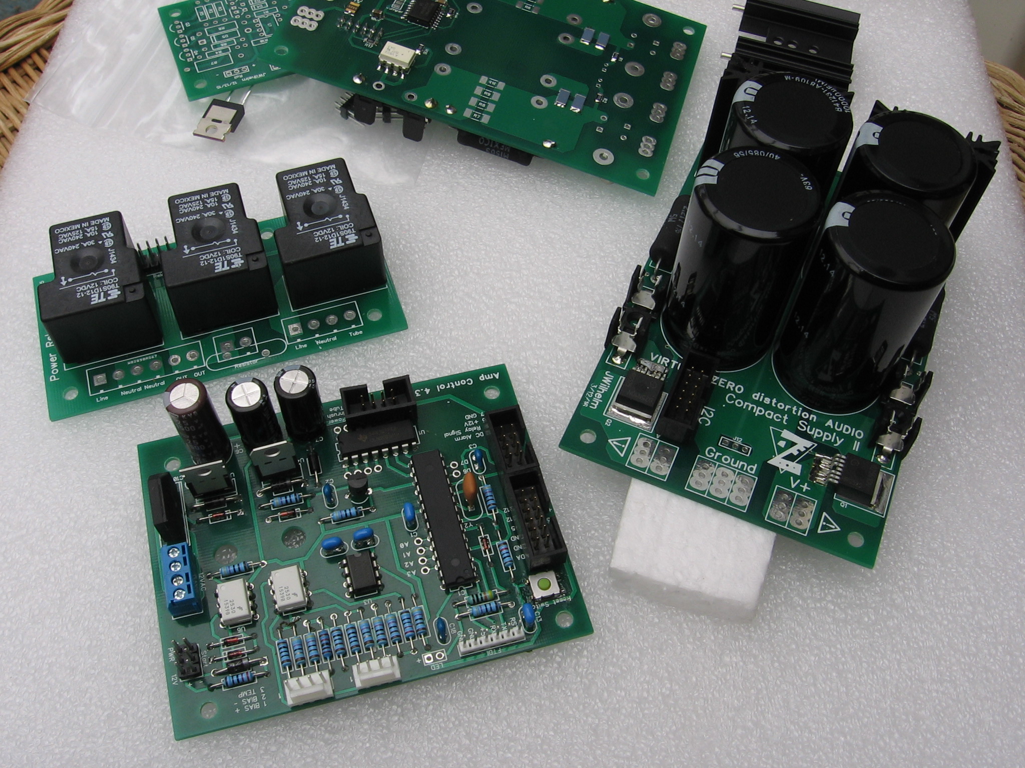

Almost there as far as PCB assembly is concerned. As usual I am obsessing over connectors. Always looking for the best professional wire to board connection where possible, preferably pluggable and lockable/polarized for small signal stuff.
The control modules will be linked by IDC ribbon connectors where possible and the relay board will have Phoenix pluggable terminal blocks, the orientation of which is undecided yet.

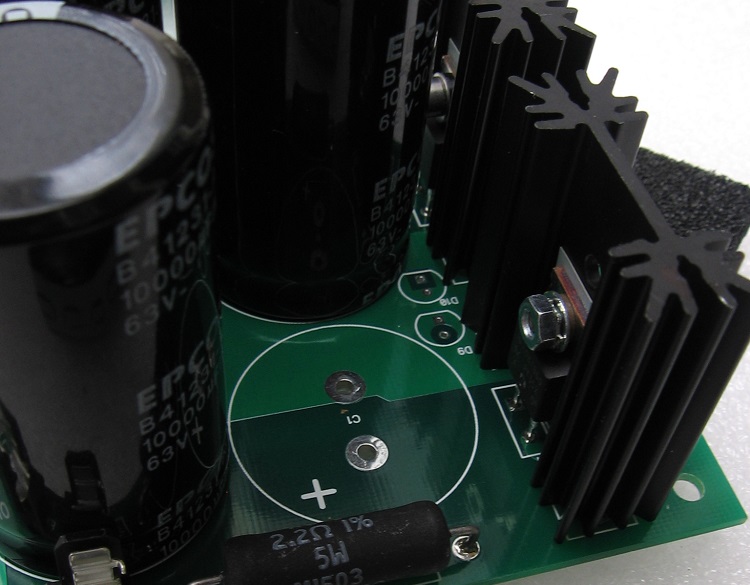

Jeff - The supply boards are lovely, I guess I backed myself into a corner in some areas: the 2512 CRC resistors can be expensive so for this trial I have used 5W 2R2 wirewounds which were salvaged from the parts box. Your original idea of a pair of TH resistors is better and certainly more economical, but one could be on the underside offset to the top one if you get me.
Capacitors with 63VDC rating and 30mm dia can be difficult but EPCOS B41231 series are ideal here.
The discharge indicator LED's are in a very tight spot between the first caps and heatsinks, in fact 3mm LED's are needed here or they should be moved to the outer edge, parallel to their current position (4th pic). As it happens I may run the LED's from headers/leads to the front nicely showing the amp power down.
The higher the diode voltage drop the better with these LED's really?
Can space be made on both the main control and relay board for connection together using 8P IDC ribbon connectors? The control board can fit an IDC board header with a bit of hacking to clear the pins of U1 but unfortunately there is no clearance on the relay board between U1 and U3. It would mean increasing the board dimension by approx 3 - 5mm.
I had something else, but have forgot... anyway these are mere suggestions Jeff, everything is superb and I'm more than happy and anxious to get all this pro electronics working.

Check out Newark/Farnell for the 2512 resistors. They have stock reduction blowouts regularly and their house brand Multicomp resistors are inexpensive and good quality.
Nichicon has 30mm caps in 80V.
It looks like the model I drew for the heat sinks is a little small. Anything is fine for leds. I'm not sure if you would want them showing on the front panel of your amp. They stay on for quite a while after power down because your rail feeds will shut down when you turn your amp off. The only thing draining the supply will be your bleed off resistors.

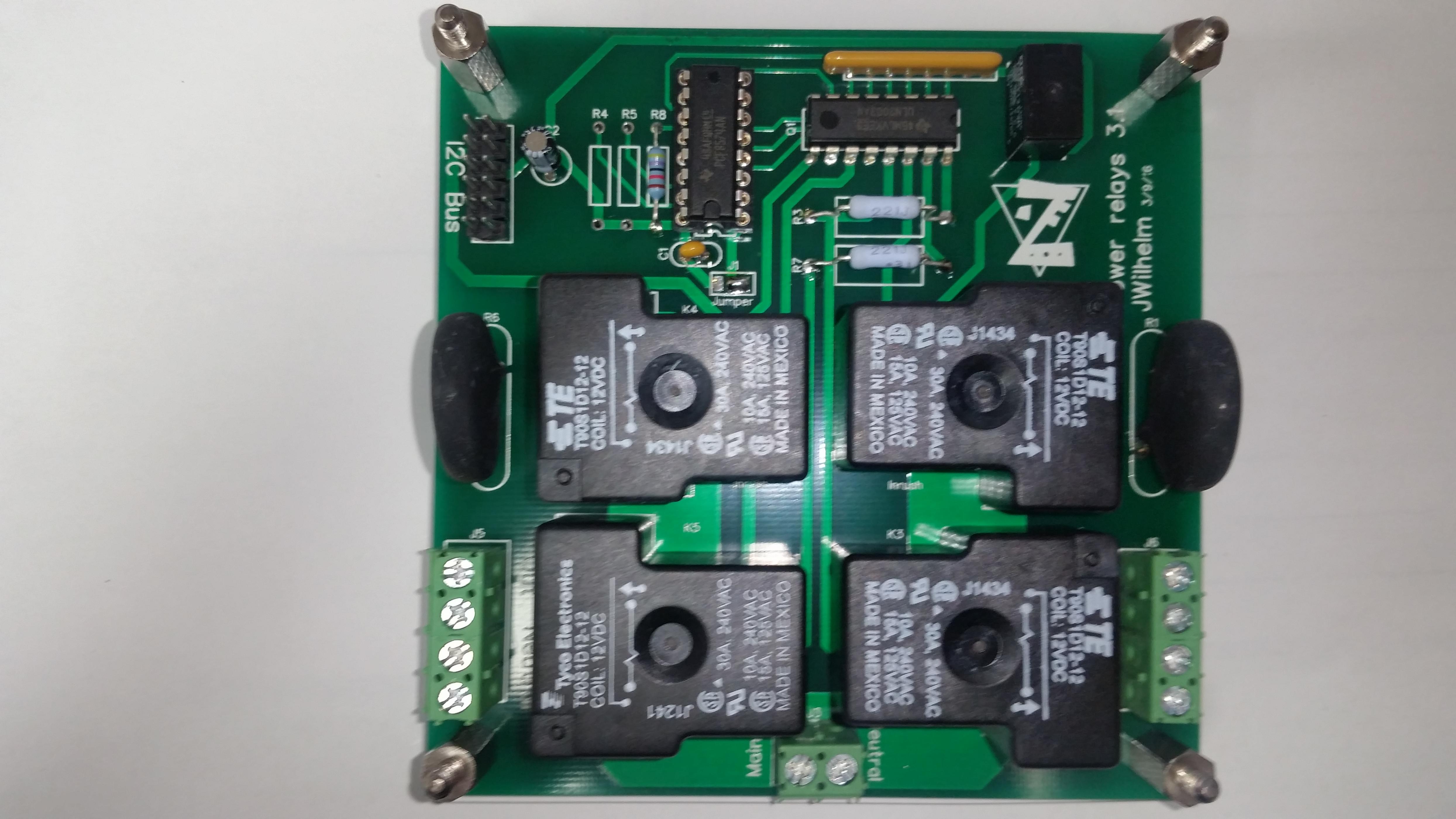

That relay board is meant to plug right into the control board with right angle connectors. It was layed out to stack on Ostripper's modular supply. I'm going to design a series of I2C controlled relay modules for connecting with a ribbon cable, when time permits.
I2C ?
