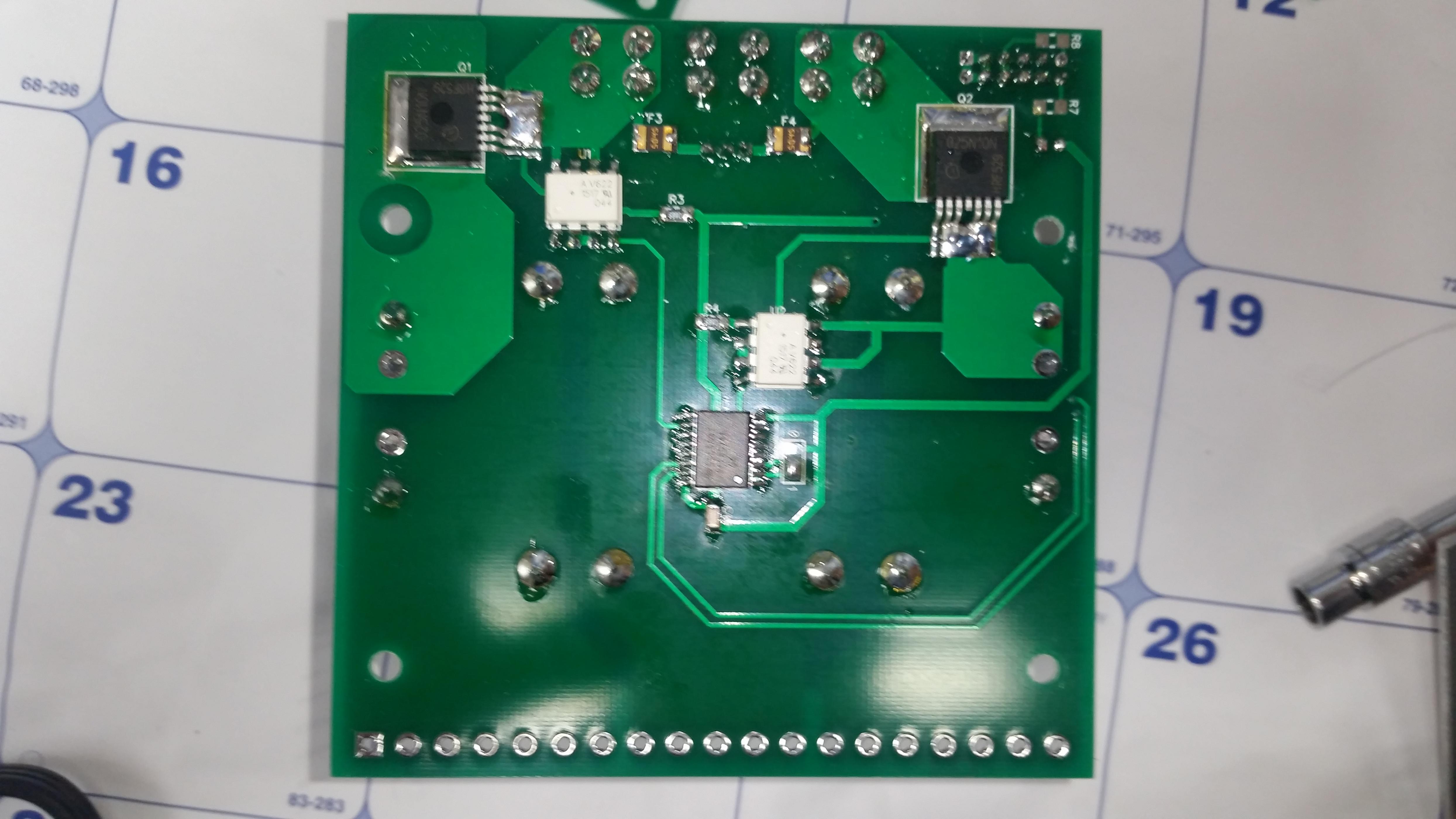

Finally had the time to get the first protection set working. The only thing I can't figure is why I waited so long to implement this solution. Huge thanks to jwilhelm for all the help and to vzaichenko for the ideas. Now to collect the parts and do the other 5 sets.
Did the speaker relay work out okay? I've never built that version yet. The protection system does get a little expensive, but it's money well spent to protect those monster speakers you are running.
The speaker relays seem to be doing their job. the surface mount parts were easy to solder. I put the first set on a tubsumo +- 70 volt rails. With a test speaker hooked up I turned off power to the whole system at once. This would usually have ruined my mids and tweeters as the preamp turns off a lot faster then the power amps. There was only the tiniest click from the speaker. I have not tried disconnecting at full power. They will probably have more work to do disconnecting the five pair slewmonsters.

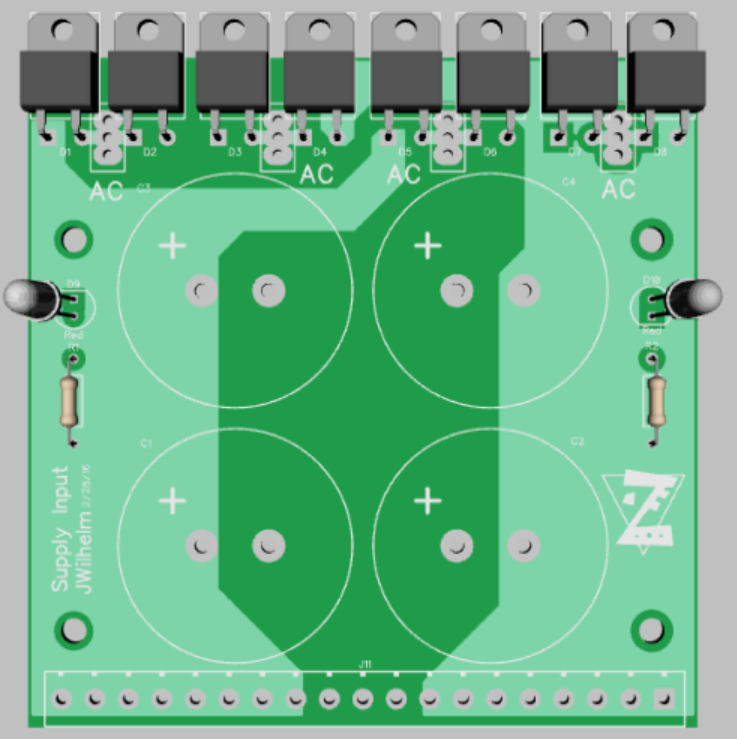

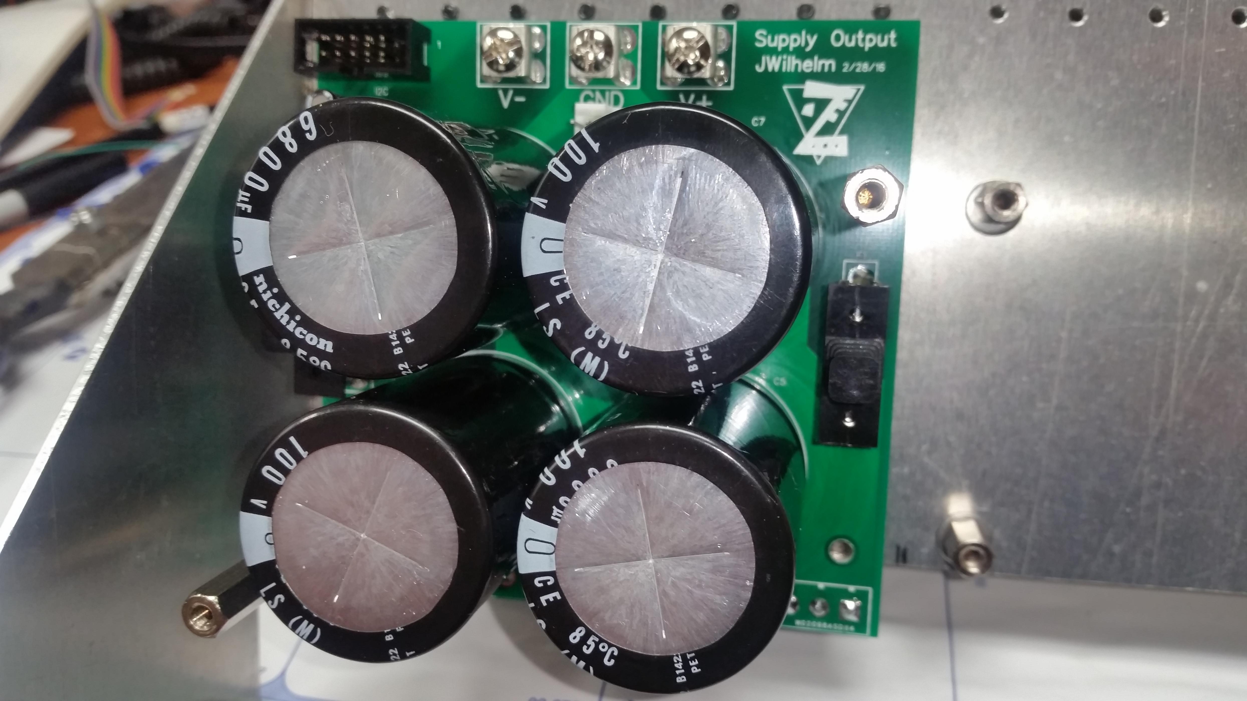

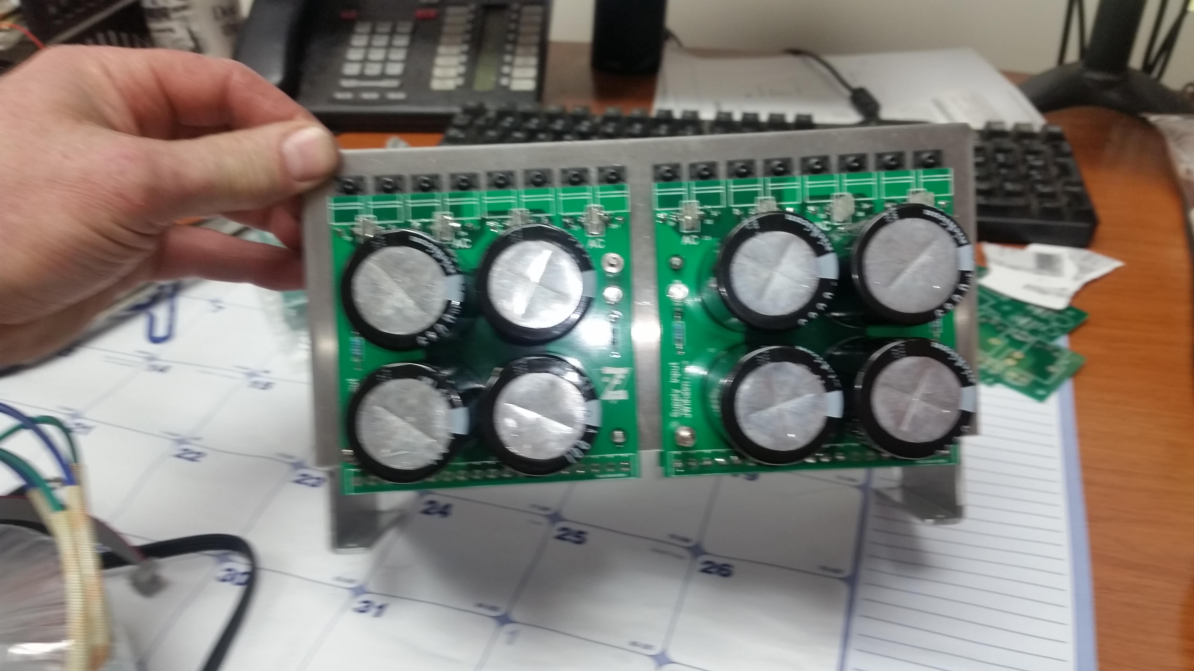

I've got a new evolution of the supply with rail shutdowns in the works. It's I2C controlled for easy connection and has an output header on board for feeding the remote speaker relay. I didn't like the fact that we were feeding the speaker relay from a huge cap bank, so I added onboard self resetting fuses to the header feeds. It also has onboard rail fuses for the main outputs (at the supply where they belong!).😀

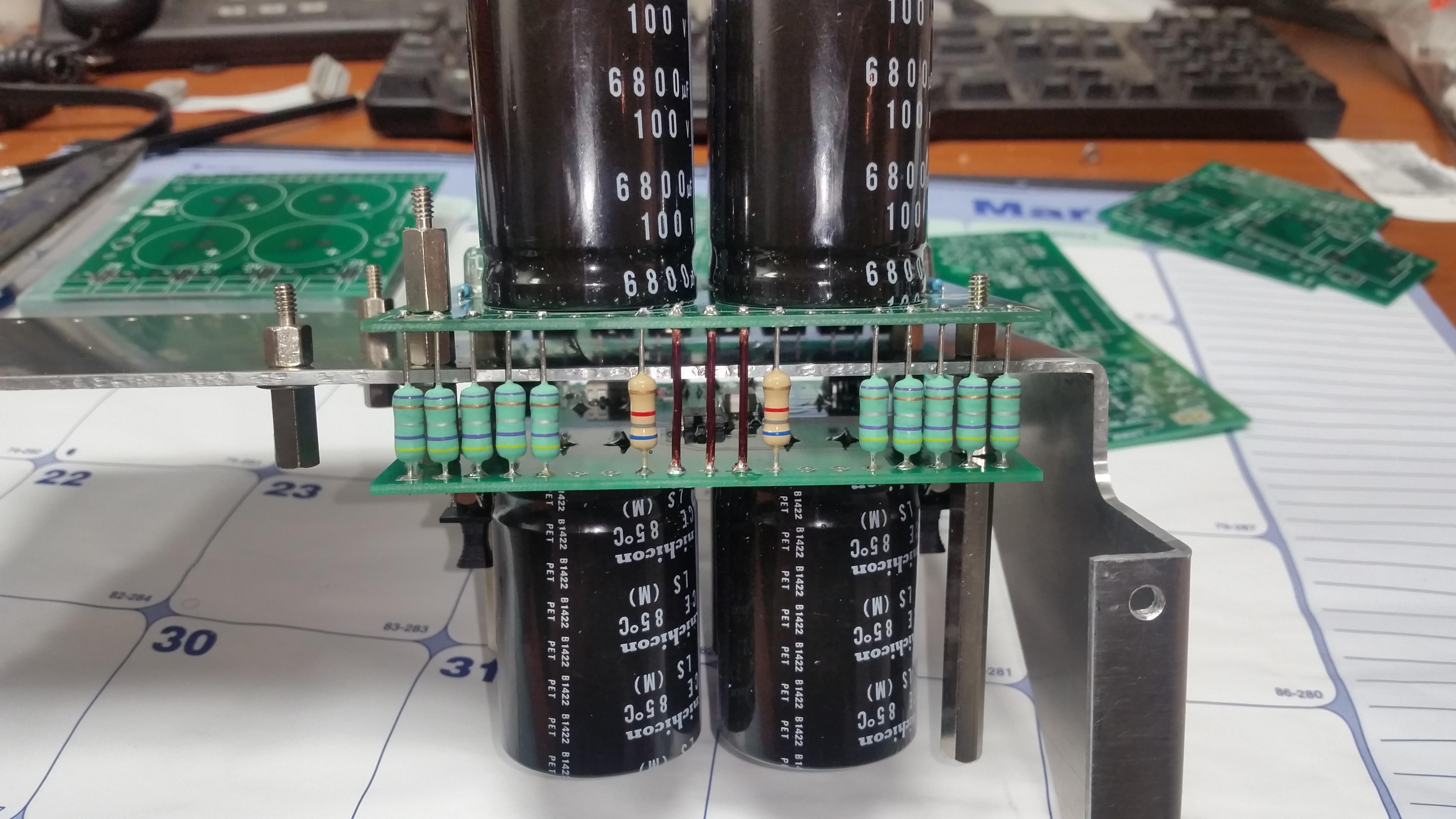

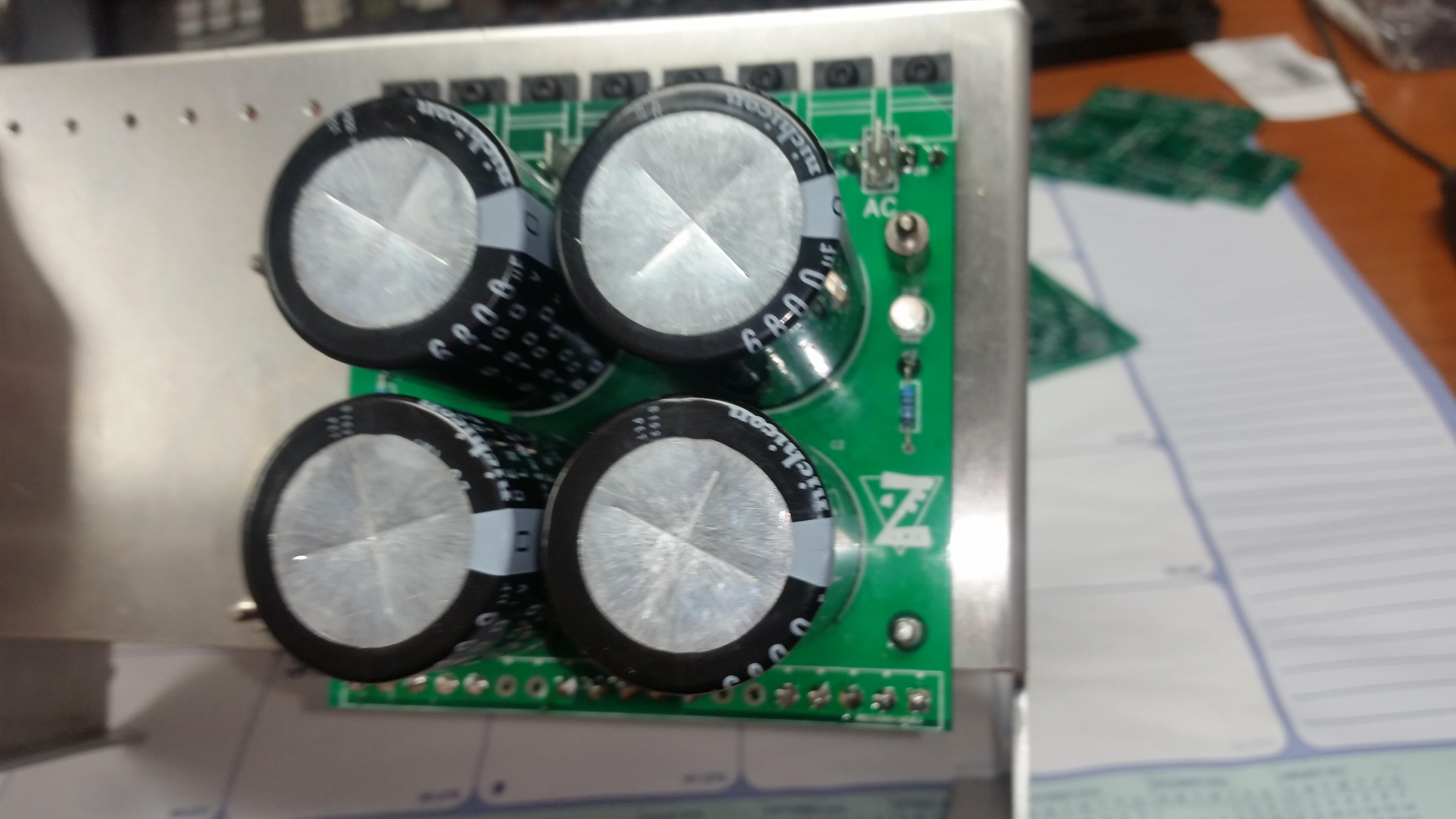

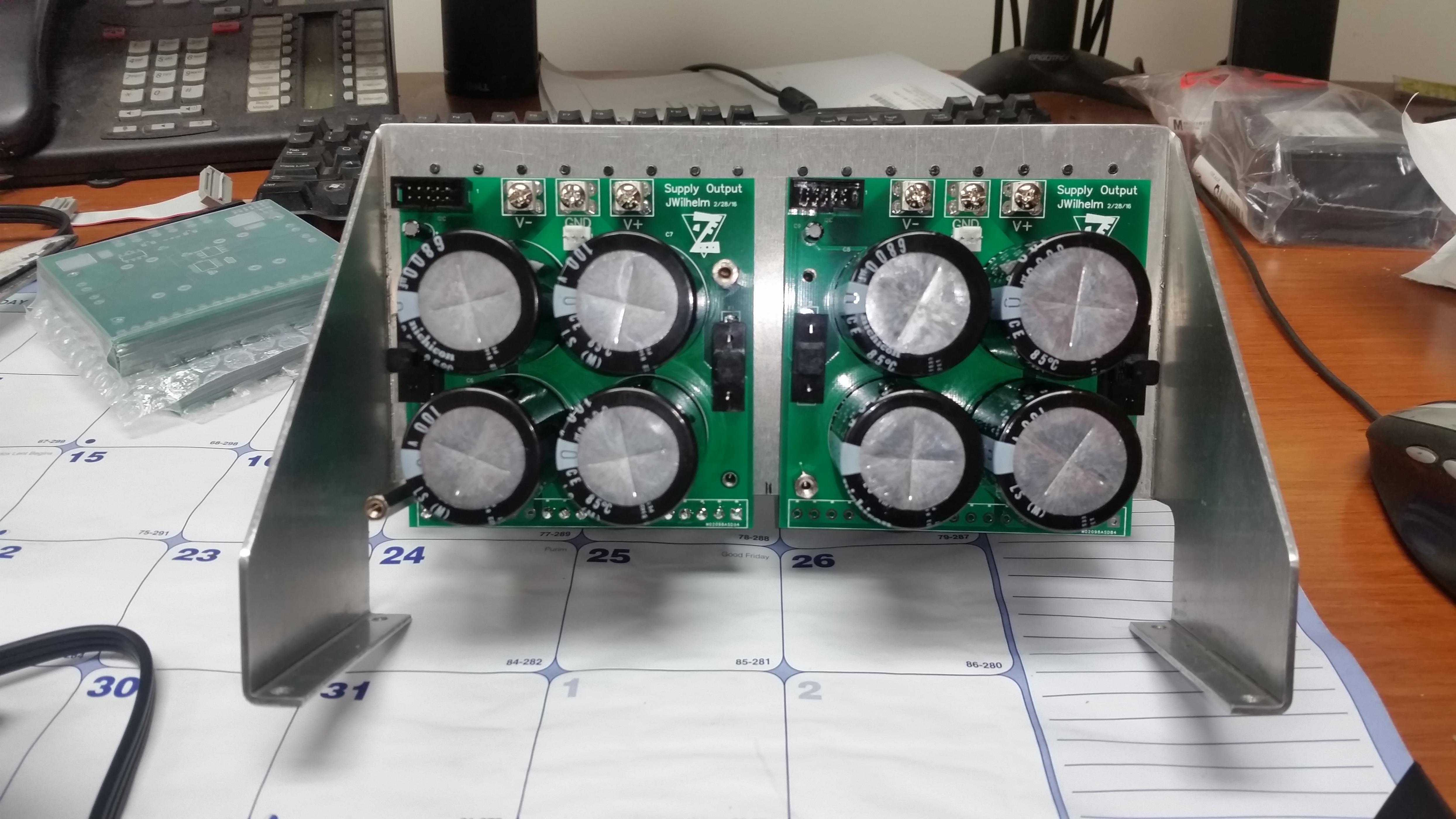

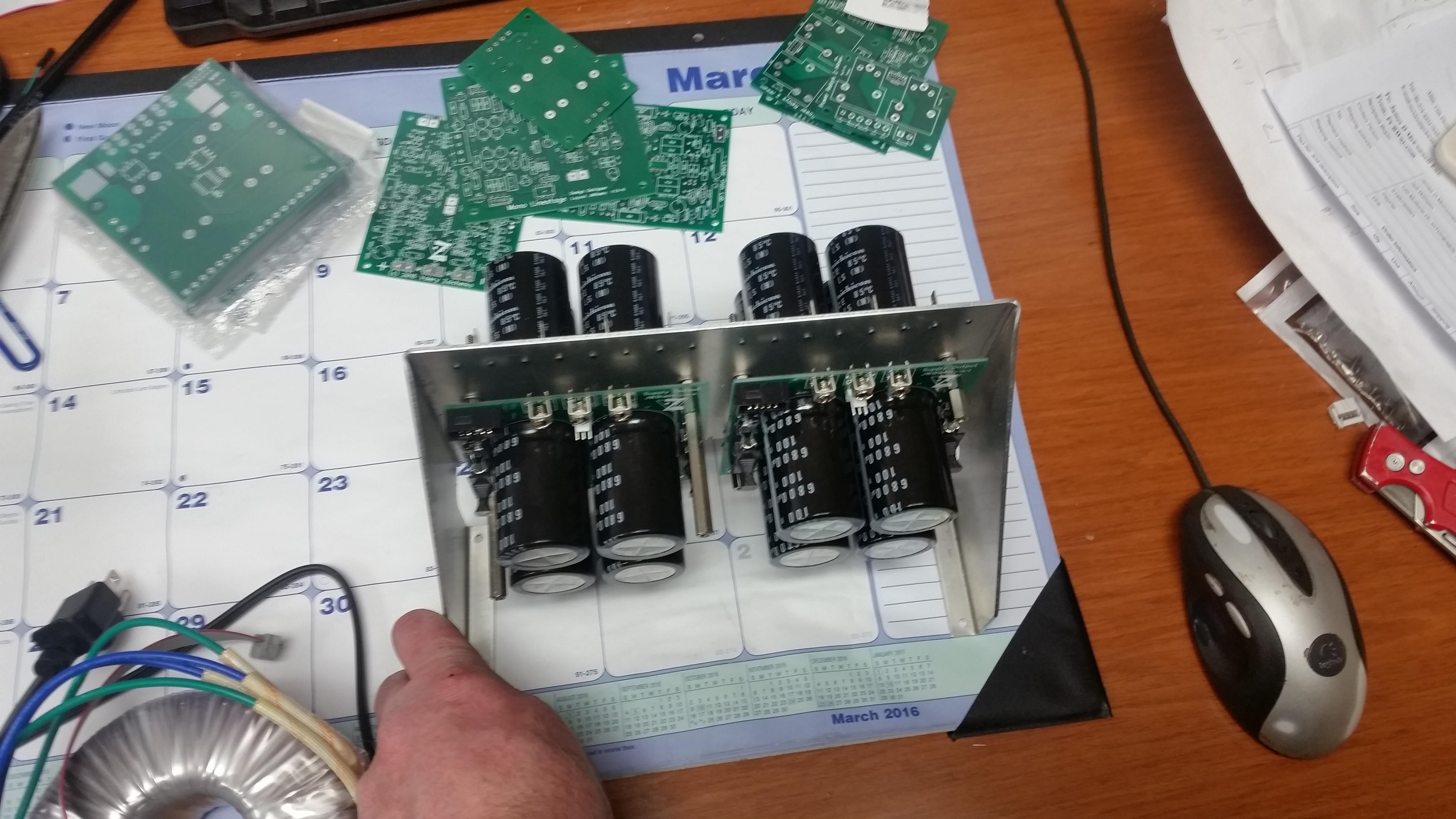

This one's designed for mono-block amplifiers, but is compact enough to fit two in a single chassis with a little ingenuity. The supply consists of two boards, joined together by resistors to form a CRC supply. They should stand on end back to back nicely.

100V caps are getting harder to find in snap in leads. I had to come up with a way to get lots of them in a small area for my latest amp build. That's what inspired these.
Those pads at the bottom aren't all CRC resistors. There's three ground jumpers and two bleeder resistors in there too. There's room for seven 3W CRC resistors per rail, which should be plenty for a single channel.
The protection board saved my butt the other day. I put the lid on the amplifier while it was switched on. The lid slipped and shorted the speaker output.
There was no drama. The channel was shut down and the mosfetrelay disconnected the amp without a noise from the speaker. After reset the amplifier was working as if nothing had happened. 🙂
