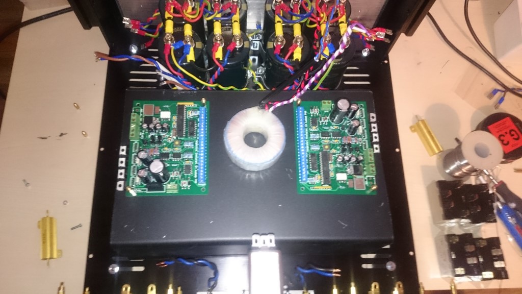

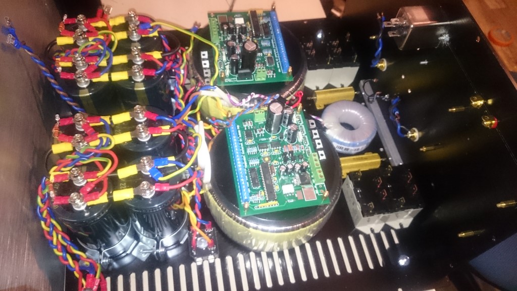

I'm rebuilding my amp with the protection boards, it's going to be tight.
I didn't want to hide the trannies but I can't see any better solutions that leaves enough space in the back to replace the IPS and adjust bias.

Hi yngvejos,
In fact, using two control boards makes sense if you have separate compartments for the amps. In your case of dual mono, you can easily use one board for both channels - it will monitor them independently, so that they will not influence each other through the control board.

Won't one board mean Connecting the psu grounds together? Now they are floating indepentently.
Anyway, I like the idea to control the startup of the two transformers indepentently so that I can put a delay on one of them to reduce the load on the mains circuit breaker. Also it's nice with one error indicator per channel. 😉

Using one control board will connect the grounds of both amplifiers together. Won't that leave them more susceptible to ground loops?
