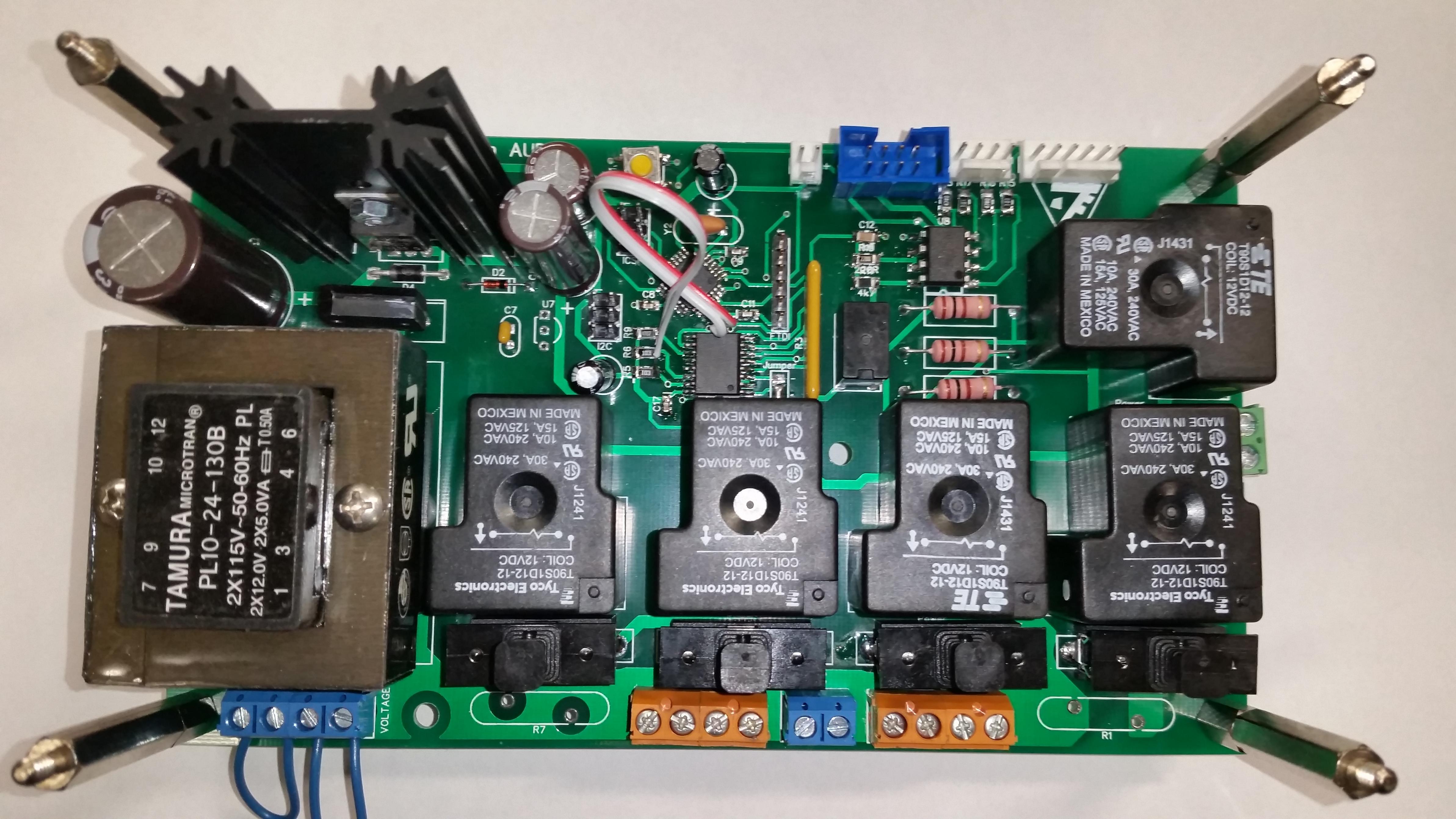

I haven't made the full plunge to I2C control yet. The speaker relays are still connected to a digital interupt pin. We're nowhere close to bogging down the ATmega from software yet, but the I2C bus runs at 100 kHz, and each action is 17 or 18 bits, so if too many devices are added, eventually things will slow down.
The DC protection still has it's redundant self contained shut down and the first I2C command is to shut down the power rails in the supply.
Yes, the "beauty" of the solution - speakers will be saved via the hardware "channel" even if the controller fails - this feature was part of the design from the very beginning.

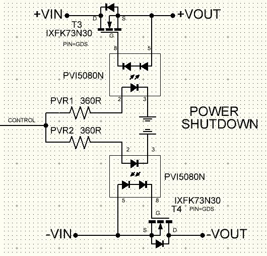

i got some mosfet driver PVI5080N on hand.. is the attach circuit enough to power my subwoofer of 500 watts rms at +/-78vdc rail.
any mistake on the circuit?

Your mosfet drivers are connected to the mosfets backwards. Pin 5 should go to the gate, pin 8 to the source.
It doesn't look like the driver contains fast off circuitry, so it might be a little slow reacting on shutdown.
thank you for the correction.. anyway i found out that these driver are for logic level mosfet (5V).
The PVI5080N is designed to match the gate
characteristics of logic level MOSFETS as illustrated in
this article.

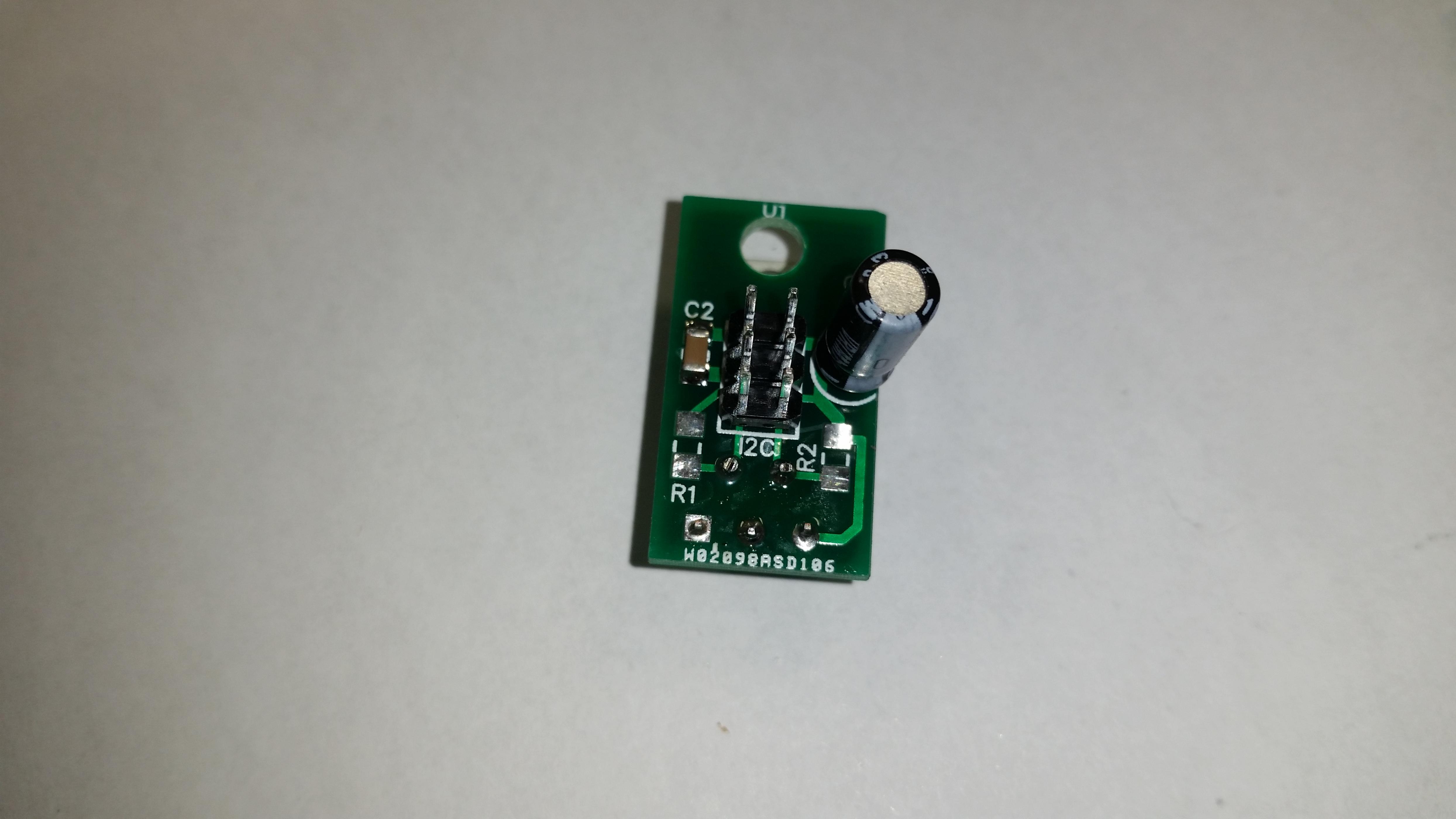

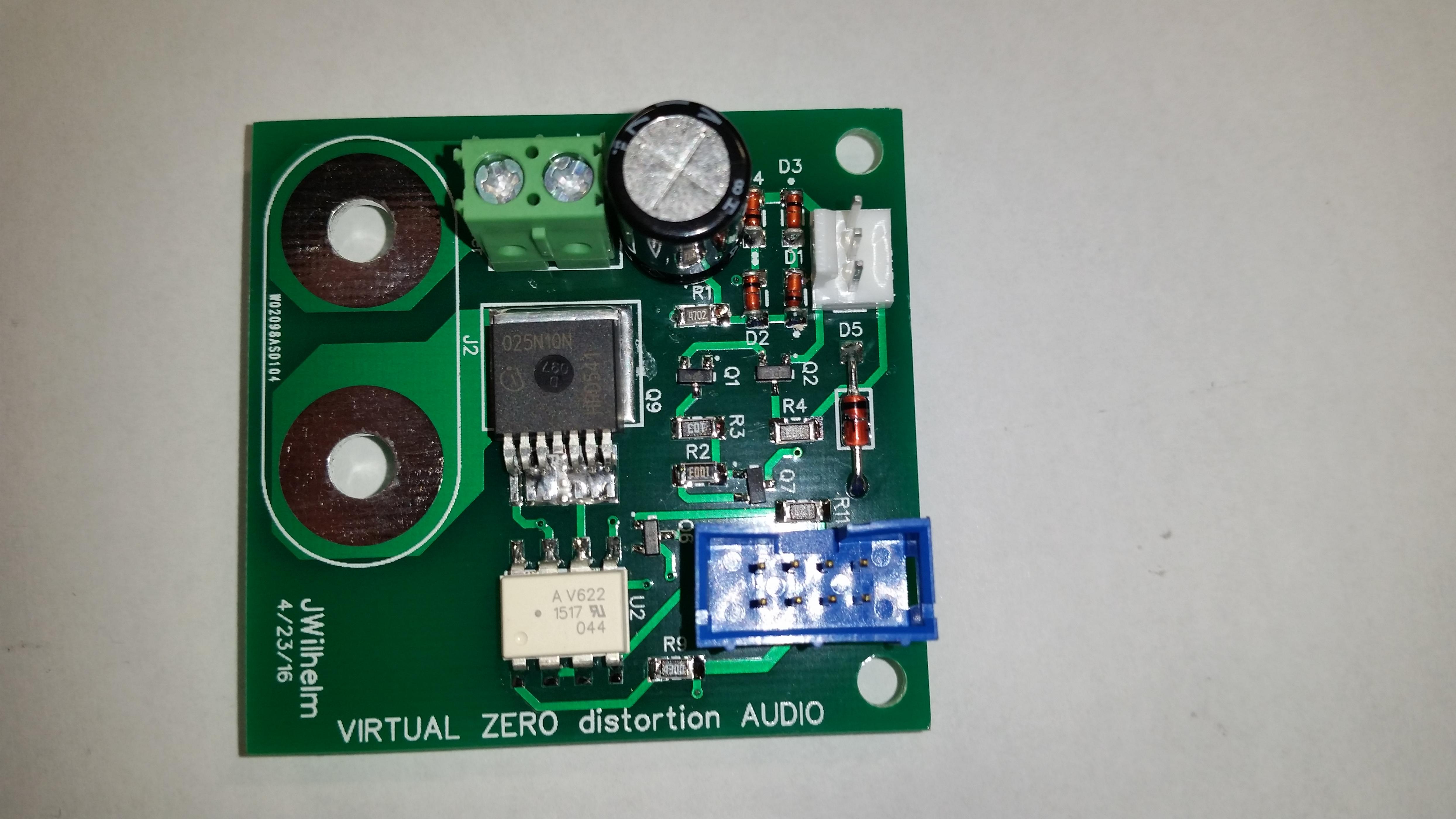

I almost have the next generation of 21st Century Protection ready for testing, but I noticed an error on the control/relay board.😡 New boards are on order.
The new control board will still connect to the previous design speaker relay/DC detection. It can also be connected to a pair of emitter resistors for current sensing, but can also connect with I2C current sensors. Thermal sensing will be strictly I2C. Next step will be integrating it with a singleboard computer for web interface and datalogging. A LCD screen can easily be interface via I2C as well if so desired.
I've designed a 2" x 2.1" SMT speaker relay/DC protection board to go with it as well as a standalone I2C temp sensor board.

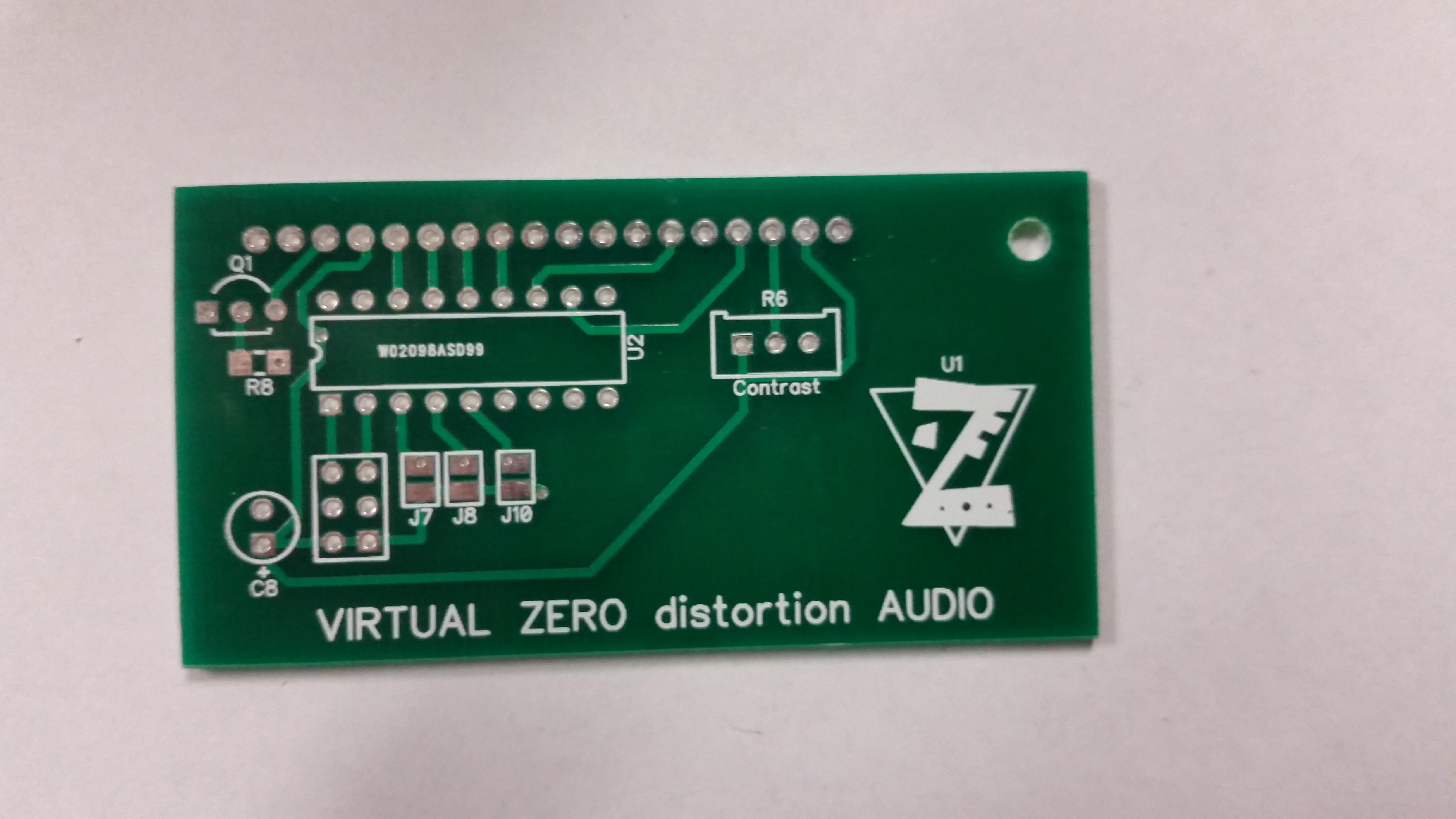

I convert them to I2C on a small daughter-board with a MCP23008 expander.
Here's a daughter-board for a 4 x 20 display that I'm using for another project. It's virtually the same board with screw holes moved.
