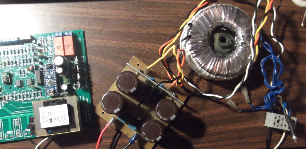

Hi Val. What joy of revisiting all my old analog sensor "blocks".
??? - The AC sense , only have 270K for R8/R9.
Q9 should have enough beta to pull it's collector down with the slight higher Z input ?

270K should be ok - less than 10% difference, no problem
What if I just mounted a heatsink made of flashing across all 4 to-220's.
Actually, the 2 lm78xx regs have a tabbed grounds -good . Dang ! that poor 7812 is
running all those "monster" OMRON relays - big flashing from corner screw to corner screw !!
PS - you run the "monsters" right from the ULN2003 ? Does IT get hot at 158ma
X 2 (both omrons)?

I'm running them on a common heatsink, however - as already mentioned - 7812 is the most stressed component here. All the keys are fully open, so - low voltage drop = low heating, but 12V regulator gets pretty hot... Athough, the heatsink works well, keeping it under control.

I think the pdf is correct. The inrush relay is connected in series with the power resistor and is turned on before the main relay which bypasses the resistor.
There's probably no need to keep the inrush relay active after the power relay is engaged. Possibly a way to reduce the load on the 12 volt regulator.

Hi OS,
Jeff is right - you need the main amp rails to be connected, othervise the offset sensor will not work properly and the startup sequence will be interrupted.
It is assumed that inrush goes first, connecting the big trafo via the resistor, then goes power-on, shortening that resistor, then, after some time, the speakers get connected.
The led is dimmed during standby, a bit brighter during startup and full power when "Ready".
Ah! Jeff, good idea Just didn't think about it. We can connect the main power relay, so that it will bypass both the resistor and the inrush relay. Of course! Then we can switch the inrush off after the main one is on and reduce the load. I will amend the algorythm for this option as soon as I'm back home
This is confusing ? Normally (on my last big amp) ,The main power switch would
be in place of the first relay (on the left) , charging the caps through the resistor/trafo .. then after a few seconds the relay in parallel across the big resistor would engage
-allowing for the full deadly power supply (after the caps charged).
On my analog version , I used the rails to charge an R/C triggering this relay (3 sec.).
Hook em' in parallel !! then just reprogram the sequence ...
So , relay 1 + resistor on (soft start) - then relay 2 on after inrush (relay 1 then turns off) - saving 158ma. Good thinking , J !
