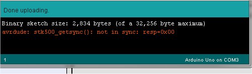

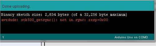

Open your device manager and see what port your computer installs the Arduino on. Usually the default is port 5. Have the Arduino window open and disconnect, then reconnect it. That usually that helps the software find it. Also make sure you set the Arduino board type under tools. It should be a Nano 328.
3 is default on my virtual com port.
os
This procedure worked for me hoped it does for you.
1- Do not connect the USB cable to Arduino.
2 - Open Arduino IDE and open tools/port -- check how many ports it's shows
3 - Close Arduino IDE.
4 - Connect the USB cable to the Arduino. Wait few seconds to allow driver to be installed.
5- Open Arduino IDE open tools/port - select the extra port that it is showed.
If you do not see the extra port then Arduino it is not installing the right driver for the USB.
Window locks and reserves the com for other usb devices - registry key will clear reserved com's ...
Got it to communicate on com 3 (no error). Now I get (below) ....
OS
That's what it says if you are on the wrong port.
First I downloaded the full arduino software , it would not properly recognize
the device.
Then val told me to get the latest FTDI drivers , device is named "usb serial device
(com3)" and windows says it is working properly.
The actual main arduino software will show a UNO on whatever port the device
manager shows - with a checkbox (com 3).
Went to the arduino site (your link) , it says the device manager should show
"arduino uno (com xx)" , mine says "usb serial port (com3)".
Actually went to the arduino forum troubleshooting section and read on each
problem I am having.
I'll try tauro's suggestions ...
