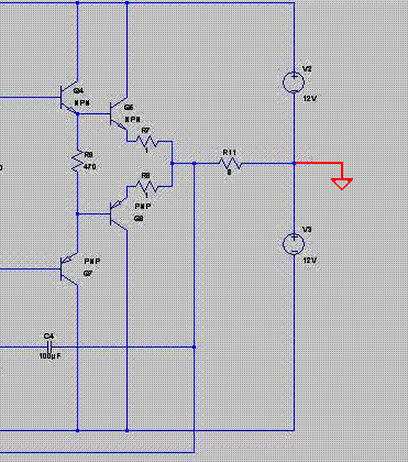

It looks like you forgot to connect the ground to the power supply.here i have stimulated the schematic i don't undewrstand why it is showing output in m volts??
See the red below.

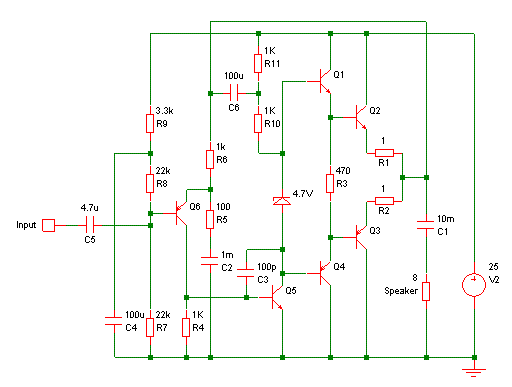

Good questions! Let's start with the capacitors.In this circuit what is the use of C4 and C2, and what will happen if we will not use this long (diff.) pair in amplifier ??
C2 is to reduce DC offset at the output. Transistors are not perfect so there may be a small difference between the base-emitter voltages of Q6 and Q7. Also, the current we need through Q6 to turn on Q5 may not be exactly half of the current through R10. There are also small DC voltage drops across R6 and R7 due to the base currents of Q6 and Q7, which may not be the same. For these reasons, there is a small DC voltage at the input of the amplifier, between the bases of Q6 and Q7.
C2 rolls off the frequency response of the amplifier below about 2Hz, so at DC the gain is one and the DC at the output is the same as at the input. Without C2, DC at the output would be higher.
Some people prefer to leave out C2. With careful design, DC offset can be low enough without it, especially if matched parts are used. Another approach is to put a trimmer potentiometer somewhere in the circuit that allows you to set the DC offset to zero.
C4 is for stability, to prevent oscillation at high frequencies. The problem is that the signal is delayed as it goes through the amplifier from input to output.
At some high frequency (probably a couple of MHz), the phase shift reaches 180 degrees, the feedback from output to input through R6 becomes positive instead of negative, and the amplifier oscillates at that frequency.
C4 prevents that by rolling off the gain at high frequencies to make sure the loop gain is less than one before the phase shift reaches 180 degrees.
BTW: For my simulation, I used BC547C for Q6 and Q7 because they have nice high current gain. Q2 and Q3 each dissipate about 10 watts so they need to be some kind of power transistor. I tried fast ones (Ft=30MHz) and slow ones (Ft=4MHz) and the circuit worked fine both ways.

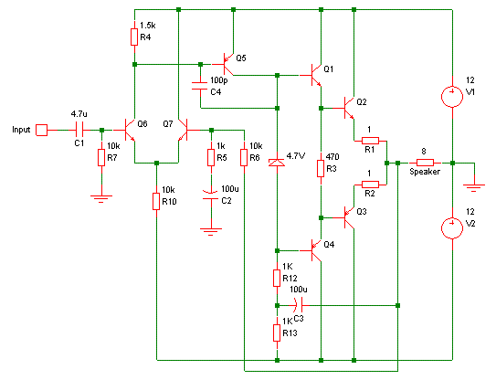

You can make an amplifier without a long tailed pair. One way is to apply the input voltage to the base of the input transistor, and apply the feedback to the emitter of the same transistor. If you do that, there is a DC voltage difference between input and output, so you have to be careful not to get a large DC voltage across the loudspeaker....and what will happen if we will not use this long (diff.) pair in amplifier ??
The easy way to do this is to connect the loudspeaker with a large coupling capacitor and use a single-ended power supply. There used to be lots of amplifiers like this e.g. the Quad 303, but it's not very popular today.
Here's an example circuit, similar to the previous one but with a single input transistor.

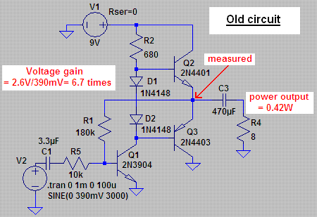

By making without L.P. will overall gain, or distortion will effects or not??
I was just calculating its power like this....
at 8ohms there was 4.5V at one side and with 600mA so, i think it overall power is 2.7Watt. or i have to multiply both by root(2) for RMS value??

No. Gain is set by the feedback resistors, R6 and R5.By making without L.P. will overall gain, or distortion will effects or not??
Distortion is determined by circuit details, can be better or worse.
For voltage or current, RMS value = peak value multiplied by root(1/2).I was just calculating its power like this....

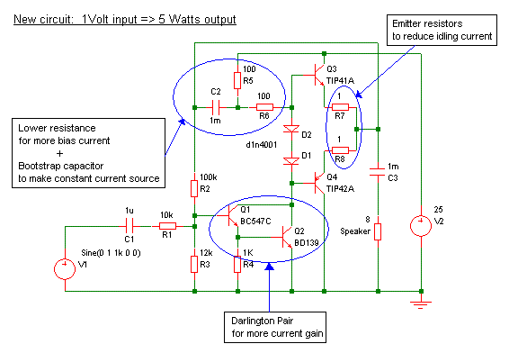

So for 5 watts:
9V peak = 6.36V RMS
9V peak / 8 ohms = 1.125A peak
1.125A peak = 0.795A RMS
9V * 1.125A = 10.125 watts peak
6.36V * 0.795A = 5.0625 watts RMS

Here's how to make it better and get 5 Watts output.I have used transistor as switch ( saturation and Cutoff Region) many times.
Transistor in active mode (active mode) i have doubt as i am newbie please provide a starting schematic.........
this was y first amplifier.
