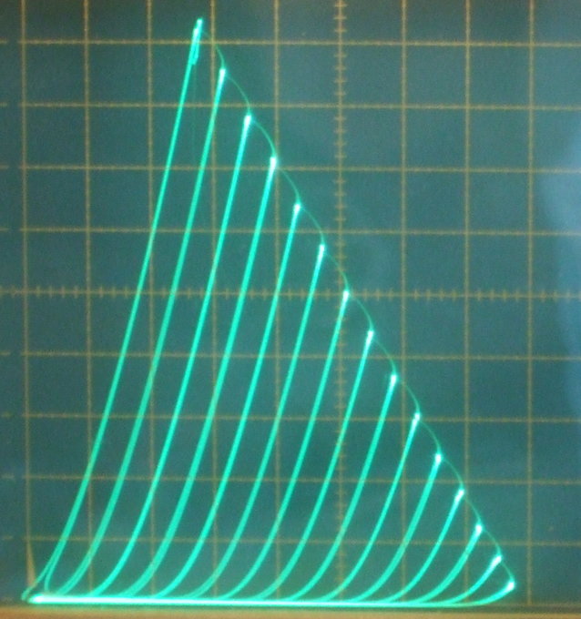

One thing I haven't noticed available standard is setting grid 3 to + or - Volts.
Here is the 4P1L pentode with -15V on grid3, 0V on grid3, +15V on grid3, and last triode mode.
+15V on grid3 looks best for pentode to me. (one could still just use a fixed supply to set grid3 V, if it is not available standard)
Oh yeah, another issue is the ability to scan the plate V from 0 to Vmax and ALSO oppositely from Vmax to 0. Surprisingly these two versions do not always produce the same plate curves, especially around the knees. This is a hysteresis problem that some tubes have. Like 6JK6. You won't likely see the problem either, unless the curve tracer can alternate between the two modes.
I went and re-tested the 6JK6 tubes I had here to get a tracer pic of tube hysteresis, and I could not find any that did it anymore.
Apparently this was a gas problem that cleared up via gettering after the 1st time I tested them. So we can forget the tube hysteresis issue (and - to + and + to - scanning thankfully).
N. Crowhurst did once mention a problem of tube hysteresis, but I guess I have not seen it for real yet. Maybe he had some gassy tubes too.

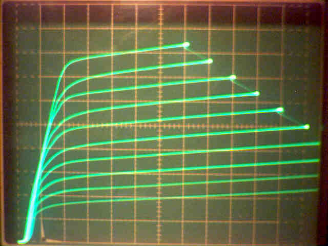

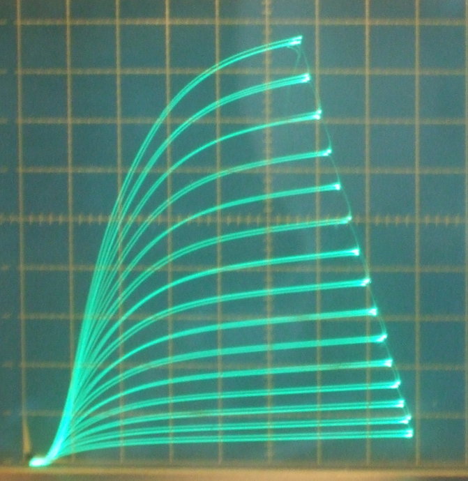

I'm quite astonished to see the first left line from which the bunch of curves appear to emerge getting steeper, i.e. more perpendicular, with increasing g3 voltage. This trick might be useful to increase possible output power with true pentodes. What's the explanation for this? And is this also applicable with beam power tetrodes (if their beam forming plates are brought out on an individual pin, of course)?
Best regards!
These grid 3 knee effects show up primarily in "dual control" tubes like 6LE8, 9KC6 and 6BV11.
(also: 6GX6, 6GY6, 6HZ6, 6AS6, 6BY11, 6DB6, 6DT6, 6AD10, 6888, 7AK7, also: 6BU8, 6KF8, 6MK8, 6GS8, 6HS8 )
They all have a fine pitch grid 3. Some ordinary pentodes will show some effect (assuming g3 is pin available) Most beam tetrodes don't show much effect.
The explanation is that the fine mesh grid 3 at 0V, or neg. V, returns (repels) off axis electrons back to grid 2. (off axis due to perturbing field around grid 1 wires)
Putting some +V on grid 3 can restore normal operation by letting those electrons thru to the plate. There is an optimum +V on g3 that works best, too much +V and g3 starts soaking up electrons itself. Usually around +5V to +15V.
The grid 2 dissipation also goes down dramatically with the +V on grid 3 for these tubes. Allowing the plate diss. rating to be increased some. The 1.7 W 6BV11 with +10V to +14V on g3 becoming somewhat similar to the 3.1 W 6BN11. Grid 1 gm increases dramatically also (just because more electrons make it to the plate ). Rp increases too.
Pete Millett has used the 6BV11 ($1, dual pentode) with +V on grid 3 for a project, I believe.
I don't know why the 4P1L has a fine mesh grid 3, no mention of it on the data sheet, except the Chinese version does mention the +15V. Maybe the original German equivalents had some info. (Bartola: Russian equivalent of the WWII era German Wehrmacht RL2 / 4P6 RF oscillator / transmitting amplifier tube. ) Possibly a fine mesh g3 would lower Miller effect from the plate (increased Rp at least).

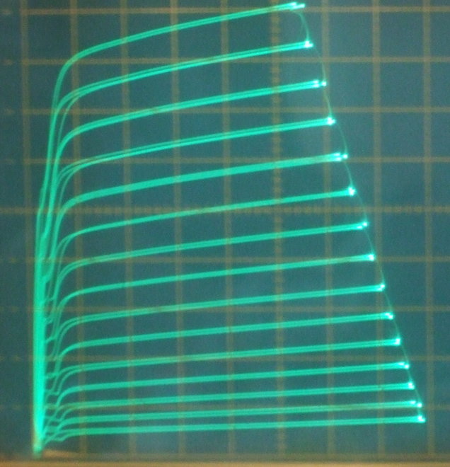

Whoa!!

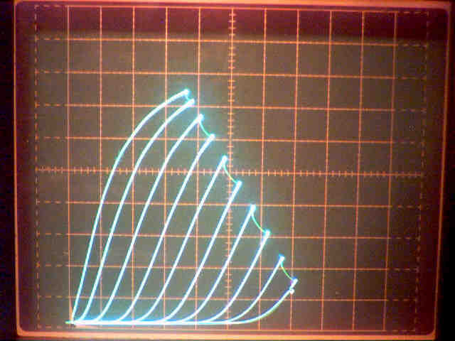

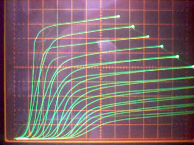

Looking a little further down that Suppressor Grid thread, I found this evidence for tube hysteresis with the 29GK6 tube (6BQ5/EL84). So maybe this ugly thing exists after all. And so - to + with alternating + to - plate V scans are needed to see it. Or was it just a gassy tube?
3rd pic is a 29GK6 with g3 left unconnected!!!
I recall a thread somewhere where someone mentioned that some designer was leaving g3 unconnected for a more "natural" sound. Hmmmm...... I think I replied to that comment with "does he drive around town with his car door unlatched" 😀
Might be interesting to put a high meg. Ohm value pot in series with g3 (to ground or cathode), for some special effects. "train wreck" effects maybe.
https://www.diyaudio.com/forums/tubes-valves/160240-suppresor-grid-feedback-7.html#post2085659

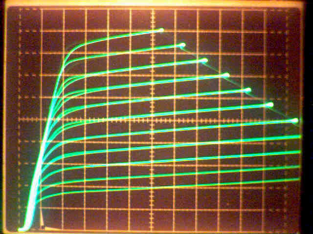

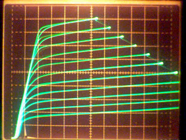

On the tube hysteresis thing, I've seen some data sheets with the alternating plate curves showing the same knee dissimilarity. (but not showing the doubled up knees from re-tracing an odd number of traces seen above) (see non-doubled dissimilar curves below) Probably had their curve tracer set on the max 10 step curves. Takes an odd # of steps, and full wave rectified 240 Hz tracing (4x 60 Hz) to get reversed traces on top of forward traces. (the 2X Step Rate setting on the Tek 576 with 9 steps instead of 10 steps)

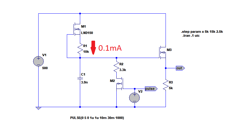

I posted this HV sweep circuit before -- it is adapted from Microchip AN-D12, with the sweeper driving a high voltage MOSFET. The LND150 is a simple 100uA CCs charging a cap (1nF in the apnote, 3.9 in my experiment), and discharged by another Microchip MOSFET.
As i/C = dv/dt everything falls out nicely.
