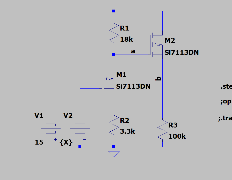

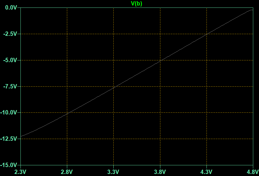

Easy to use a DAC (shown here as V2) to drive two P-Channel MOSFETs for grid bias -- I just picked a pair from the LTSpice menu.
