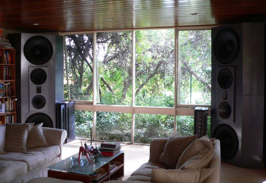

Notice something? Yes? They're 8 ft. They have dual ridiculous 27" woofers in each of them, a 15" mid, horn loaded tweeter/ Only thing is there's an ultra high frequency driver on them that I'm not gonna bother with. See what I'm getting at?
I'm basically modeling my speakers after those 8 foot tall monsters. Sure I'm no professional, I can't design a crossover, I can't do this and I can't do this, ok, fine I get it. I may not be able to make anything like the Opals but I sure as hell think I can come out with a decent sounding system if I take my time and do it right.
And I just don'tget something here. Those opals are in a room that can't be any bigger than 800ft^2 at the most and that's gonna be about the size of the room I'll be playing mine in. Those speaker posted a while back with 21" Madisons where in a basement which I know can't be big. Still both those speakers get more recognition tha I could ever wish for but I get my idea turned down when I want to build something that's not even close the Mrs. 21"'s set up or the Opals. I know both those speakers can't be far off from what I'm doing.

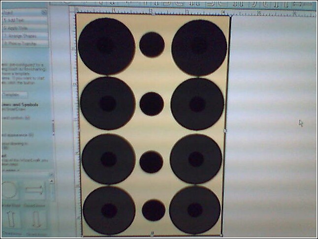

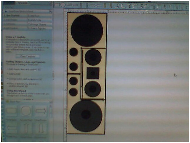

Anyways, fine then I won't build my full range speakers. I'll be a 6 ft tall sub cabinet
I bet that worries everyone on here but here's my design. If this is denied I promise it'll be the last of my big speaker plans mentioned for a while.

now, this is getting a little more sensible and realistic. I do have an idea, but want to find out the rest of the story🙂
2 Dayton Classic DC200-8 in parallel, Dayton xover, X02W-2k (or if a 24-2500 hz version is available, a 4 ohm tweeter of you choice. Keep the woofers "stacked, that is a T-W-W setup, as close together as possible w/o touching. No mid, but two woofs in 2.55 ft^3 box, -3db @ 35 Hz ....
not as efficient as you originally suggested , but deeper bass than most of the PA styles already posted.
