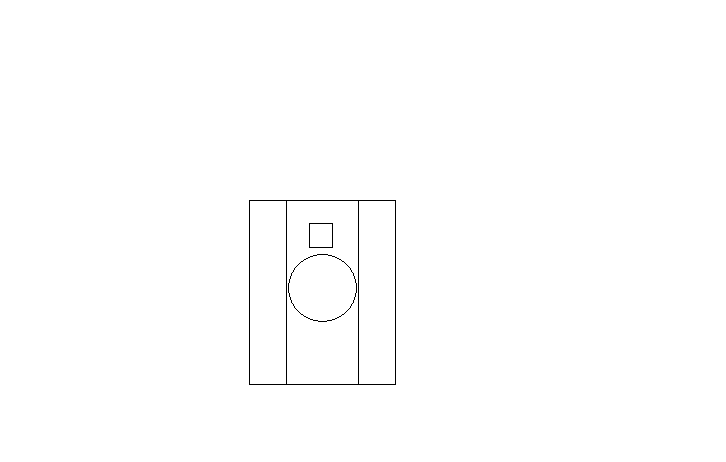

At some time when I discovered that it goes quite low, I suggested using double BETA 12A in a 2.5-way ... but ofcourse it could with a combination of 12A/12LTA ... could be interesting, but breaking budget
I would think a single 12LTA in BR, with a fronthorn could be nice
Tweeter could be mounted in the same fronthorn

I sure don't see this as a P.A. speaker, either. The only thing "P.A." about it is the pro driver, and it's not even a typical P.A. driver. How many full range driver P.A.s do you see?
Variac is right, it's more like some crazy overgrown Audiophile project.
What does the inside path of this box look like? Did I miss a diagram somewhere?

Variac said:I have a job to deal with!
A whaaaat???
When you post the drawing, will it be the "Architect Sketch"?
"THE ARCHITECT SKETCH!!!"
(Gratuitous Python Reference)
