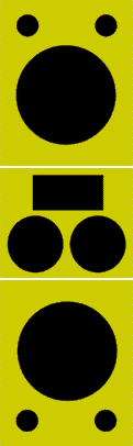

Here ya go... I'm looking to bring this thread to and end so I finally got something I think everyone will like. the lines on it are where I will divide the cabinet in to separate enclosures. By making the woofer enclosures like That I will make use of what would have been unused space and this will allow me to make the cabinet shallower.
Drivers:
woofers-2 Dayton Pro 18"'s that's settled.
Tweeter- it seems that I'll still be using the D210Ti driver with the some form of a horn or waveguide.
Mids- well there is still contradiction over what I should use for the mid but I want to get this over with cause even for me 60+ pages is getting old, lol so I've decided to ditch the 12" and I was thinking something like dual Delta 10A mids or whatever you might think be a better choice. it's just with the dual 10" mids I figure that every one's happy, better sound (or so it was said that the 10" mid would sound better), more power to keep up with the woofers, and I get the tall speakers with plenty af large cones on it. 6 ft 2 in tall is what I calculate. and around 250 lbs

I was afraid of all those smaller circles. I thought they were 8" mid drivers!! Then I figured out they were ports! While some people keep the ports close to the floor for reinforcement of the bass, I don't think that will be necessary for you, so its OK. I assume they are spaced unevenly because of your drawing program 😉
The 2 bass, 2 mids and the tweeter in the middle should be your final design I think, and it looks great. The row of ports looks great too.
You still should have at least 3" around the drivers including top and bottom. Good news, that would make the boxes taller!
I really don't know if a 10" will be better than the 12, but it will certainly work. It has rising response like the 12, so will need some roll off at the top. It also goes to a high enough frequency-that's important.

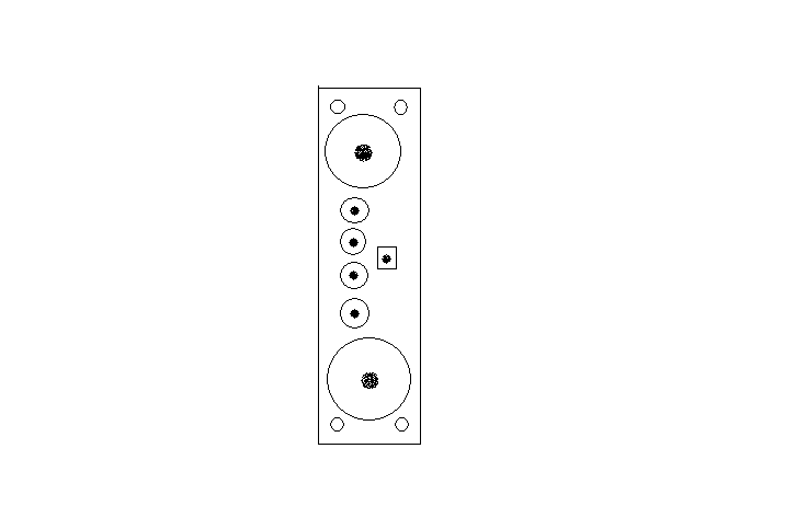

I would change the box layout a little. Will post a drawing of what I think for your consideration. BTW, what is the layout software you are using?

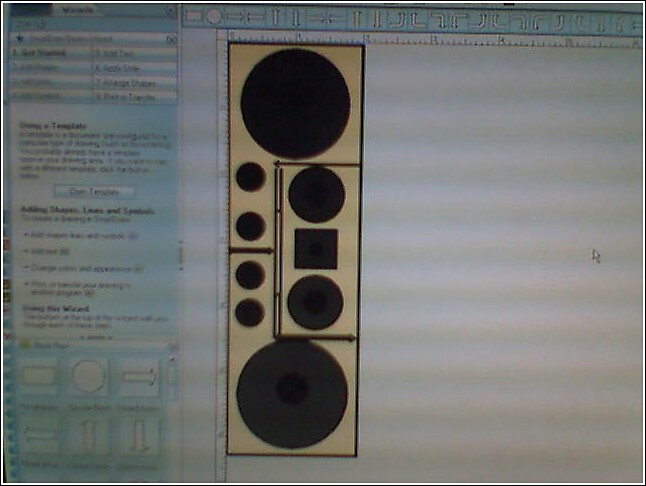

Hmm... well pano your configuration isn't from many of the one I've posted or at least drawn. Would that arrangement sound better than mine?
The drawing program I used is SmartDraw 7. THat's the link to the download page if anyone else wants to use it. Very simple program.
