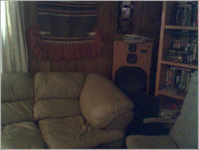

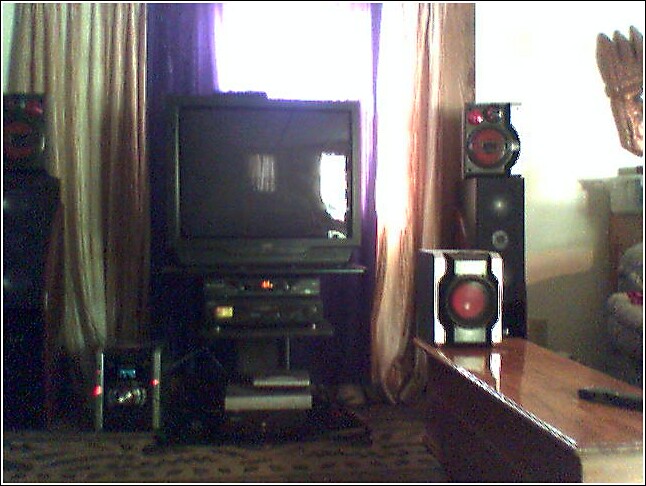

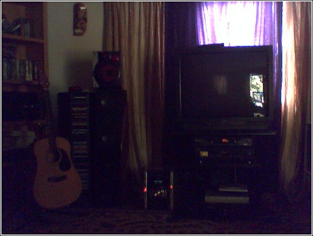

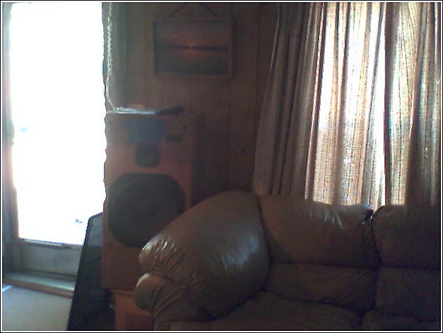

Here's some pics of what my current system looks like. It'll take a few post to show it all.

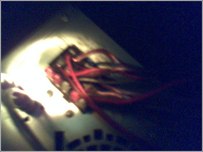

the rear right, yes it's missing a tweeter but I soon plat to replace it. I temporaly taped over the whole to keep the speaker soundin good. The rears are Sharp CP-9000, my dad's first pair of actual "3-way speaker" which was also my first set. The front is my first sytem, about a year os so old now. The amp as I said before has built in crossover so the back has 5 outputs, two for the high, two for the low, and one seperate for the subwoofer, which is a 6 inch.
and those speakers the panasonic POS's are sitting on are white van speakers, Skyline "Proffesional" Image 900SL or whatever, the exact same model I was ripped off on but I sold that and then a friend was ripped off my the same pair who got me so he let me have them since I have already dealed with them. They are not running they are more for show.

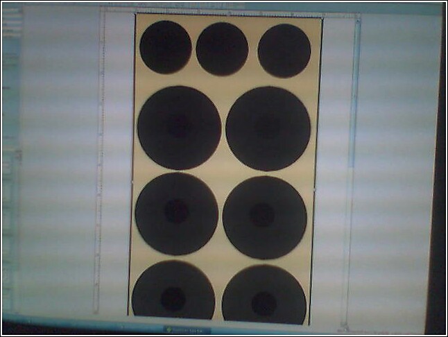

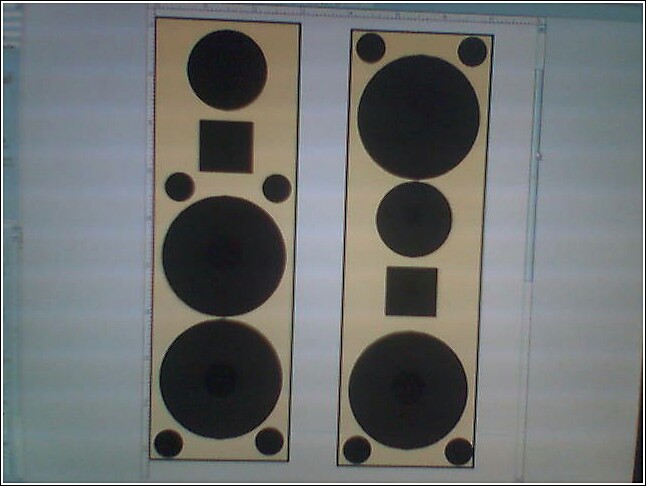

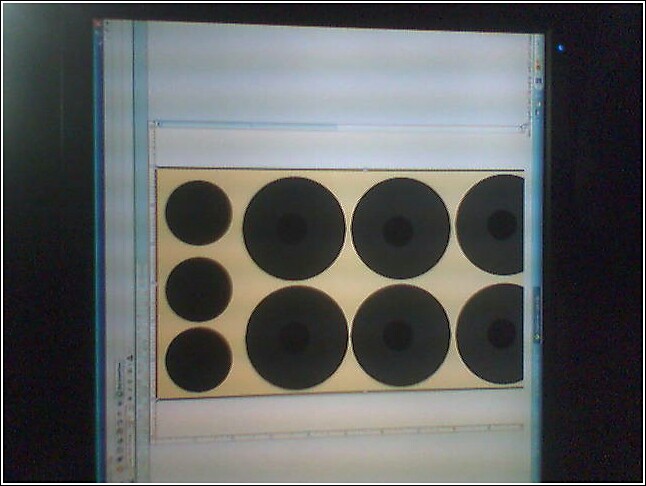

Well... the 12" mid is slowly fading away., but let's take one moment to look at it and then think of me and my style for the big stuff
well, I did have areally good drawing of what the speaker would of look like but it says that that file is an invalid attachement. If anyonw wants to see what took me about 30 minutes to do let me know and I'll email it to you if it'll let me do that.
Scratch that, I took this with my camera and then uploaded it so forgive me if it's kinda blurry, the best I could do for now.
Very exciting to see you making an effort here. That is a great way to visualize them.

well, my other side couldn't help it. any guesses as to what this is? hint those are 18" drivers and just an idea on the ports. In a 65ft^3 box
No worried though I was just being creative and letting my imagination go for it. This is NOT anything I'm considering.
It's great to see you coming up with some images! That's the spirit.
I see just a few "rule of thumb" things to try, maybe other people have more experience, and don't think these are rules of thumb. Anyway, here they are:
-Try to keep port openings at least one port radius away from any internal wall. One diameter or more is better.
-Keep the tweeter at ear level. The first image you posted, the speaker on the right looks good. The orientation it's in is good for sitting on the couch, flip it upside down for parties. Good job.
-Compartmentalize the inside. Those woofers can't all be in a connected airspace. The woofers will mess up the mid, the enclosure is tall enough to get some serious problems with standing waves and other weird resonances.
Also, one other thing- now that you have a good idea how what size these guys are going to be, how about figuring out how much they'll weigh? I'll go take a shot at it, but maybe you should too.

Ok, as a rough calculation, I assumed you're using 3/4 inch thick wood with a density of about .024 pounds per cubic inch. If the speakers are 6 feet tall, 22 inches wide, 24 inches deep, and has a couple of braces in it to partition it off... it looks like about 160 to 175 pounds of wood per speaker.
With two 18" woofers, you're looking at 56 pounds of woofers, 11 pounds for a 12" midwoofer, and 7 pounds for the tweeter and waveguide. I'll be generous and assume that you're going to house the crossovers in external boxes.
All this adds up to nearly 250 pounds per speaker. That's how much I weighed in college. Overall, it's going to be extremely awkward to move these speakers anywhere, but if you and a brother or your father are both healthy and strong, you won't have to build them in place.
For the record, I still think you're best off making this modular. On the other hand, if you live in a bad neighborhood and it gets out that you have awesome speakers.... the 250 pound beasts will be that much harder to steal.
