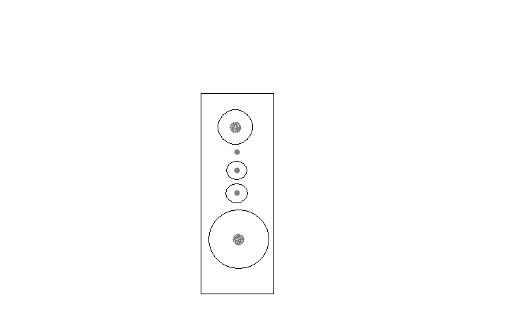

So now we have established a good choice of drivers and a basic layout. The layout Mr. Punk seems to like is the layout of the Montana, or the Magentar big OB project that I suggested way back when.
Please tell us what is wrong with this WMTW layout? Honestly, what are your objections?
If you look back a few posts you will see that Punkrokr wants to put one 18, the mid and horn in a single box, with the other 18 in a separate box. Now what does that sound like?? Yep - the Blue Wonder with a 12" mid. That's all. And it has a 2nd (probably unnecessary) 18. Just how bad is that going to sound?
To boot, he will have an active crossover for his bass, so that he can easily turn it up or down to suite his tastes. What's wrong with that?
I spent a lot of years working with big PA gear. Most of my audio engineer buddies had PA gear at home. I sure didn't like the sound of it, but they loved it. And it did sound bigger, badder and more live than 99% of what I've heard in a home speaker. Ultimate SQ? Only if big loud and dynamic are your only criteria.
So anyone: If there are any real, constructive, detailed criticisms of the 18/12, please step up and let us know. That's what we are here for. But the "Oh that will sound awful" posts don't really help - do they?
Can’t you tell us why you think so and give us details of what might be done better?

I think you will want only one woofer hooked up most of the time. These things don't sound good at lower volumes. They need to move a little before you appreciate them so having two might be a detriment at lower levels. Hook up the second when you need to turn it up. (remember to adjust your XO to compensate for the change in impedance)

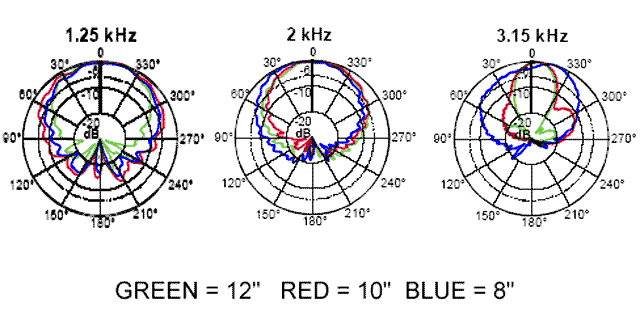

The 12" is awfully big. I think the sweet spot will be rather small due to beaming. If it were my project, I would consider no larger than 10" unless you plan to run it through a horn as well. If you do that, you will reduce your beaming considerably and incrrease the SPL. With an active XO, power handling won't be an issue.
I'm not sure about the waveguide for the tweeter. Compression drivers are meant to come out a more traditional horn. I understand that waveguides are used because they don't have a big influence on the sound and are therefore well suited for other types of tweeters that did not originally come with a horn, like cones and domes. A compression driver kind of relies on that interference and colouring in order to sound right. Have you listened to a compression driver by itself? Did it sound right or does it sound better after you connect it to the horn?
Not trying to pee on anyone's parade and yes I know this is fun but I think the above points should be considered as it is still a rather large chunk of money being laid out here and I think we owe it to punk to give him the best value for the money.

I actually HAVE used the Eminence Beta-8, and I was fairly pleased with it. The Hammer 8's are supposed to be very similar.
It's no surprise that you want a low crossover with it, since you get a better match in directivity at the crossover, less beaming overall, and better coherence due to the wavelengths involved at the crossover and ceneter-to-center spacing.
If anything, I think the Beta 8 had a slight tendency to ring in the high end. That's just paper cone breakup, and nothing as objectionable as metal cone breakup. If it's addressed with a lower steeper crossover, I think they're great drivers.

Polar Response
Just for fun, see the graph below.
Polar response should not make much of a difference below our crossover point, but above it things change fast. How much will the horn fill in?
Polar response is not the only difference between 12 -10 - 8 inch drivers, of course. Just for your reference.
