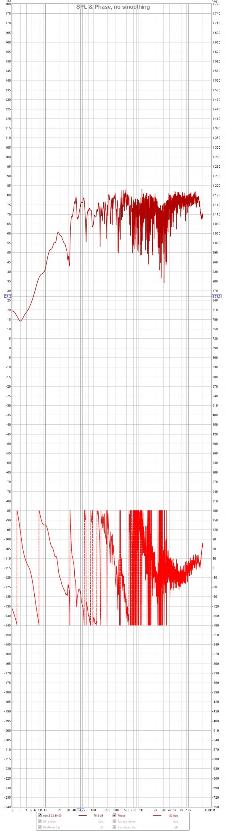

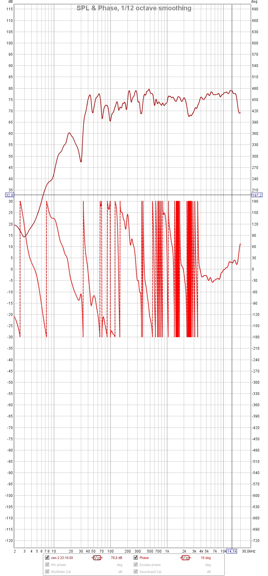

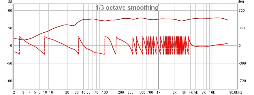

In general, I made trial measurements of my speaker system. This is all too much ... In jerks? And there are too many ups and downs. Please look at the charts.
What I understood from these graphs is that my system clearly works out both 20 Hz and 20 kHz. Attenuation is observed at 14-15 kHz, and even then it is not significant. From these graphs it is possible to tell at what frequency my supertwitters should be cut?

First, I dont think your tweeter cuts at 14 kHz, it’s either your software that has a upper limit (often adjustable) or the mic that roll off, but still unusual with such steep roll off.
Second, you need to measure the off axis roll off. My suggestion is to add the super tweeter above the off axis roll off. You should measure 30, 40 and 60 degree off axis.

You should measure the existing system. The tweeter will begin to beam at 4-5 kHz. I would ad a supertweeter between 7-10 kHz, then it will both fill in the off axis loss and extend to 40 kHz.
From what I’m gathering it’s a subjective trial and error process as there really is no formula for adding a super tweeter.
Main questions would be do you need to roll off the regular tweeter with an inductor and how much to pad the super tweeter.
Your roll off of tweeter (if correct) is quite sharp so I’d just put a series 1uf cap on the super tweeter and see what it sounds like……if it needs attenuation pick up adjustable L pads to find where you like it then you have the choice to measure the resistance and replace with fixed resistors or keep the adjustable.

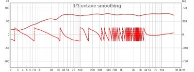

Most graphs you see has a scale on the y-axis that span 50 dB - yours are 200 dB and anything will look "nice and flat". Use that to get an idea how you compare to others you see.
