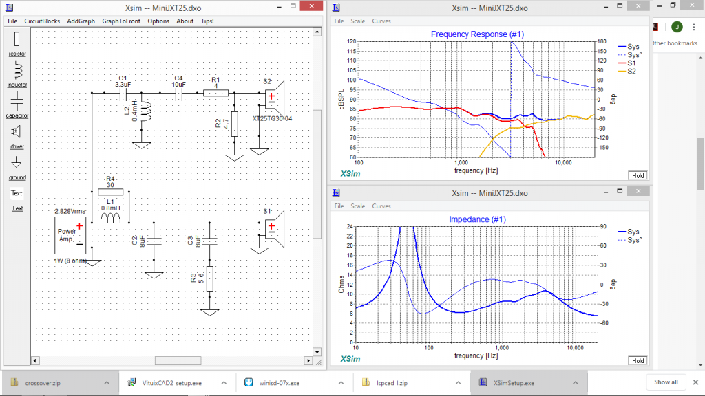

I did a search for designs that use the DX 25 and found two. Maybe one of these would work if you use a variable resistor to control the output.
I'm curious to hear your opinion about any difference it might make.
