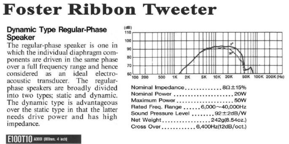

I have to ask for your advice again, dear experts. These tweeters have frequencies ranging from 6 kHz to 40 kHz. Does this mean that there is no need to do a crossover for these tweeters?
P.S. By the way, if you want to laugh: I bought 4 of these tweeters by accident. I don’t understand how it happened. 🙂 There was an expensive delivery, almost 80 bucks, and I decided to buy other interesting things, and did not notice how I put 2 more tweeters in the basket. 🙂
The Foster E100T10 tweeters require a crossover of 12dB per octave at 6400 Hz or higher/steeper slope to handle their rated power.
Without a crossover, low frequency signal would destroy the diaphragm at far less than rated power.
