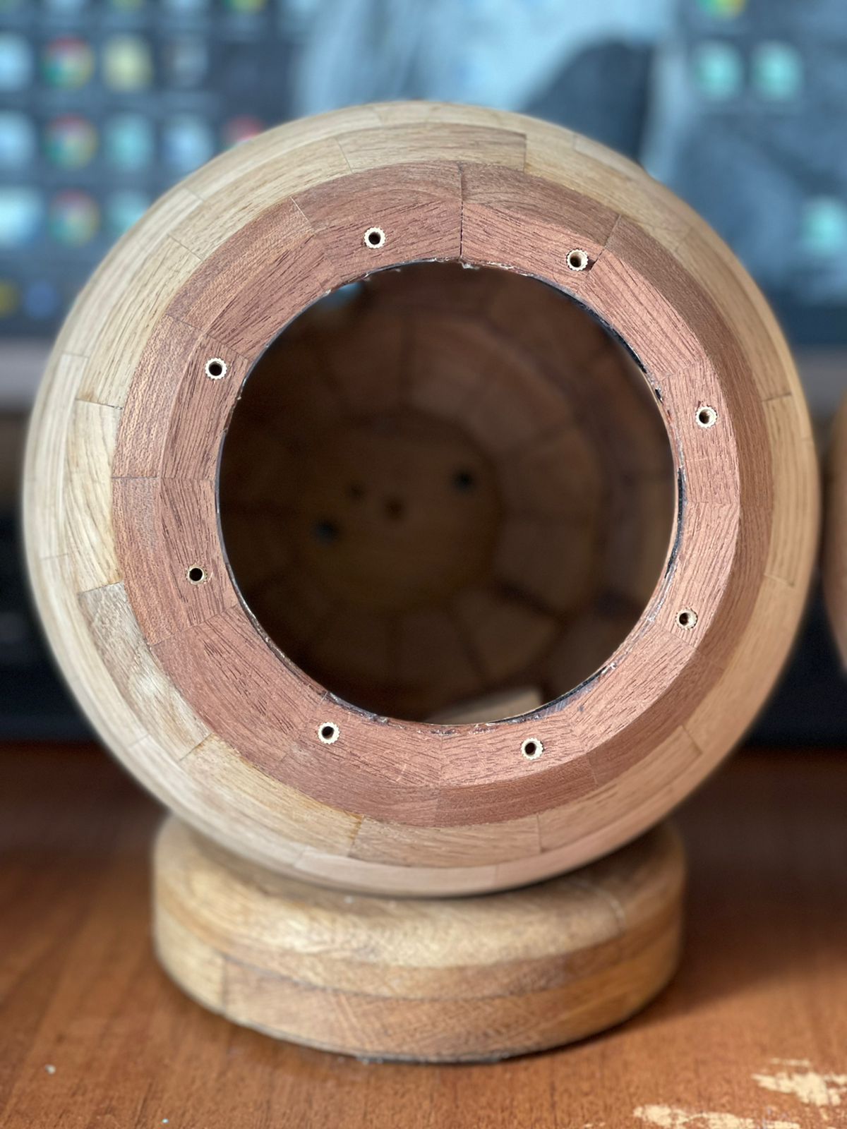

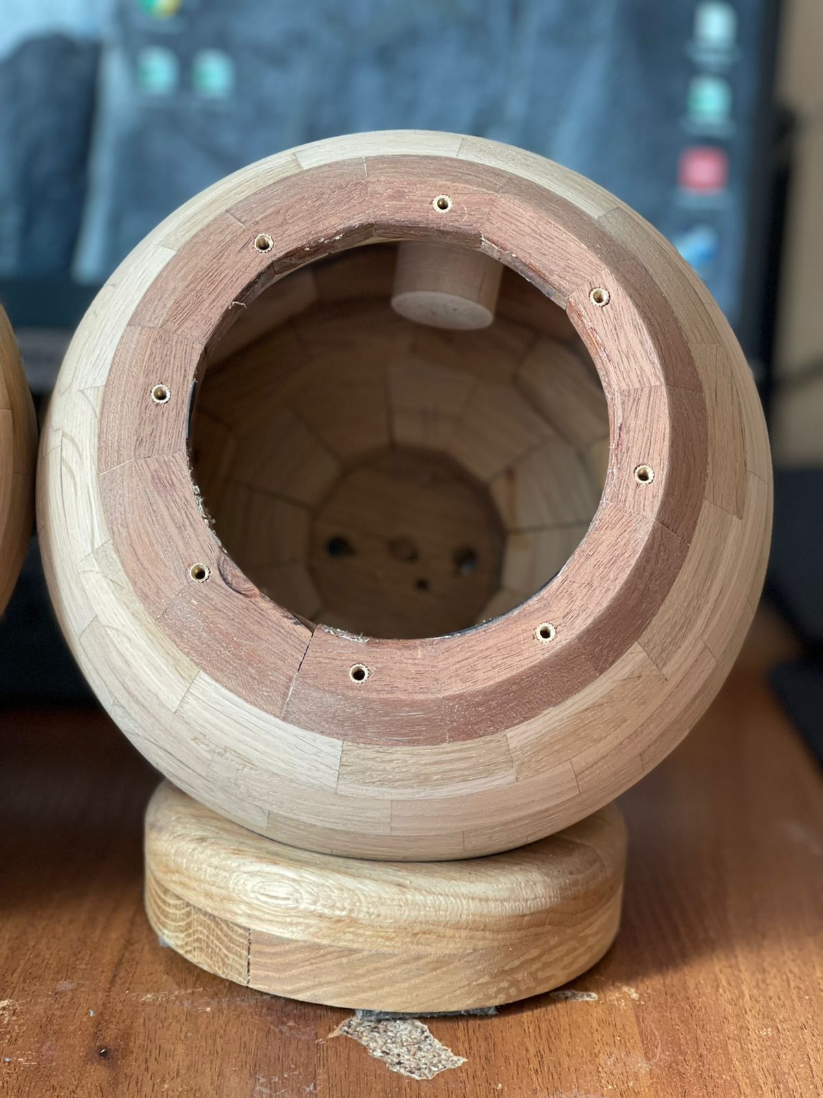

Hello! I'm getting closer and closer to the finish line!

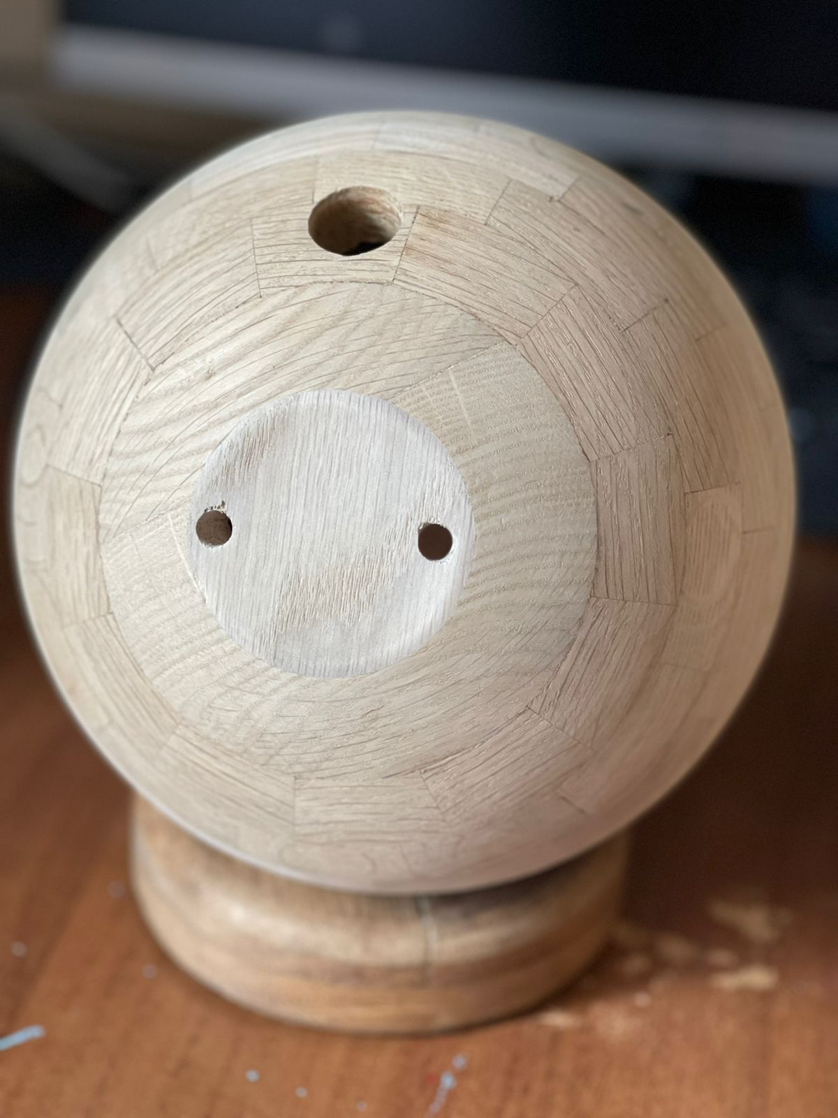

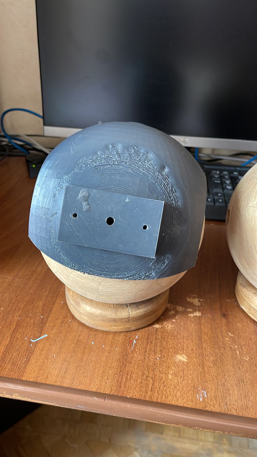

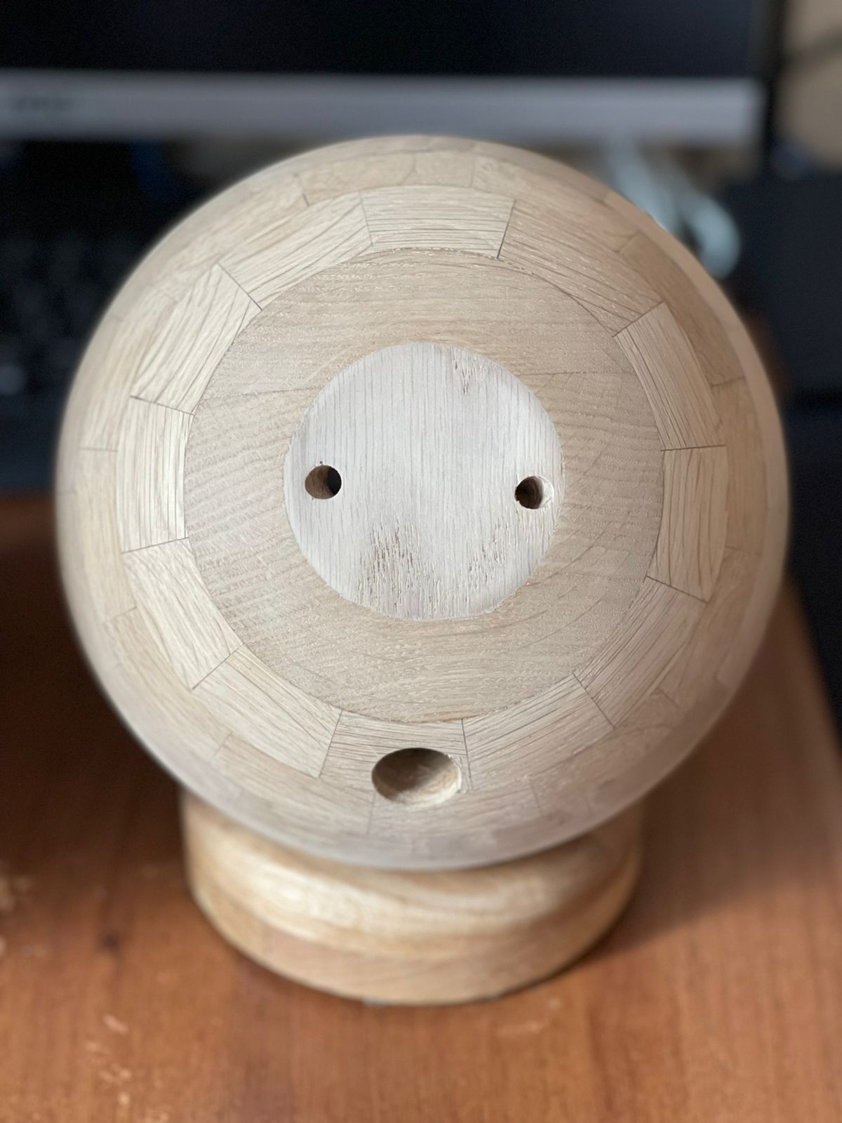

Last week my friends 3D printed a jig from my drawings so that I could drill holes for the terminals at an angle to each other. And this week I bought special glue, oak veneer and good oil. The bottom line is that on the side where the clamps should be located there are many holes that are not beautiful and are not needed. For two days I suffered, gluing the veneer. I spent 3 kilometers of nerves and about $100 on auxiliary materials such as glue, oil, veneer and a wood carving knife. 🙂
And I did it! Everything is very beautiful now! 🙂 How do you think?
The first photo shows a helmet for a sphere. 🙂 This is my conductor.
I also bought a hefty oak board. I wanted to cut round chopsticks (I hope that's the right word?) that I wanted to glue into large holes, but I also dulled my favorite Japanese saw when sawing this oak and my hand jigsaw did not help me cut such chopsticks beautifully, and I decided that let those big holes stay like that....
As the saying goes, "the best" is the enemy of the "good"
