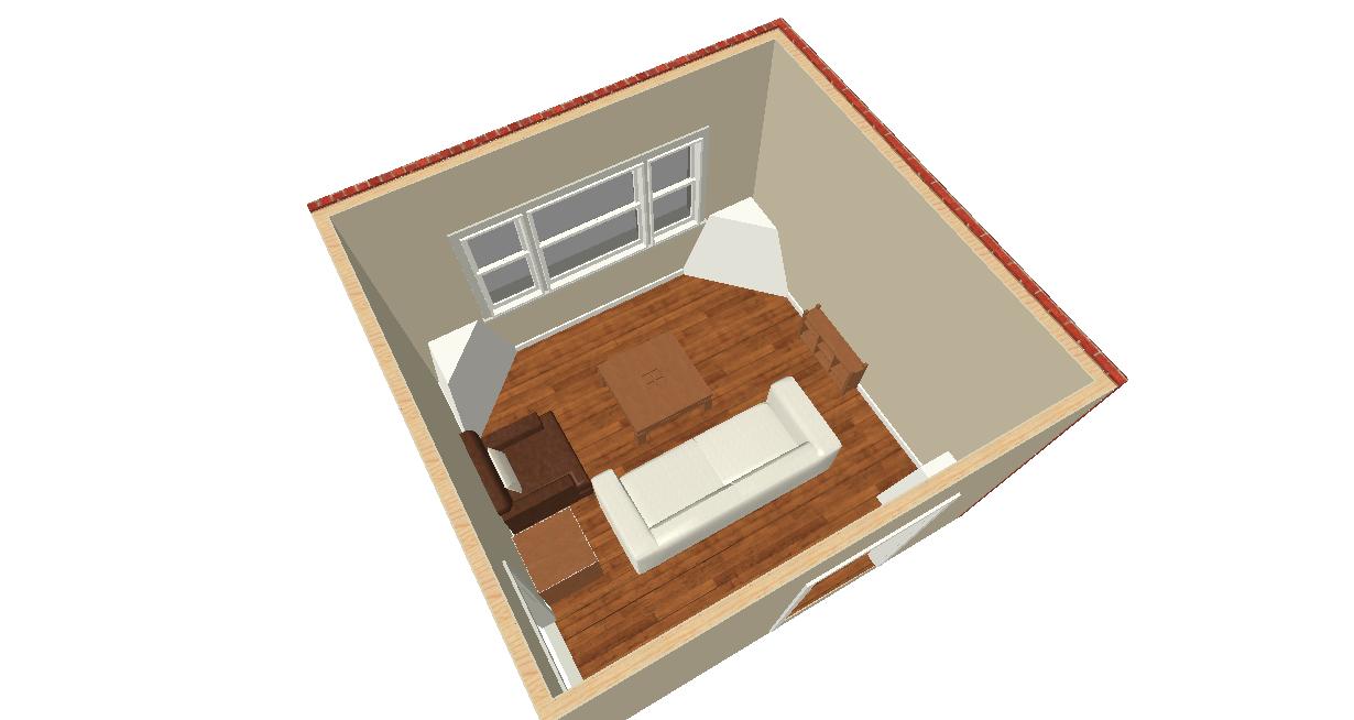

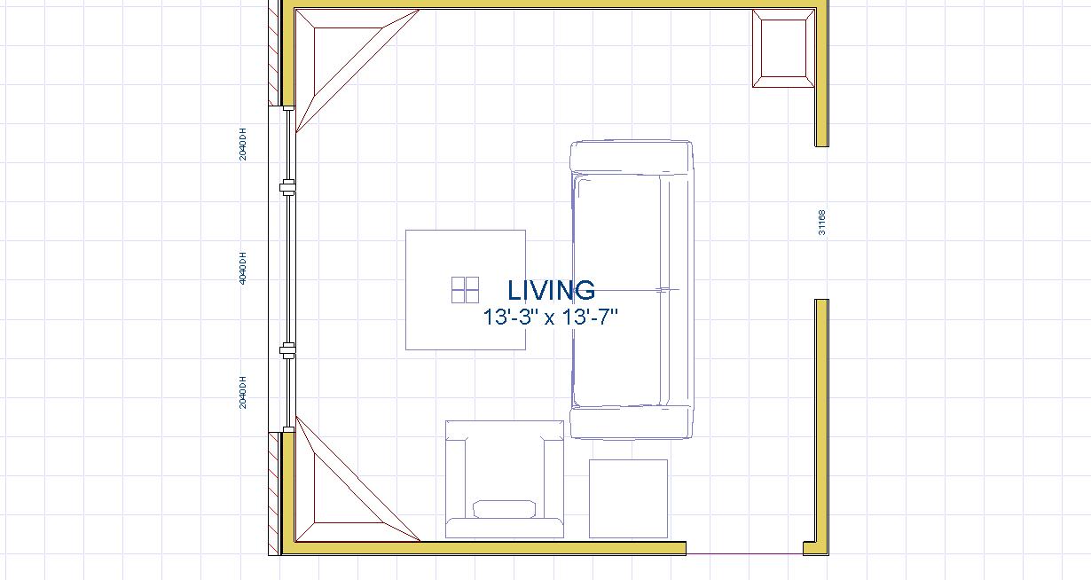

Since the room apparently plays a role in imaging, how does this arrangement look? The two triangular objects in the corners would be loudspeakers designed for corner placement, and the rectangular box in the third corner is a subwoofer. I'm thinking of changing my living room to this arrangement by adding a wall so that I get two good corners.

Your corner set-up looks wide to me. I'd be afraid of the "hole in the middle" effect.

Yeah, I don't really have a great listening space in this house.
