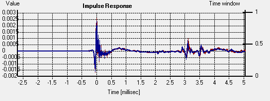

A guide to better imaging
Hi, I'm putting together a small guide and I'd like to post it here for review before making it more public. I'm sorry for repeating topics that have been discussed already.
I would like to present a simple strategy that has helped me achieve better imaging. Equal distances of the left and right speaker to the sidewalls improve the accuracy of the stereo image. If one speaker is closer to the sidewall than the other, a smearing in the image occurs towards that side. When the speakers are properly positioned in the room, the listener can move left and right and the image will shift sideways while losing some clarity.
The underlying concept is not new and has been discussed in numerous publications. A presentation of the basic principles can be found on Singfried Linkwitz's web site. My contribution expands on how one can verify the distance of the left and right acoustic paths by using measuring equipment. I do not understand the underlying psychoacoustic mechanisms that govern this process but the benefits of this approach are readily audible. Everyone is encouraged to try this out and comment on the perceived effects.
Please verify that you meet the following requirements before continuing:
- You have access to measuring equipment.
- Your speakers have an even power response. Omni, Constant Directivity, Fullrange designs as well as some small bookshelf implementations should be the best candidates. Implementations with uneven off-axis response may not be suited for this arrangement.
- Your listening position should bound by two large, acoustically similar, parallel surfaces on your left and right side.(walls)
Good tonal balance takes priority over imaging and is therefore out of the scope of this article. Room modes and early reflections are the primary concern of proper speaker positioning. It's assumed that the reader is aware of their room's limitations. Objects with sharp discontinuities should not be in the way of the direct acoustic path and at least 2ft away from the tweeter and midrange.

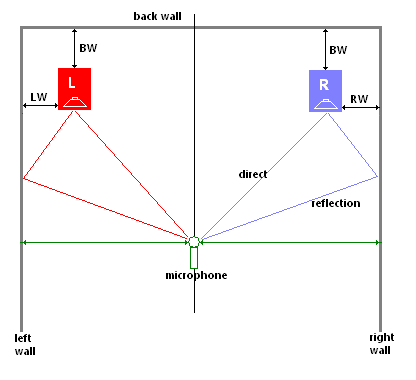

We may begin by positioning the measuring microphone close to the preferred listening spot, equally spaced between the left and right wall. Use a tape measure and try to get to about an inch accuracy. In my far from acoustically perfect room there is a huge panoramic window on my left. I understand that the majority of sound reflections on my left will be coming from the window so I treat the glass surface as my left boundary. I have discovered through experimentation that crude acoustic treatments such as blankets and curtains have negligible effects in this application and should not be considered.
Next, using a tape measure let's place the speakers at equal distances to the sidewalls. 2ft or greater clearance is recommended from the side walls. The clearance from the back wall should be at 3ft minimum. Please do not undermine the effect of room modes when selecting the speaker position. When you have the speakers at a satisfactory position run a MLS sweep and have a look at the recorded Impulse Response. For this guide I used a blue plot for the right speaker and red for left.

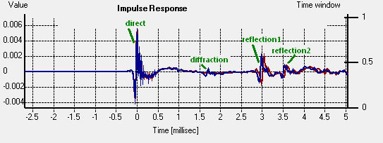

In the plot the highest amplitude signal is the initial pulse coming directly from the speaker to the microphone. Subsequently at around 1.7ms there's a little bump in the right channel. Judging from the intensity and timing this is most likely a diffraction from furniture in the signal path. Diffractions can be easily identified by covering the suspected sources with a pillow and running another sweep to see if the acoustic signature of the diffraction has changed. Another strategy is to turn the speakers to an angle at which they illuminate the offending object with less intensity while maintaining full energy radiation towards the listening spot.
The second largest disturbance in the plot at 3ms is without doubt the reflection from the side wall. The later reflection at 3.5ms is most likely from the ceiling. Linkwitz recommends that there are no wall reflections for the first 6ms but I ruled that impossible to accomplish with the size of my living room. Yet I get a very sharp stereophonic image which prompts me to believe that although a wider room might be beneficial it may not be necessary.
The most important factor for the focus of the stereophonic image I found to be the equal distance of the speakers to the sidewalls. When centering the speakers one must be careful to align not only the distance to the wall but also the angle at which the speakers face the listening position. It is clear from the initial plot that reflections from the right channel arrive faster than those from the left. In practical terms that translates to the stereophonic image smearing towards the right side. The effects are audibly obvious when one is auditioning image test tones.
