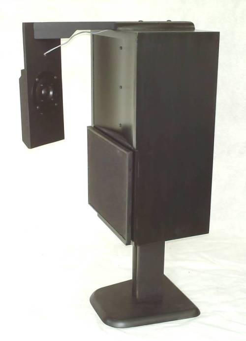

This is a method for creating a virtual source of the sound of the tweeter by reflecting some of the sound of the tweeter off of a concave reflector towards the listener. The idea is to make it seem like the plane of reproduction is apparently some distance behind the location of a pair of stereo speakers and disassociated from the speakers.
Do you think that this has merit? Any other comments about it?

Attached is a photo of the right channel speaker system of a pair that I built according to the principles of the patent (see the above post). This is a closed-box two way system where the box measures 12.5" wide by 8.5" deep by 20.5" high. It could be smaller by maybe a third, but it needs to be somewhat on the larger side to accomplish the special imaging.
As you will see in the photo, the tweeter on its own little baffle is extended out in front of the system's cabinet and partially facing a concave reflector at the upper front of the cabinet. Admittedly the speaker has a sort of ungraceful appearance, but I've seen worse.
The imaging is great IMO.

In that case I would think that you would want to ban stereo reproduction from your listening room too. Stereo depends on the creation of phantom localization of sound. Isn't phantom sound also "barely past" a parlor room trick? 😀
Heaven forbid surround sound!
In my setup I havent ever heard images beyond the walls, perhaps the back wall, but not the side walls. I do hear images outside of the speaker up to the left and right wall boundaries.
In my experience, in untreated rooms, I rarely if ever have heard images extending beyond the cabinets (right of the right speaker and left of the left speaker) on the horizontal plane. I have heard truly wonderful sounding systems in untreated rooms, but the images were mostly localized to between the speakers.
I am not going to get into arguing peoples claims. If someone says they hear clear distinct images beyond the walls in a untreated room, who am I to dispute the claim? All I can say is, in my room, that would be impossible.
