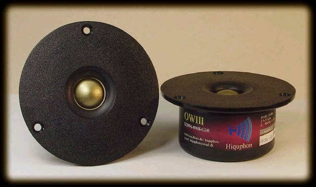

Which is why I fill the tweeter faceplate screw holes with black wax...makes quite a difference
It is also known that the "edge" around the dome on a Vifa XT25 should be rounded
I believe new models are all nicely rounded at this point
Its all only logical to be that way...I mean, noone would ever think of mounting drivers without countersinking
Funny that professional driver designers should learn that from DIYers
Wonder when they will take the next step getting rid of ALL chassis screw holes...they should know by now thats its not just a cosmetic thing

I dont know about other conventional speakers...but my "conventional" speakers doesnt seem to have any problem with sidewalls or any other things around them, none at all...I would say its mostly a matter of crossover, but it may be that its easier with "born" directive transducers like waveguides, ribbons and such 😉
Hiquephon seems to take the diffration issue more seriously than the competition...unfortunately there still is a very small sharp edge left
