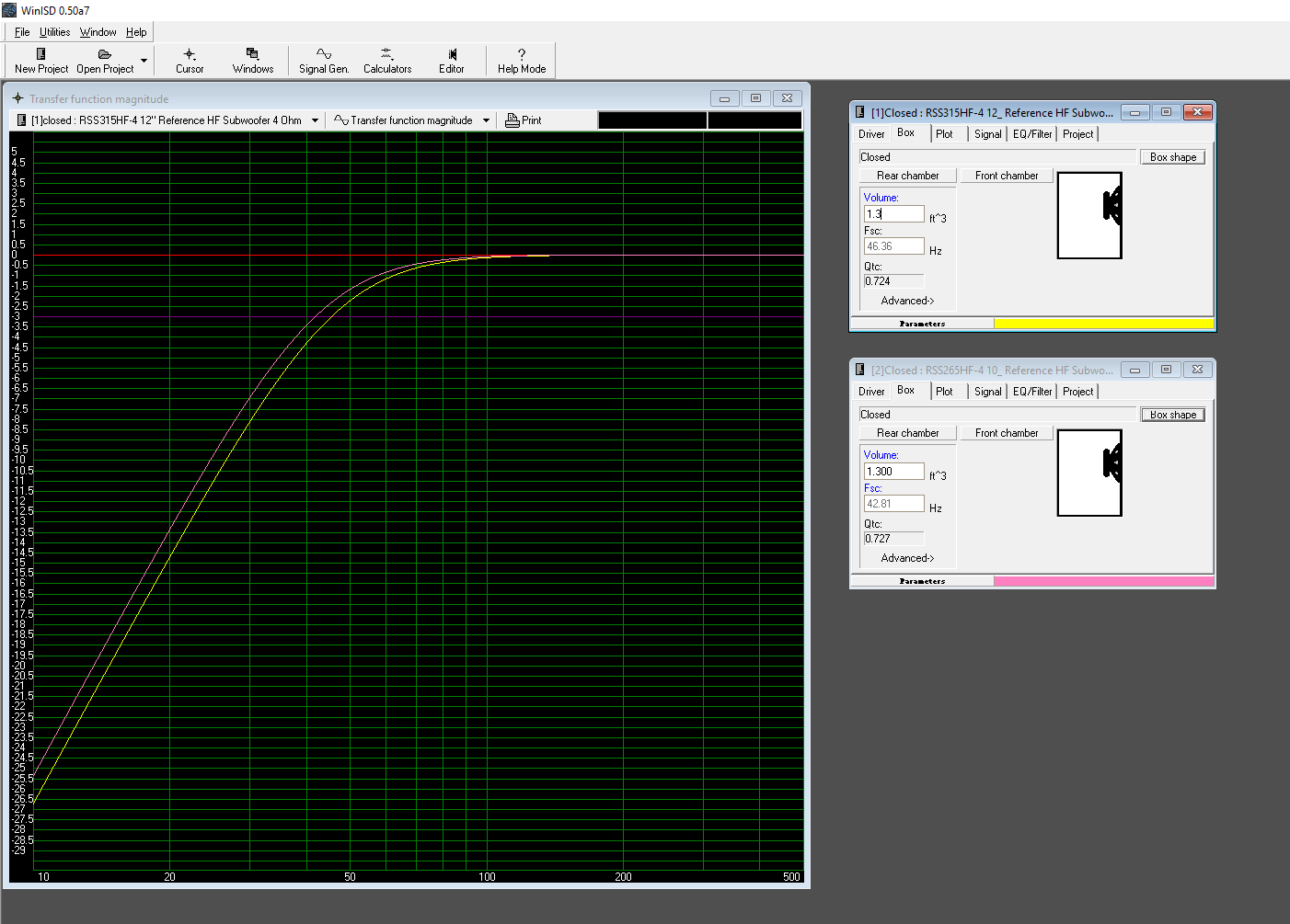

Okay so I had a quick look at the 12'' version of the same driver and it is attractive for several reasons. For starters, it is more sensitive at 90.3 dB 2.83V/1m as opposed to 87.8 dB 2.83V/1m in the 10''. Secondly it has an extra 2mm Xmax and last it has a slightly lower Fs.
When I simulate these two drivers next to each other in, both in 1.3 ft^3 boxes (as close to 0.707 Qts as possible for both drivers), the 10'' version shows a better bass response as shown in this picture Capture12v10.PNG. YELLOW -12'', PINK- 10''

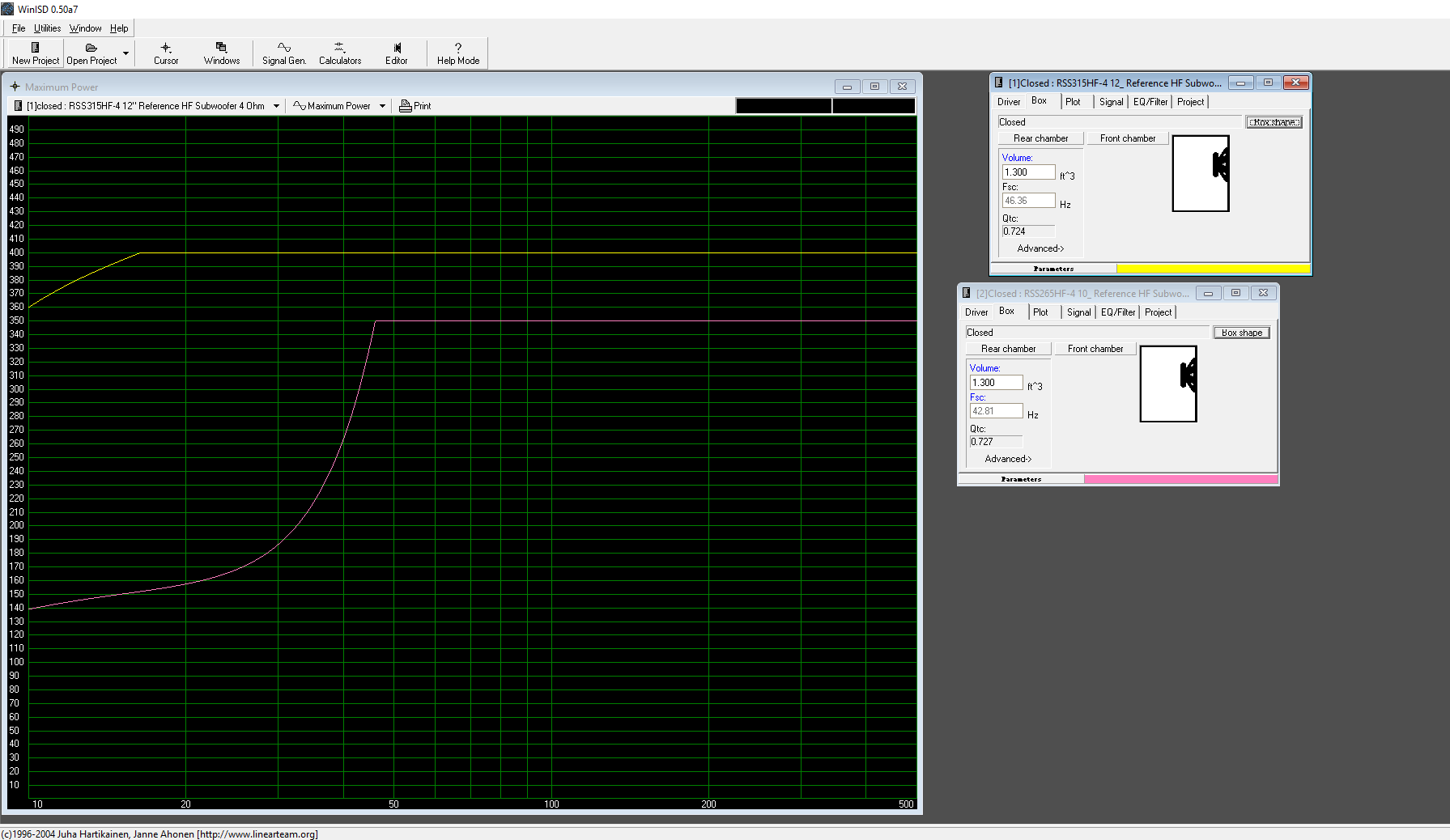

Apart form the bass response, the 12'' seems much better. It doesn't exceed Xmax with even its rated RMS (the 10'' did very easily), Its max SPL is better across all frequencies and its maximum power is far better all over too. Capture12vs10 max power.PNG
Can I eq the 12'' to have a flatter response a low frequencies? I have read a little about the Linkwitz transform and it sounds like it will flatten the response at lower frequencies at the cost of power. Is that right?

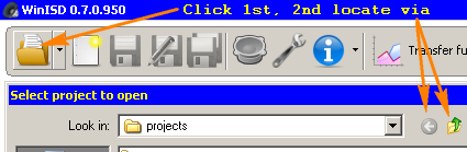

Thanks heaps for the file. I'm having some trouble importing it though. Am i meant to save it in a particular place? I had downloaded WINisd PRO, that why it looked different. Just got the newest version of the standard WINisd. Thanks for pointing that out.

Use the Windows Search for WinISD. Open that folder, then open Projects, then Cut & Paste my file into it. If you havn't already, change the .txt extension to .wpr.
And/or then run WinISD & locate via the arrows, if Projects doesn't show up. Save all your future & existing Projects in Projects. Next time you run WinISD you should see Projects easily.
