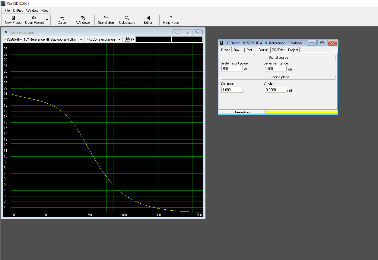

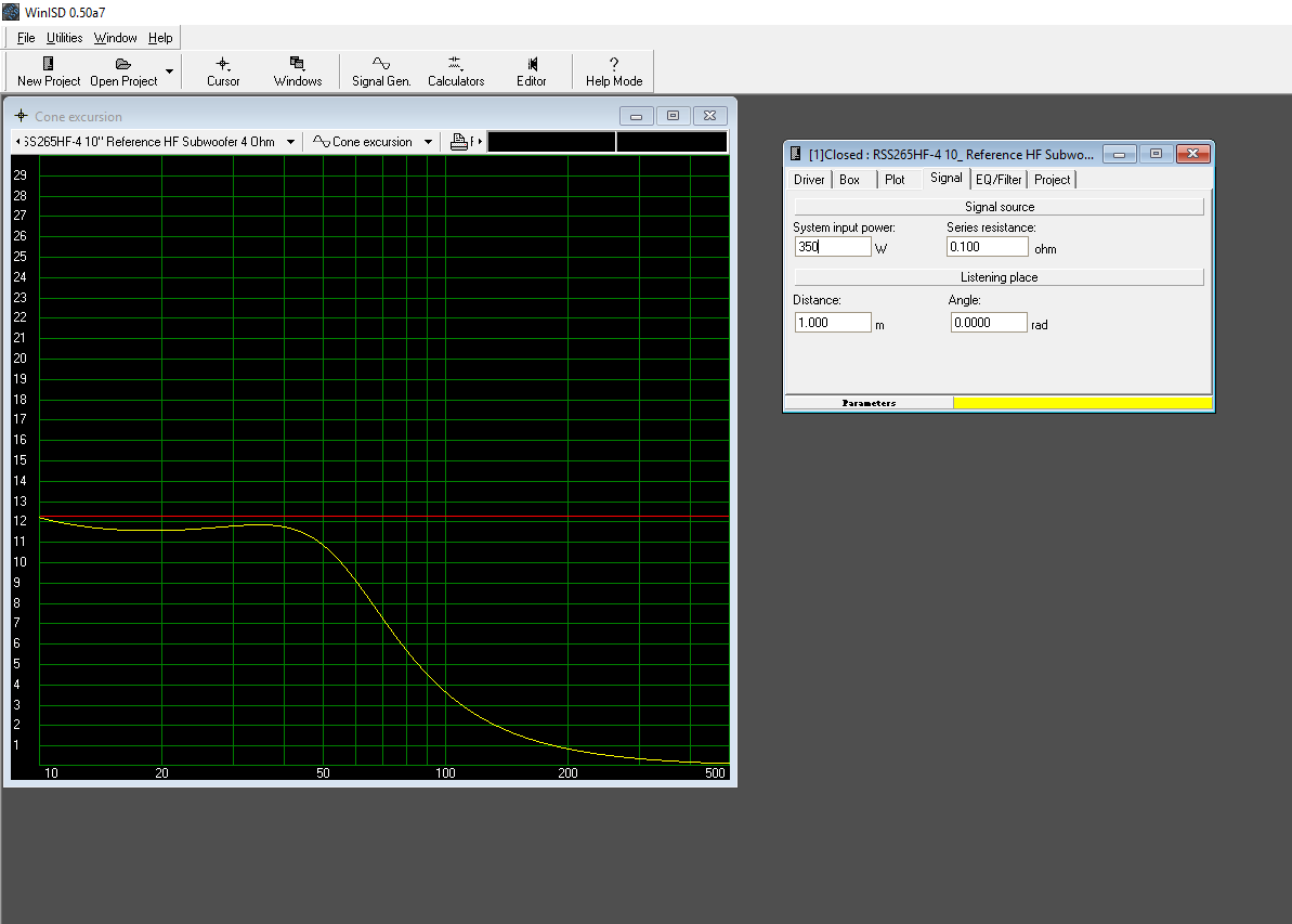

Just looking at sims now and there really isn't much diff between say 1.2 and 1.6 ft^3 in terms of transfer function you're right.
When I do sims for cone excursion with system input power at 350W (the drivers RMS) it easily exceeds the Xmax in a 1.5 ft^3 box. Isn't this something I should be concerned about? Ill probably very rarely supply that much power to it but even at 150W in a 1.5 ft^3 box the cone excursion reaches xmax on the lower frequencies. Ill attach some screenshots.
1.5 ft^3 at 350W
1.5 ft^3 at 150W
0.6 ft^3 at 350W
What other sims should I do and what should I look for in the graphs?
Thanks!!
