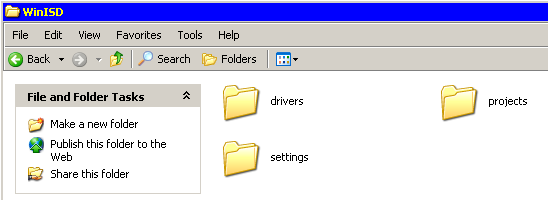

@ Myleso
Use the Windows Search for WinISD. Open that folder, then open Projects, then Cut & Paste my file into it. If you havn't already, change the .txt extension to .wpr.
And/or then run WinISD & locate via the arrows, if Projects doesn't show up. Save all your future & existing Projects in Projects. Next time you run WinISD you should see Projects easily.
Im sorry but the projects folder just doesn't exist for me. I have the updated version and everything :/ Thanks so much for your effort but I think I am just going with the 2 Cubic ft sealed enclosure fir the Dayton 12'' HF Reference subwoofer.

@ Myleso
My Computer/LOCAL DISK (C)/Documents and Settings/User Name/My Documents/WinISD
Maybe the reason it doesn't exist, is because you haven't created a project yet with the latest version ? If you had you would see it, & find it with the search i mentioned.
2 things to try.
1 - Create a new Project, anything at all, Save it & see if a Projects folder is made.
2 - Just make a new folder in the WinISD program folder called projects. Paste my file in there & run WinISD & you should be able to use it.

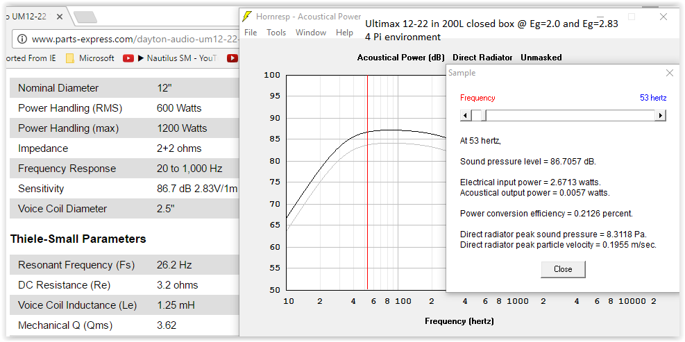

Post #81: "...efficiency is expressed in terms of acoustic output verses voltage input, via a percentage..."
I'm sure that's just a typo, but, efficiency is output power divided by input power, and if you want it in percent you multiply by 100.
Efficiency and sensitivity conversion - loudspeaker percent and dB per watt and meter loudspeaker efficiency versus sensitivity vs speaker sensitivity 1 watt = 2,83 volt box chart - sengpielaudio Sengpiel Berlin

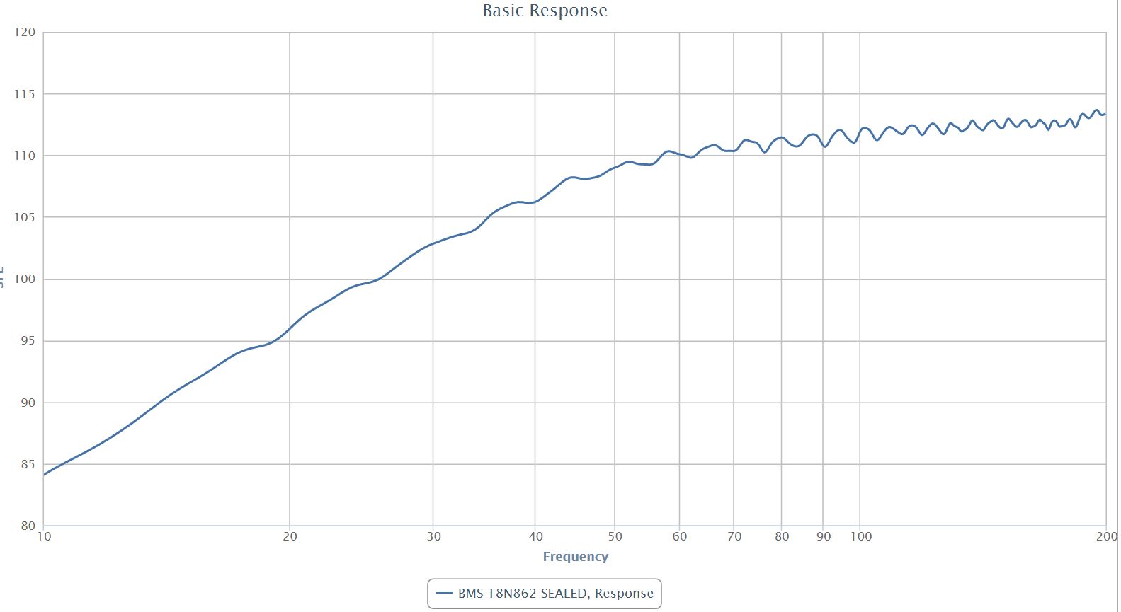

A simulator can answer the basic question about the "margin of error" pretty easily. As long as you don't go too small the margin is very wide. Often the recommended sealed volume leans already towards the minimum (If you simulate w/ this volume you see a straight line low end slope followed by a bit of a hump.).

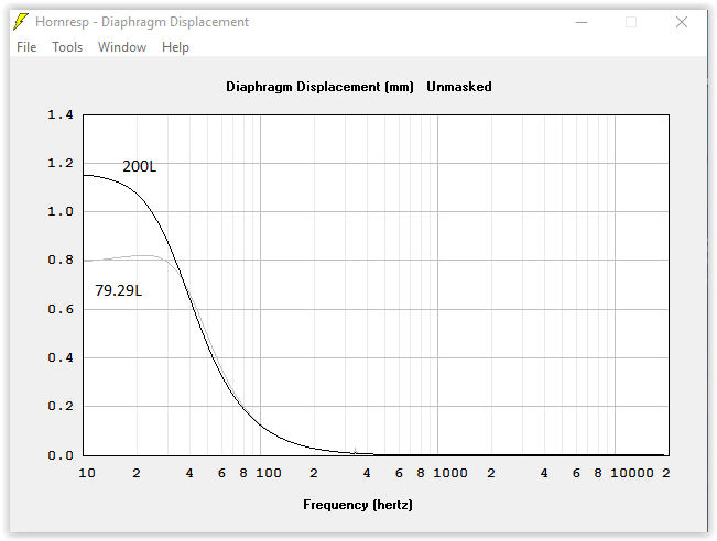

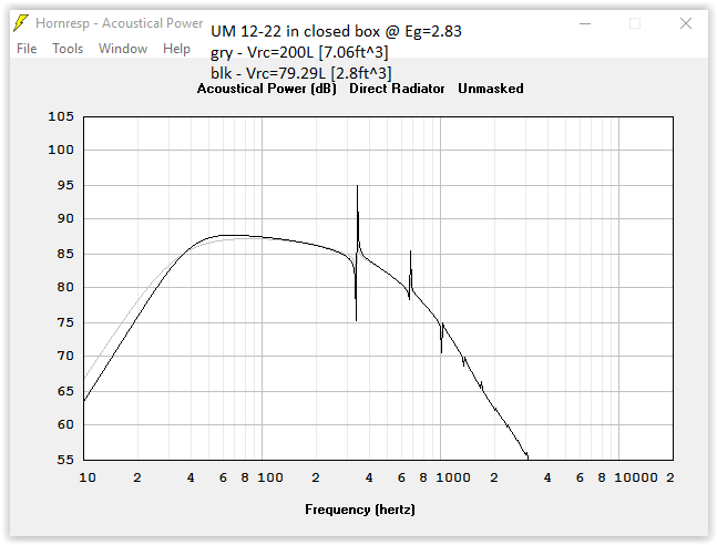

Attached, find a Hornresp simulation of the Ultimax UM 12-22 in a closed box.

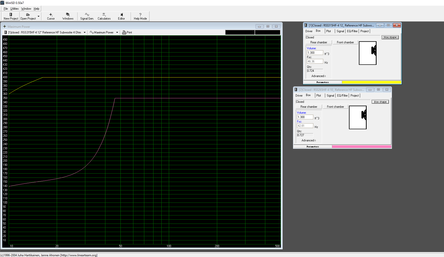

@Myleso -
I don't think anyone responded to this post!
You are on the right track now.
Keep playing around in WinISD and you will find some combination
that will be perfect for your needs.
Bring up the "Cone Excursion" screen at the top, then choose "Filter" on
the lower left -put in a High Pass Filter at 20Hz.
See how that really helps excursion problems?
Oh, BTW, if a driver has an xmax of, say 12mm, it's totally ok in modeling to add 10-15% to that, so you are modeling then with an xmax of 13.8mm.
If you still have excursion to "spare", then you can add another filter, a "Parametric" filter at 30 Hz and add 2 dB of boost at that frequency.
In this manner you can precisely tune a sub to your needs.
Hope this helps!

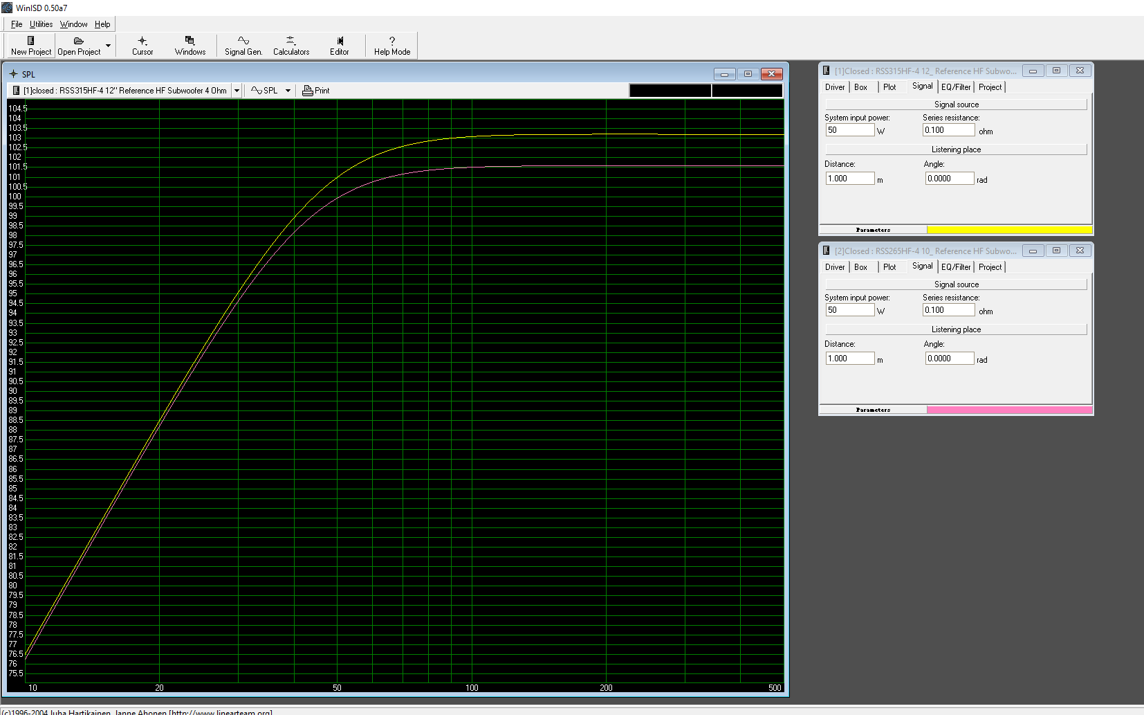

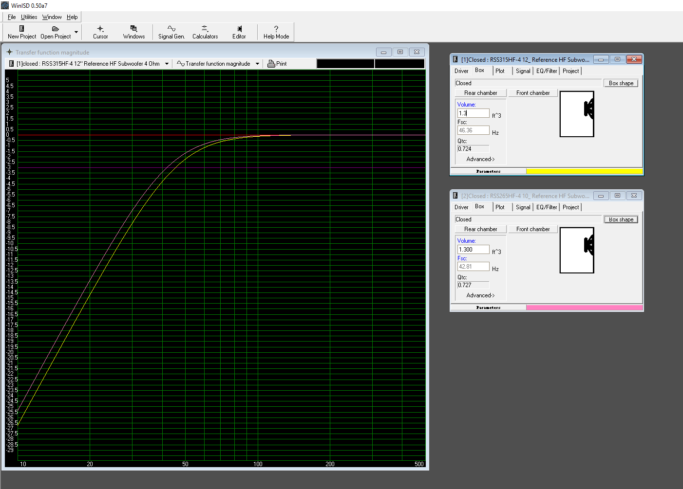

Okay so I had a quick look at the 12'' version of the same driver and it is attractive for several reasons. For starters, it is more sensitive at 90.3 dB 2.83V/1m as opposed to 87.8 dB 2.83V/1m in the 10''. Secondly it has an extra 2mm Xmax and last it has a slightly lower Fs.
When I simulate these two drivers next to each other in, both in 1.3 ft^3 boxes (as close to 0.707 Qts as possible for both drivers), the 10'' version shows a better bass response as shown in this picture View attachment 597785. YELLOW -12'', PINK- 10''
Apart form the bass response, the 12'' seems much better. It doesn't exceed Xmax with even its rated RMS (the 10'' did very easily), Its max SPL is better across all frequencies and its maximum power is far better all over too. View attachment 597786
Can I eq the 12'' to have a flatter response a low frequencies? I have read a little about the Linkwitz transform and it sounds like it will flatten the response at lower frequencies at the cost of power. Is that right?
here is each drivers SPL through the frequency spectrum at 50W input.View attachment 597787

Hi all,
Interesting thread, ...very relevant to my first attempt at DIY... an attempt where I haven't just copied others' posted designs, and finally take the time to learn some design software including HR 😱
Ok...I'm starting out slow....I've chosen an 18" that appears to be suitable for either sealed or vented....and well, I am still kind of copying again... the 18" is the BMS 18N862 that Josh Ricci's most excellent data-bass reviewed, both sealed and vented.
So to learn, I'm currently building both a sealed and vented box with this same driver....
Where I'm getting confused in this thread, is about what does the air spring actually do.
One view put forth is that "The only thing the air spring does is prevent overexcursion (assuming the amp is sized appropriately)."
I get that a smaller box helps prevent over excursion, but doesn't a box's volume also effect transient response and help control freq response ripple? At least that's what Eminence designer and other literature I've read says....
I'm planning on building my sealed box for 'maximally flat', Qtc=.707
I see the 4 cu ft box used on data-bass's sealed 18N862 is a little larger than than maximally flat with a Qtc of about .64
here's a snip of it's response from data-bass....
Does volume have an effect on the ripple displayed?
If not what does?
Thx, Mark
If not what does?
Thx, Mark
It's a mechanical damper, it provides resistance. Added resistance is always a loss. This is why more power is required to reach excursion limits in a small sealed box.
Is a mechanical damper necessary? Some people seem to think so, I think not. Not when you have electrical limiters available and when common sense limiting is as easy as turning down the volume knob when it sounds bad.
There's something else a stiff air spring does too, something most people probably have not considered. It increases distortion. Since air does not compress and expand in exactly the same way you get extra distortion with every cycle. How much extra distortion you get depends on how big the box is in relation to how much air is being moved. A very small sealed box with a very large driver moving at huge excursion is the worst case.
A quick sim will answer the rest of your questions. There shouldn't be much ripple at all in a sealed box of reasonable dimensions. The pic you included shows a normal amount of ripple, this is normal, all measurement are a bit wiggly and it won't go away if you put the driver in a larger box. The ripple in the response that is controllable is a larger, often wider sort of ripple that is causes by resonances and/or diffraction. Resonances can come from different causes but in a sealed box the only resonance is related to the box dimensions and is going to be pretty mild if the box is sealed. Nothing to worry about unless your box dimensions are pretty unusual.
