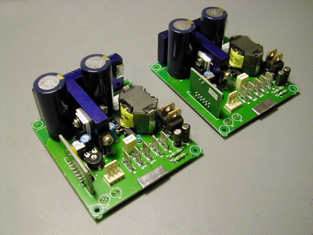

Hi Jan-Peter and Bruno,
I'm still a little confused about the coupling cap between the op-amp and modulator.
Could you please indicate which one it is.
I'm looking at some pictures of my UcD400AD modules and I'm inclined to guess it is the lonely small black elctrolytic cap between the "daughter card" and blue heat transfer "T". Or is the coupling cap surfaced mounted under the board?
I've made a red circle around the cap I think is the coupling cap in the attached photo.
If my module input has no DC going to it, is it safe to bypass this cap as well?
Thanks.

Since you're addressing both of us I still owe you an answer 😀Julien_M said:Hi Jan-Peter and Bruno,
Thanks.
There are only 2 coupling caps on the modules. On one generation they're before the op amp, on the new generation they're after the op amp. You've already removed all coupling caps there are on your module.
The cap that you've encircled is the bootstrap capacitor. The module will not work very well without it

Thank you both for the prompt reply. Now everything make sense.
As you might have noticed from my pictures I also replaced the main supply caps and the low voltage decoupling caps with Panasonic FC caps. That brought a big change in sound, I feel the caps are still breaking in so I haven't commented on the sound yet, but the overall presentation is smoother and more natural. More tube like...
Bruno, is the quality of the bootstrap capacitor critical to the sound? Do you think it could be improved upon?
Not very. The difference is noticeable but slight.Julien_M said:Bruno, is the quality of the bootstrap capacitor critical to the sound?
