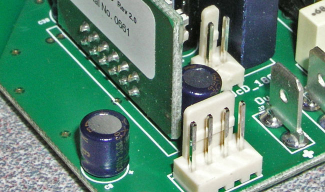

sx881663 said:
You may be able to jumper out the original 22uf caps in the 180 but watch the output DC. I would say if it is over .1 volt you will have to do something about it, like replace the opamp with one that has lower offset and bias current. After you jumper them out you can use rather modest size coupling caps between the modules input and the input jack. Most have settled on 2.2uf @ 200V for the best all around performance and safety.
If using input caps from the RCA’s put a 100k ohm metal film resistor across the RCA jack to insure any stored charge is dissipated.
Why is original cap 22uF if 10x smaller value is ok?
How can FR low limit calculated when using different sized caps?
What would be good size of the input caps in my Orions tweeter amp (>1440Hz ), and midrange amp (>100Hz)?
PS. I think i am using AudynCap polypropylenes what i have in hand many diffent sizes.
PS2. I have ordered 4pcs. 10.000uF 63V Aerovox T-Power 4 pole capacitors to my UCD180 dual mono power supply. Interesting to hear what will be diffence compared to current Rifa PEH200 sound.

Pasi,
The original UcD180 had the coupling caps on the output of the opamps going into a rather low impedance. This required a larger cap keep the lower frequency limit reasonable. The new circuits have the coupling caps on the input going into 100k ohm resistors. With this value a 2uf cap will give a 3db point around 2 Hz. Certainly this is low enough for anyone. I suspect the 22uf caps were just a carry over and do no harm being large.
Check out the link below to learn about coupling caps and how to do the calculations yourself. You will have to know the input resistance of your amps to do this.
I will have to look into the 4 pole caps you mentioned, look interesting.
Roger
http://www.st-andrews.ac.uk/~www_pa/Scots_Guide/experiment/highpass/hpf.html

Ofcource, i tend to forgot basic thinks..
But why we need these 100k external resistors, input impedance of UCD is 100k allready?
I also wonder why Bruno has put input cap after opamp, if cap before can be smaller (better quality when same price).

I've done this on the UcD180 module:
- BB 2134 in place of the original OP
- a KK connector in place of the blue LED (to go to front)
- 47UF BG NX-HiQ for coupling caps
Pasi P,
The original opamps were the 5532's and had enough DC offset to be a problem. Using caps after them took care of this. Later when the opamps were upgraded offset was not an issue and the output caps were no longer needed. Input DC protection is still necessary so the input coupling cap requirement still exists.
Roger
