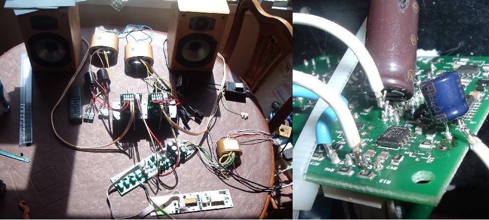

so Ive got my UCD180st's on the test bed and they sound great oh yes they do! Ive bypassed the input opamp for low level listening and im using a cs3310 (waiting on pga2320's) heres a pic of it working (not that you can hear it on the pic... get the pic)
the R-cores were made to order by Arrow technology (not cheap!) 240v primary, 34v pair secondary 200va, except the small one running the pre-amp that came from diyclub.biz.
and the diodes are HFA08PB60PBF (hexfred 18ns soft recovery) with DNM TNC resevoir caps.
sorry for the delay! the children are needy!!
im using the unbalanced version as all of my sources are unbalanced anyway, the transformer is 9-0, 9-0, 9-0, 9-0-9, (1.2a each) giving 11.5v dc rails which is adequate for most users, the pre ive modified as it had a 317 feeding a 7805 (9v pre and 5v sec) so ive removed the 7805 and now planted a pga2320 - 9v should give 3.5-4vrms handling (18-2/4) which should be adequate for my dv89's HDCD output at 4vrms, anyways I have no buffer at the moment the preamp is hooked directly to the modulator of the ucd's coupled with a pair of capacitors to block the dc (measures 250mv without! and zero with) to be honest it sounds awsome, the seperation is great and it drives any old crappy speakers as if they were logans or something! but not very loud without a buffer, I am thinking of adding a lm4562 to the spare 9-0-9 winding but I need a decent circuit and regulator and have to read some forums, ive had good results using shunt regulators but ive only copied designs for 5v rails.
