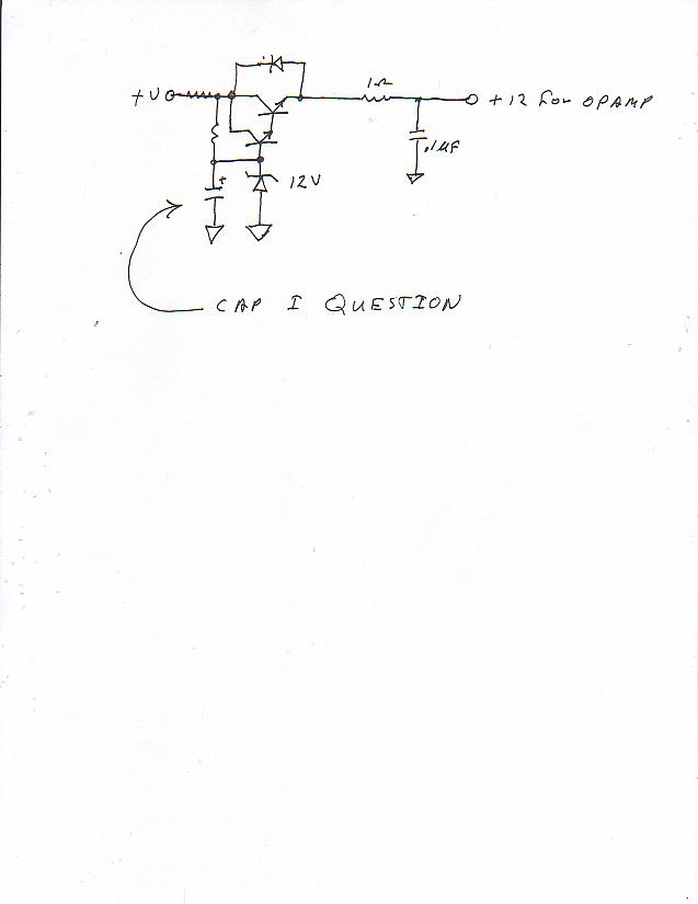

bootstrap cap
Bruno,
The bootstrap cap sees only low voltage right? Possibility an Oscon would work very well here. See any problems with going to something with this low of ESR? I know, not a trivial question as peak currents could be much higher.

Re: bootstrap cap
There is nothing against oscon here. 220u/16V should do nicely. This part of the circuit is not extremely picky about esr, in neither direction.sx881663 said:Bruno,

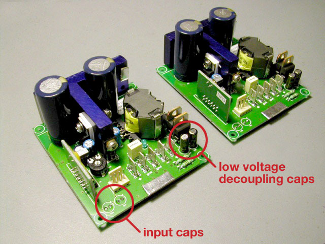

Julien,
Which one is the low voltage decoupling caps?
And when you remove the C23, c24, do you just short them after the removal?
ackcheng said:Julien,
I've attached a photo showing the low voltage decoupling caps in my module. I don't have it in view to give you the capacitor numbers in the PCB.
The input caps were replaced with a small piece of wire. But you can just shorten them if you don't wish to remove them.

I used Panasonic FC 22uF/50V. I'm not 100% sure about the value, the value I used is the same as the original caps.
The supply caps I used in the modules were also Panasonic FC 680uF/100V.
The sonic improvements from doing these simple mods (including the input caps bypass) are astonishing. Yesterday night I listened to parts of Brahm's German Requiem, and later to Bomtempo's Requiem, and the rendition of the voices and strings was breathtaking. Of course, the rest of the system contributes to the sonic presentation, but the amp has a lot to do with it.
I've been also playing with ferrites both at the input and output of the modules. My conclusions so far are: Absolutely no ferrites at the output (speaker cables). The sound becomes "thin" and "brittle", it looses body. At the input the results are not so obvious. I think I prefer without ferrites. But I still have to do more listening tests to be absolutely certain about my choice.

I have posted a crude drawing of approximately what the circuit is you are dealing with. I traced all this out but can’t find my notes so it is a best guess based on memory. Only the + circuit is shown and the - is a mirror image of it with all polarities reversed.
Looks to be the perfect spot for an Oscon or similar cap with very low ESR. I would even consider adding a .1uf surface mount on the bottom directly across the leads.
