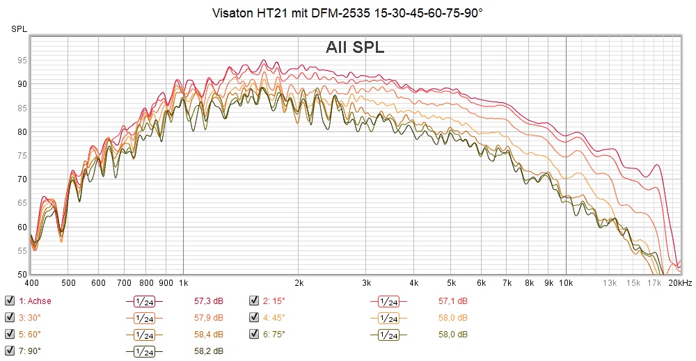

My personal favorit ist the Visaton HT-21. I use it with Peerlees DFm2535. On first view, it looks like the RCF H100-typs and copys. But is shows a better directivity towords the highs. Goes down to 1.5kHz - maybe a little deeper with 44mm driver. Probably a little small for your purpous ?

I am looking for a horn to cross to a 10" with my Peerless DFM2535. I thought I had seen them all but thanks for pointing this horn out.
Have you got any measurements of it? I would be particularly interested in polar measurements if you have them, please?

Hi
this is my measurement Visation HT21 with DFM-2535
Distanz: 1m, free without enclosure
15°-steps
It will play together with a Monacor SPA110PA crossed around 1600-1700Hz.
Hope that help.

The Visaton HT21 looks remarkably similar to the Beyma TD194/TD164, both are cast aluminium but the HT21 seems to be slightly smaller.
The Visaton costs nearly twice as much as the Beyma though.
If you buy two the Beyma is almost exactly half price of the Visaton ie one HT21 costs £78.37 and if you buy two Beyma TD194 they cost £38.66 each.
