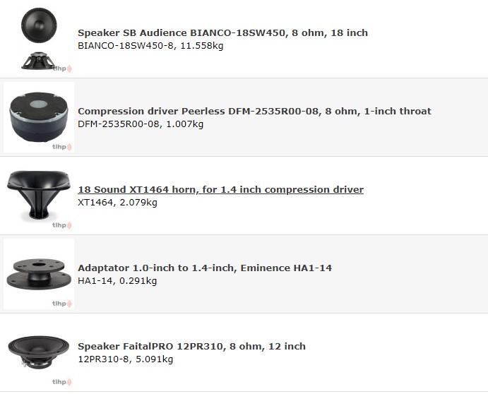

Any specific adapter?
That should have been the Eminence HA114.
It's not a diffraction device. I've been using both the original JBL and the Daytons for a decade.The JBL clone is available from this dealer, its 90x60 degree, it has been used for an xo-point of 1.25 khz, sounds supposedly quite well but shows some rather vivid FR due to its nature as a diffraction device.
Exactly!
Would you like to build something with this combination? The 12-inch midrange could be almost too small. Unless you want to set the X-Over point over 1kHz.
Active or passive X-Over?
Active, except for some basic protection and padding for the CD.
Was thinking 1-1.2kHz, through earlier listening tests I've discovered that very steep filters might not be the best solution, and with 12, 18 or 24db/oct filters a smooth driver response is crucial to produce good results.
It can be hard to find a good combination that has a smooth overall response, and I value cost efficient performance rather highly.
Currently evaluating options for my next build, not sure where the hobby will take me this time, but it is almost certain that it will be another 3way one way or the other.
