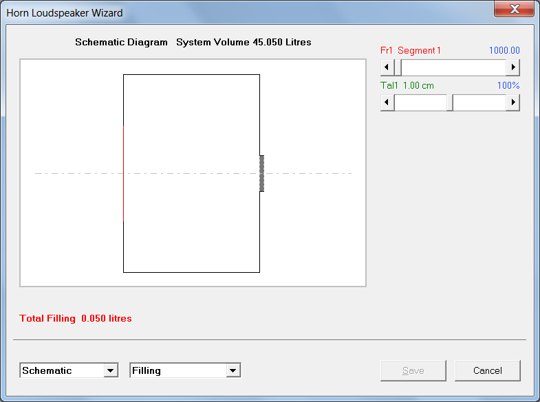

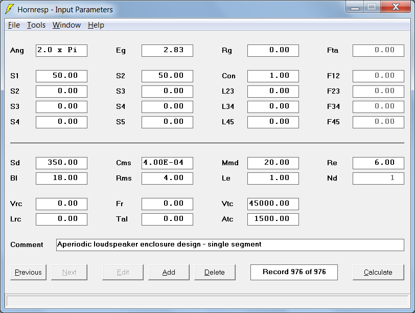

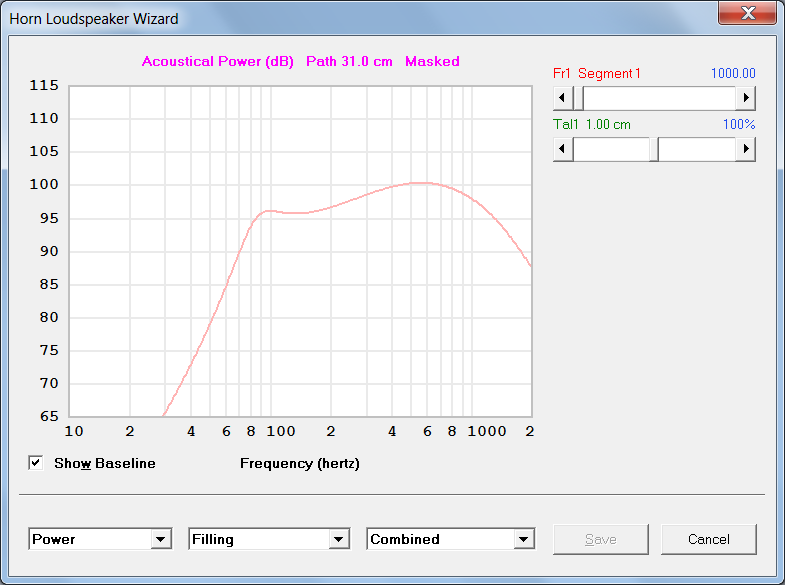

Specify two stepped segments as shown in Attachment 1.
The advantage of using two segments is that absorbent filling material can be included in the enclosure, if required.

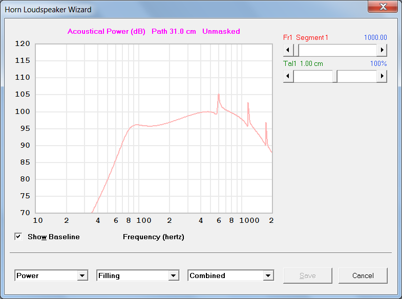

The design can however also be specified using a throat chamber and single segment as shown in Attachment 1. The advantage of this method is that enclosure resonances can be masked as shown in Attachment 4.

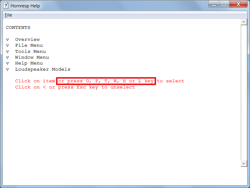

Perfection as usual. You seem to have the hang of this fast-debugging business 🙂

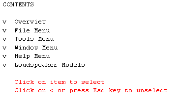

Sooooo, while I'm here, how much trouble might it be to put a keyboard shortcut on the 6 main help categories? I like the old help better, but I can understand I'm in the minority. I know, I know--wasting genius on "UI stuff" -- just still old and still hate mice and still lazy. Best to you and thanks again, David!
It can be a bit tricky though, coming up with a Wine workaround when it is not clear what part of the VB source code is causing the problem. 🙂
The feature will be added in the next update.

CHANGE 1
Items in the Help contents list can now be selected by either clicking on the item or by pressing a keyboard shortcut. The keyboard shortcut feature was requested by grindstone in Post #15,244.

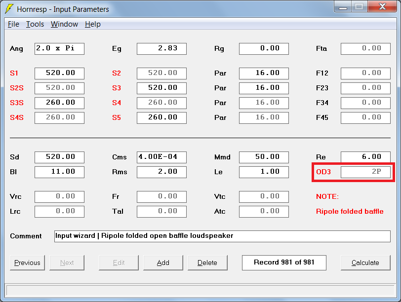

A workaround has been put in place to hopefully address the non-Windows incompatibility issue reported in Post #15,248.
rertrobaer,
Does the Input Wizard now show 2P rather than 2p when an OD3 Ripole folded baffle template is generated?

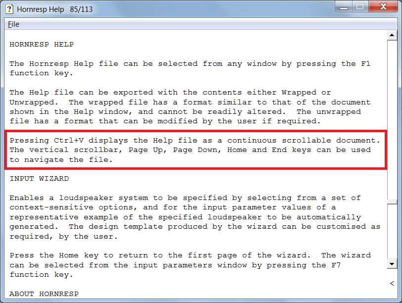

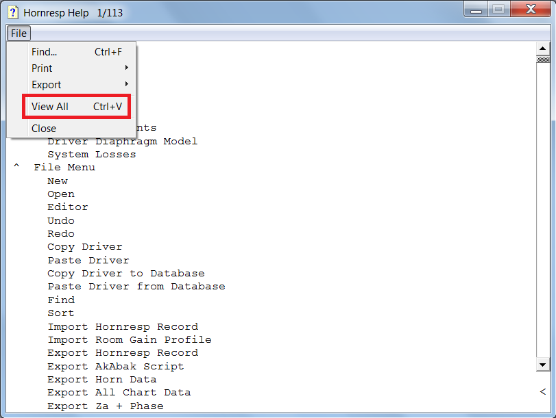

CHANGE 3
Pressing the Ctrl+V keys when using Help now displays the file as a continuous scrollable document. The vertical scrollbar, Page Up, Page Down, Home and End keys can be used to navigate the file. Post #15,250 refers.
