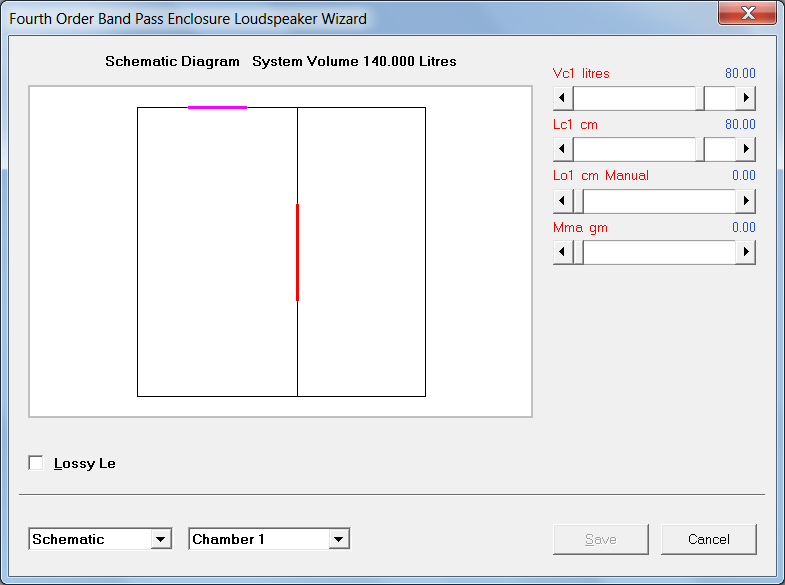

By chance Is there a way to create a 4th order BP with a passive radiator instead of a vent?
See the Fourth Order Band Pass Enclosure section in the Help file for details.

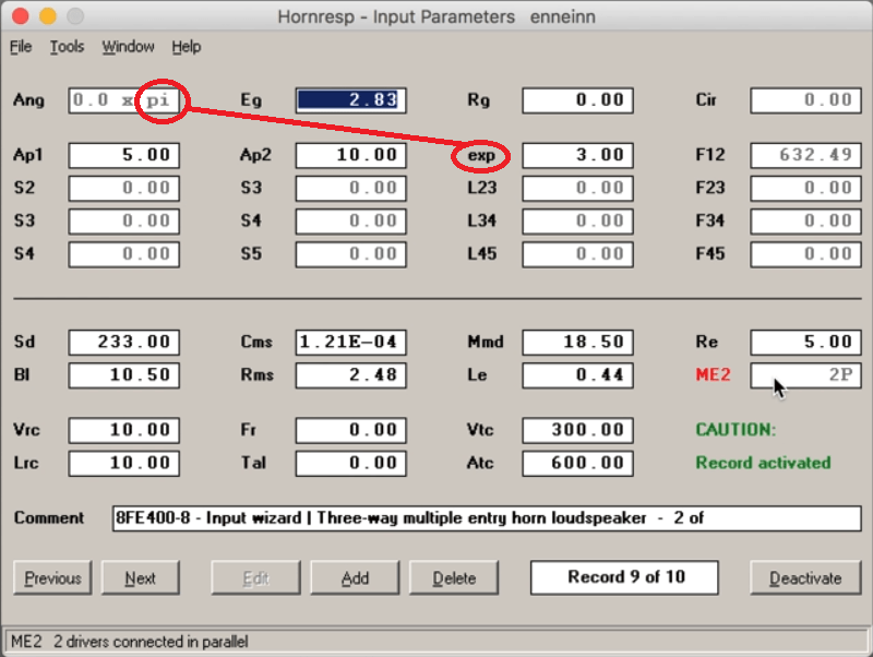

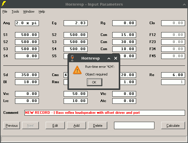

Probably related, i'm using HR via wine on linux. When i use the input wizard, the angle shows a lower case "pi":
When changing it via clicking on it, it's upper case again:

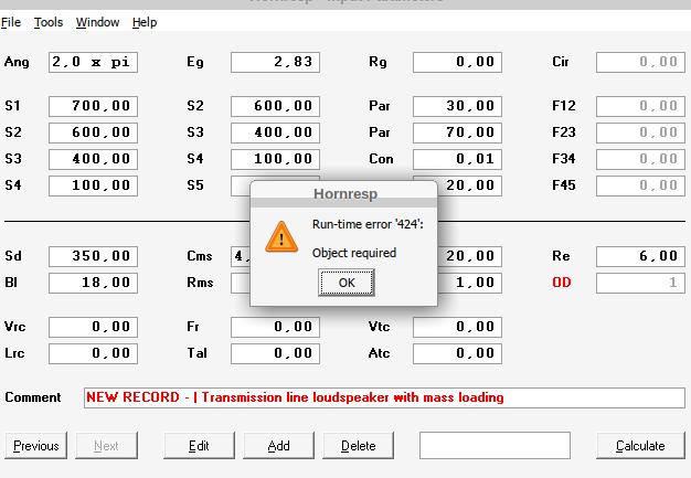

It is definitely related - see the image below.
I noticed the lowercase e in Exp but completely missed seeing the lowercase p in Pi. Hopefully it should be possible to work around the problem the same way as was done for exp. I will have a look when I get a chance.

Confirmed blow-up right at Continue button (after all selections are made) & lowercase (and I bet my Wine 5.0 is considerably older than @retrobaer's).
The good news is that the record stays created in the .dat file so I'm completely good with it as is 🙂 Thanks again for the amazing tool and all the hard work, David!

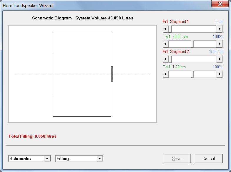

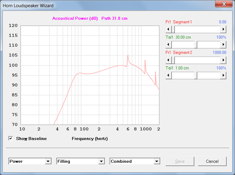

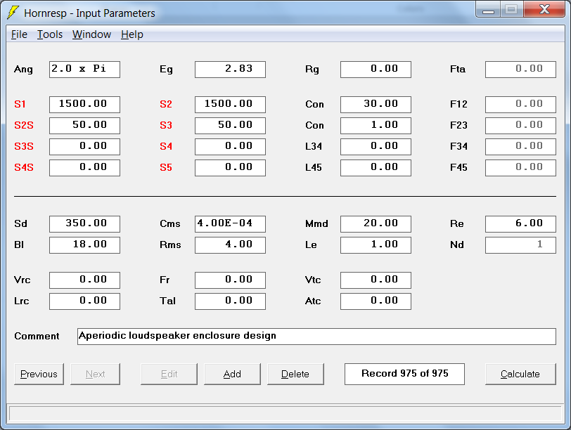

Is it possible to make a simulations for this type of enclosure:
Hi Roman,
Specify two stepped segments as shown in Attachment 1. Segment 1 represents the enclosure and the segment 2 represents the damped port. Use the Loudspeaker Wizard to add absorbent filling material to segment 2 as shown in Attachment 2.
Kind regards,
David
