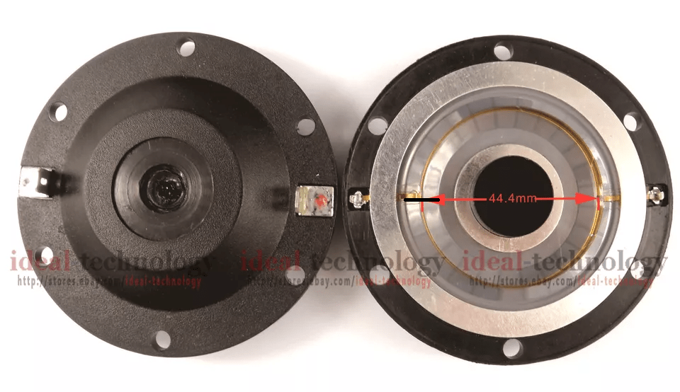

I see the voice coil is 1.75" or 44.4 mm, so I guess that's the area for Sd (15.52 cm2).
As can be seen from the image below, the diaphragm is an annular ring with the voice coil on the centre line.
Given that the voice coil diameter is 44.4 mm, the width of the ring is calculated as 9 mm (found by scaling the black line on the photo).
Ring inner radius R1 = 2.22 - 0.45 = 1.77 cm
Ring outer radius R2 = 2.22 + 0.45 = 2.67 cm
Sd = Pi * (R2 ^ 2 - R1 ^ 2) = Pi * (2.67 ^ 2 - 1.77 ^ 2) = 12.55 cm2

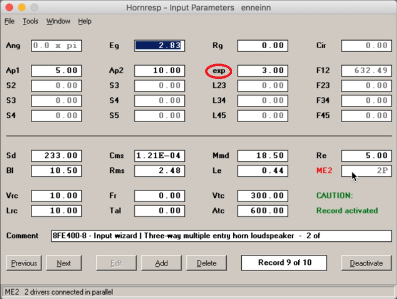

I made a screen capture where I reproduced these steps. Everything is working fine until after I've saved the Multiple Entry Horn Wizard at 01:50. At 02:00 I don't have the option to choose ME1

Notice how in your screenprint below the L12 flare is shown as exp (lower case e) when it should be Exp (upper case E)
Looking at a snippet of the relevant Hornresp source code:
If frmMain.lblHp(6) <> "L12" And frmMain.lblHp(6) <> "Con" And frmMain.lblHp(6) <> "Exp" And frmMain.lblHp(6) <> "Par" And frmMain.lblHp(6) <> "Lp " And frmMain.lblHp(6) <> "Ap1" And frmMain.lblHp(6) <> "PR" Then
cboArrangement.AddItem "Normal Nd"
cboArrangement.ListIndex = 0
Else
In your case frmMain.lblHp(6) = "exp" so that the first statement tests true because frmMain.lblHp(6) <> "Exp", and therefore only "Normal Nd" is included in the dropdown list.
frmMain.lblHp(6) should actually be "Exp" so that the first statement tests false and the Else option is used instead.
I can come up with a work-around to fix the problem, but I am wondering if it is warranted because it is not really a bug in Hornresp...
The work-around would be:
Label6 = UCase(frmMain.lblHp(6))
If Label6 <> "L12" And Label6 <> "CON" And Label6 <> "EXP" And Label6 <> "PAR" And Label6 <> "LP " And Label6 <> "AP1" And Label6 <> "PR" Then
Thank you so much for looking into this. I'm unsure how to apply the work-around, but my solution so far is to double click "exp" until it changes back to "Exp" with upper case. Now everything works fine.

On thinking about it some more, it would not be enough just to fix the incompatibility issue with the Loudspeaker Configuration tool. If L12 is "exp" rather than "Exp", then the flare type won't be recognised by other parts of the program either. The way around this is to add the following three lines of code to the subprogram that loads the current record:
If lblHp(6) = "con" Then lblHp(6) = "Con"
If lblHp(6) = "exp" Then lblHp(6) = "Exp"
If lblHp(6) = "par" Then lblHp(6) = "Par"
The above change will be made in the next update.

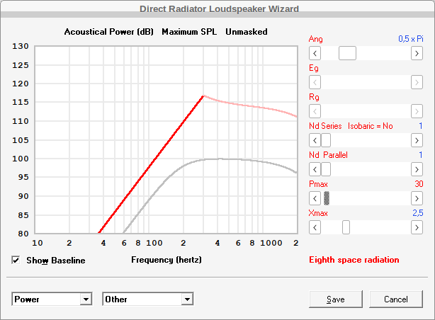

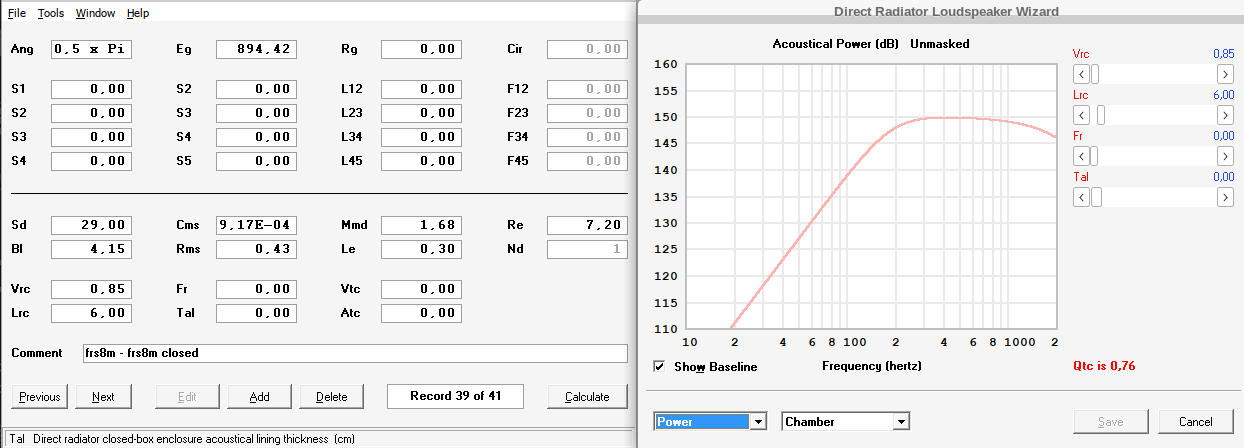

when setting Pmax to high, we get warned by a red line:
When Eg is set to high, we never get a warning:
Might it happen to implement the xmax limit here as well?
To me the Eg setting is of important use, as it reflects the reality of my (solid state)amp and the real limit to where i can go until my speaker might get destroyed.

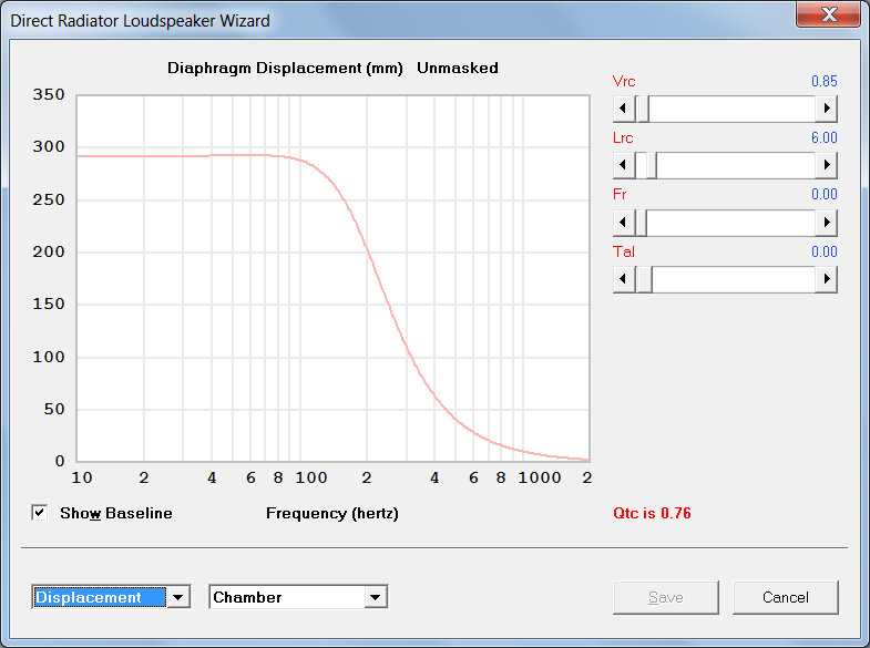

Specifying a constant input voltage is a completely different situation to using the Maximum SPL tool with Pmax and Xmax. It is not practical to give a warning and it is necessary to check the Displacement and Driver Power charts to see if the values are realistic.
For your test example of Eg = 894.42 volts the displacement at 100 Hz is 29 cm and the input power is 62 kilowatts (assuming linear operation).
You can of course select the Displacement and Other options in the Loudspeaker Wizard to see how the diaphragm displacement changes as the Eg slider is adjusted.

Great news! The issue is fixed. I ran the Multiple Entry Horn Wizzard, Exp stays with an uppercase E and I can change the amount of drivers without it forcing me to change Loudspeaker Configuration to Nd. Everything seems to be working perfectly now. Thanks David!
Excellent, many thanks for letting me know. It turns out that it was worth making the change after all 🙂.

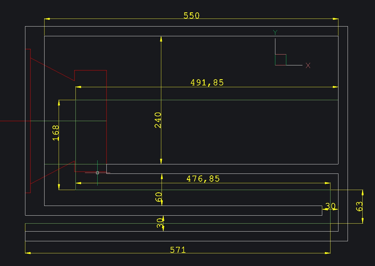

Hello,
I'm trying to design TL for Seas L26ROY as described here.
I've simplified the design as much as I could and got pretty decent results.
I folded the line as shown on image bellow, I've already guestimated some volume for a bracing.
Total volume is as projected (which I think is important, as I take this basically as better predicted bassreflex), internal width is 30 cm.
Is there a way I can precisely predict behaviour for the first bend? Most importantly to adapt the segments for best cancellation of 1st harmonics as it was in original simulation?
I can even move the driver up, so I can move divider between the first two segments.

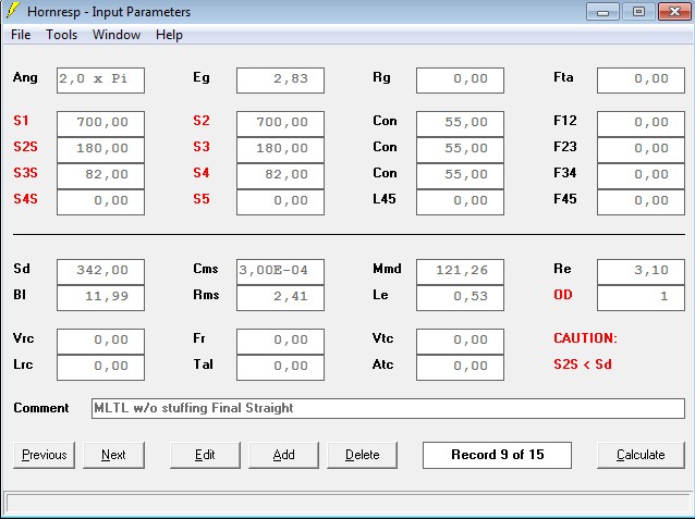

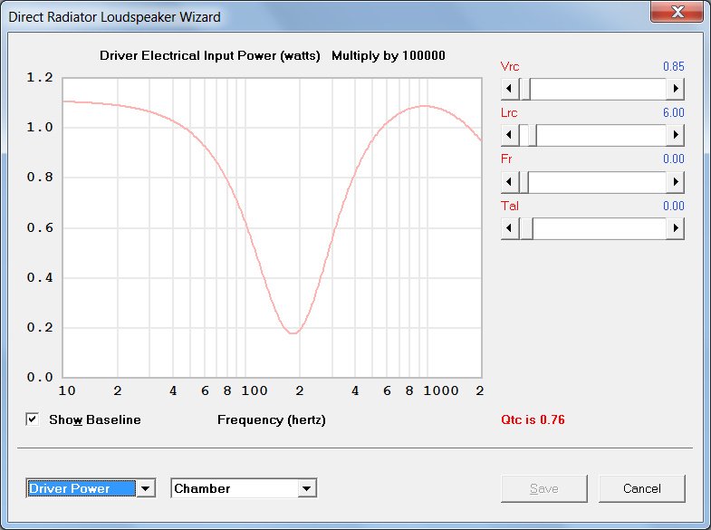

You assumed correctly, everything on the Input Parameters window is used. However the absorbent filling material parameters are not included on that window - they can only be accessed from the Loudspeaker Wizard, as shown in the attachment. (Fr and Tal on the Input Parameters window specify acoustical lining, not absorbent filling material).
No, you simply enter the plane surface cross-sectional area. Hornresp automatically calculates the curved wavefronts as necessary, based on the specified axisymmetric horn geometry.

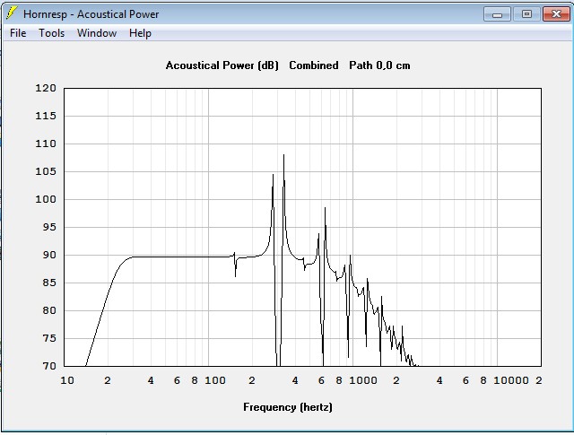

The project you are planning is very much just a bass reflex design with a long port. The port length resonance around 160 Hz for 110 cm length (half wavelength for open tube) will be amplified by the quater wave reflection at half port length bend and cannot easily be attenuated, unless you install some kind of resonator/absorber.best cancellation of 1st harmonics
Just try it out in hornresp.
Another possible solution could be a MLTL with driver and port offset from the line ends. You probably need a smaller port in this case.
