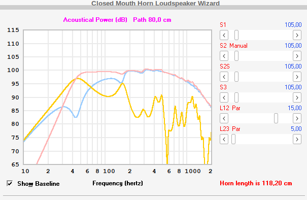

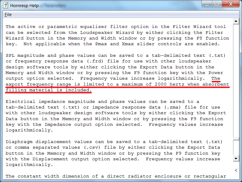

if i add filling to a enclosure(here closed mouth horn), then power output, then F9, i get a .txt-file from 10-2000Hz.
Without filling, i get a .txt with 10-20000Hz.
This also happens with the impedance output exported to .txt.
The absorbent filling material model used in Hornresp is a very good one, but it breaks down mathematically at high frequencies due to numerical overflows and underflows. There is nothing that can be done about this, and it is why the loudspeaker wizard charts and exported data are limited to a maximum frequency of 2000 Hz when absorbent material is specified.

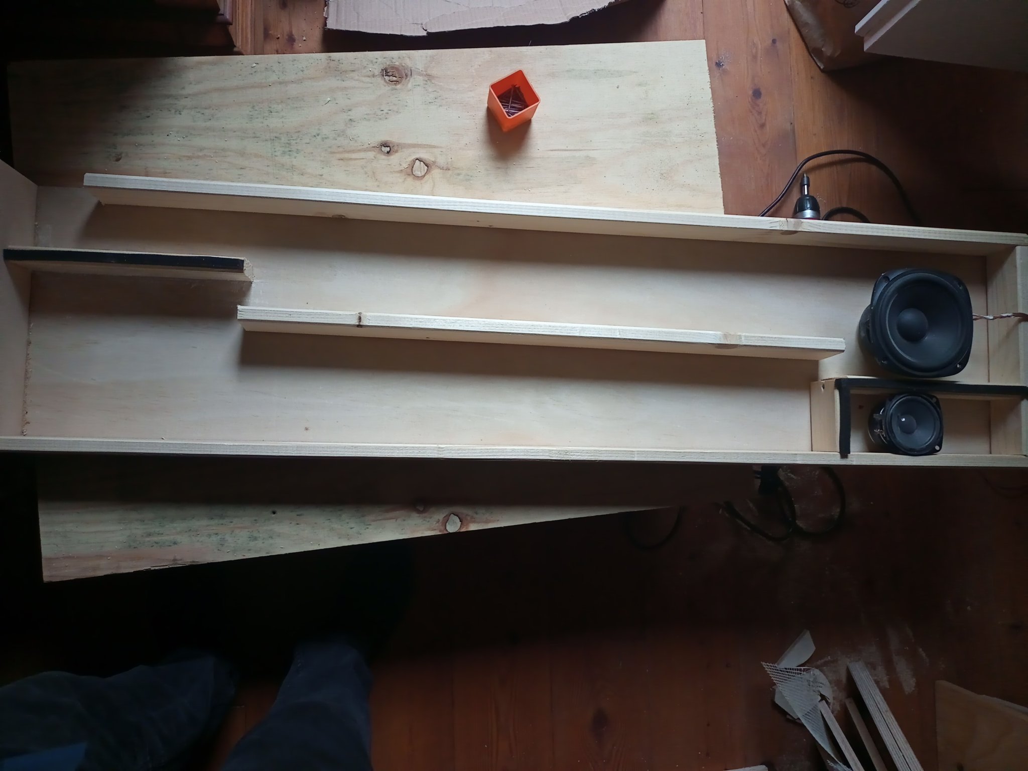

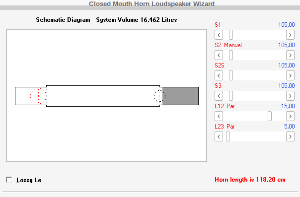

i try to design a BR.
To move the resonances of the enclosure up(over the x-over point) and also to make the enclosure more rigit,
i plan to devide it like this:
Will it behave the same(as simulated) as without the bar in the middle?
Thanks!
Thanks!
Sorry, not sure how to interpret the information you have provided 🤔.
where is your X-over frequency?To move the resonances of the enclosure up(over the x-over point)
It might be difficult to reduce all enclosure dimensions below half-wavelength of x-over frequency, unless it's a subwoofer or a low X-over 3way.
In any case it is more relevant to place the driver and the port away from pressure-peaks (usually in the middle of the enclosure dimensions) to reduce the influence of (wall-to-wall) enclosure resonances.
a good start is making (or even better: simulating) the speaker as MLTL and moving driver and port to have the minimum resonance output.and also to make the enclosure more rigit
also, consider filling the start and end of the TL with damping material, but keeping damping material away from driver and port.

Sorry, my Ascii-picture didn't work with Code-Tags, here is a picture instead. I wonder if the bar in the middle does harm the output, i feel it should be at least shorter.Sorry, not sure how to interpret the information you have provided 🤔.
At about 700Hz.
I did that:
I'm not worried about the resonances that hornresp show, but fear the resonances that hornresp can't know about(sidewalls dimensions are 6x30cm), so i wanted to make(as mentioned in the above post) the dimensions about 2x 6x15cm. By the way, the enclosure is planed to be placed in a corner, and it es as flat as possible(to avoid baffle-step/compensation if that makes sense).

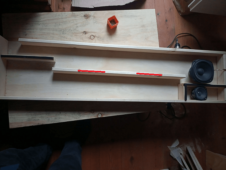

To be on the safe side perhaps it could be replaced by two short pieces, something like as shown by the red lines below.
Basically speaking, air when under pressure will behave like a liquid. I am discerning that the long central piece of wood is to stiffen the enclosure? As David pointed out, perhaps a central hole of an area at least the area of your egress port, if not larger. You may have created unwanted secondary resonant enclosure with the way that you show. An impedance/Phase/SPL all on one graph will show if this is true. You will see bumps in the impedance and phase if it is effecting the output greatly.Sorry, my Ascii-picture didn't work with Code-Tags, here is a picture instead. I wonder if the bar in the middle does harm the output, i feel it should be at least shorter.View attachment 1357827
That is one of the most difficult things from either a horn or TLIt might be difficult to reduce all enclosure dimensions below half-wavelength of x-over frequency, unless it's a subwoofer or a low X-over 3way.
